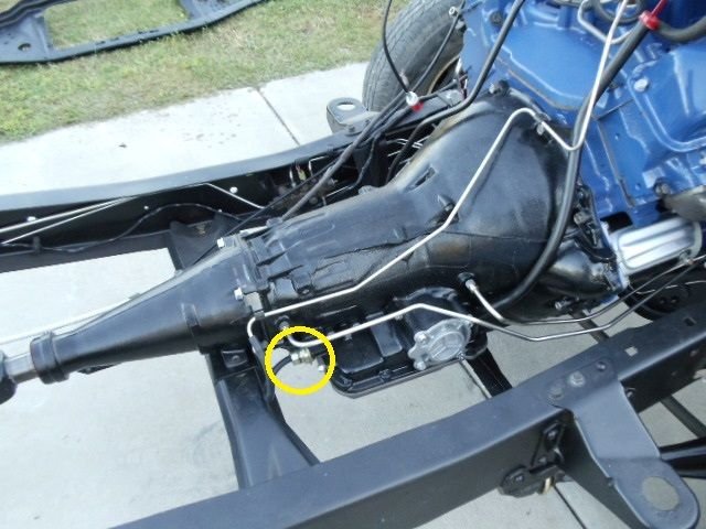

The Transmission Modulator is the item in the yellow circle. See the rubber line connected to it, then it goes up and changes over to steel? That runs up and should change back to rubber and connect to the back of the intake manifold on a vacuum tree.
Check the vacuum modulator and the rubber and steel line that goes to it. Check the line for kinks or other problems, make sure it hasn't come off, or any of the rubber is not dry rotted. If the line checks out, take the line off where it connects to the modulator. If trans fluid leaks out, its bad. If no fluid, it still could be bad.
They're simple to replace, disconnect the vacuum line, remove one bolt that holds the clamp in place and the modulator comes out. It has an o-ring seal. Modulators are identified by the color of the stripe. Pretty much the "go to" one is the black stripe. If they don't show that one in the catalog, go with the green stripe. Avoid the pink stripe. That one is a dual diaphragm version that has two vacuum line going to it. If by chance you have one of these, replace it with one of the other two and use the vacuum line that goes to direct manifold vacuum, cap the other line. When you pull the modulator out, be careful. There is a pin that goes in the modulator. Sometimes it comes out with the modulator, sometimes it stays in the tranny. If it comes out, don't lose it.
FYI the C-6 pan has NO drain plug. Get a BIG drip pan. Because when you drop the pan, it can make quite a mess. So once you get it to break loose, think putty knife, NOT big flat tip screw driver that bends the pan lip. And see if you can get the pan to angle/or drop on one side to drain some fluid. Some times putting longer bolts to hold up one side and let the other side lower to drain helps.
