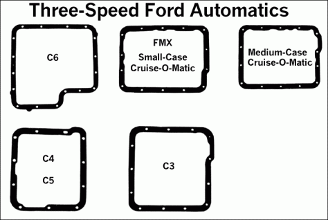

The chart should help shed some light on which trans you have.
If not, you can look up which trans you have by the code on your Warranty Plate in the link below

The pan looks like the C6.
I thought it was the C4 or C6.
