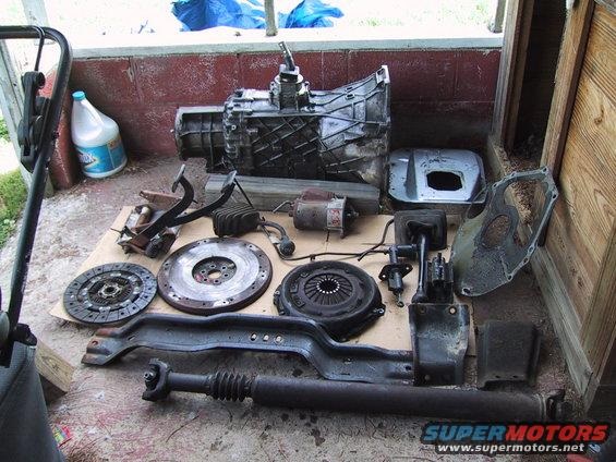

Do search on here, there are plenty of threads. I've done 3 myself. Here is a pic of everything you will need:

Ooph. Well at least now I know what it would take. I mean, I guess I had an idea but seeing the photo brings it home. What did you do about the VSS and PSOM and other electronics?
