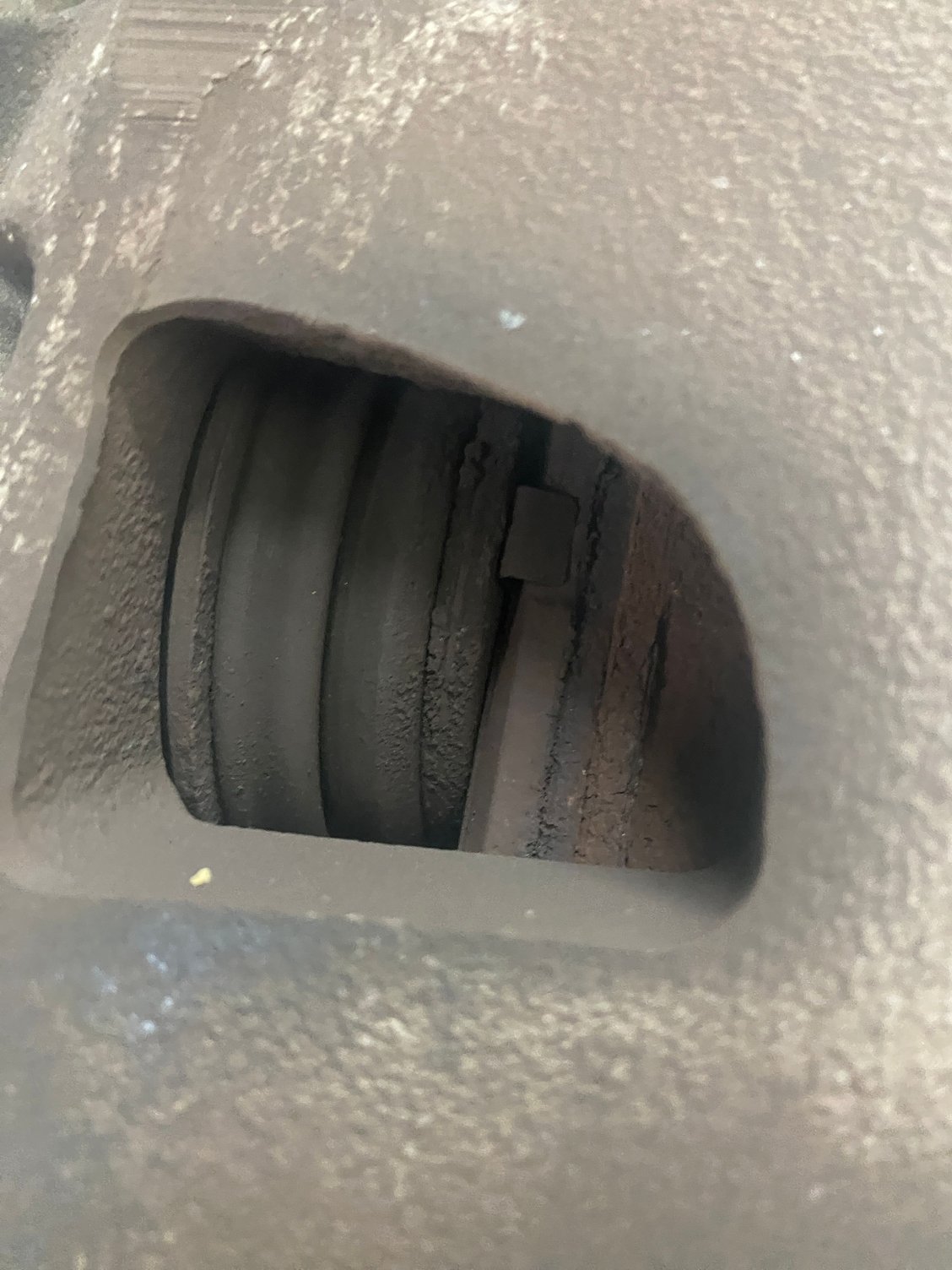

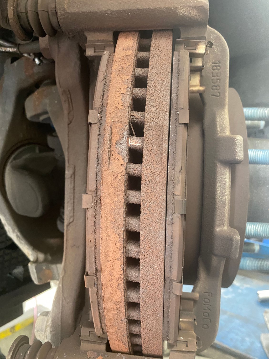

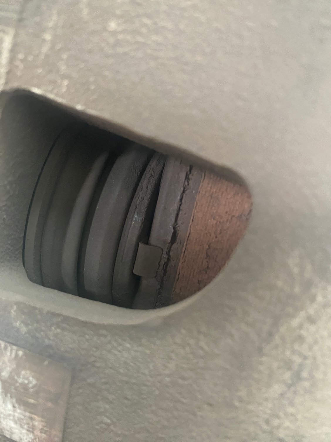

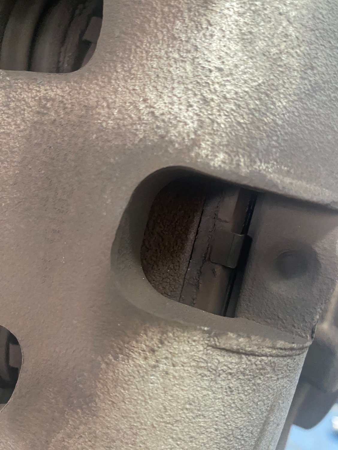

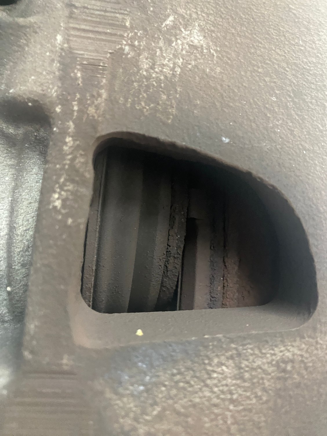

sorry, forgot to upload pics that I took.

Frank, you posted your pictures while I was writing my post.
Your pads look OK. They're not down to the squeal prongs yet. You should get at least another 5,000 miles out of those pads. I base that estimate on how many miles you say are on them now. That's a conservative estimate. Putting an actual micrometer on them is a better way to gauge how much material is left.
The rotors don't look heavily scored and are plenty thick.
If it was me, I would buy a set of pads and plan to put them in in 5,000 miles. Unless you feel a shake in the steering when when braking, the rotors don't need to replaced.

Your fifth and sixth pictures show plenty of pad left. I wouldn't trust their "gauge".
If you don't feel the brakes are working well then by all means replace the pads. I tend to replace my pads well before they get to the squeal prongs.
