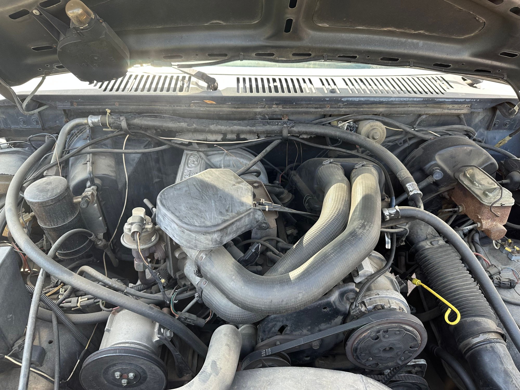

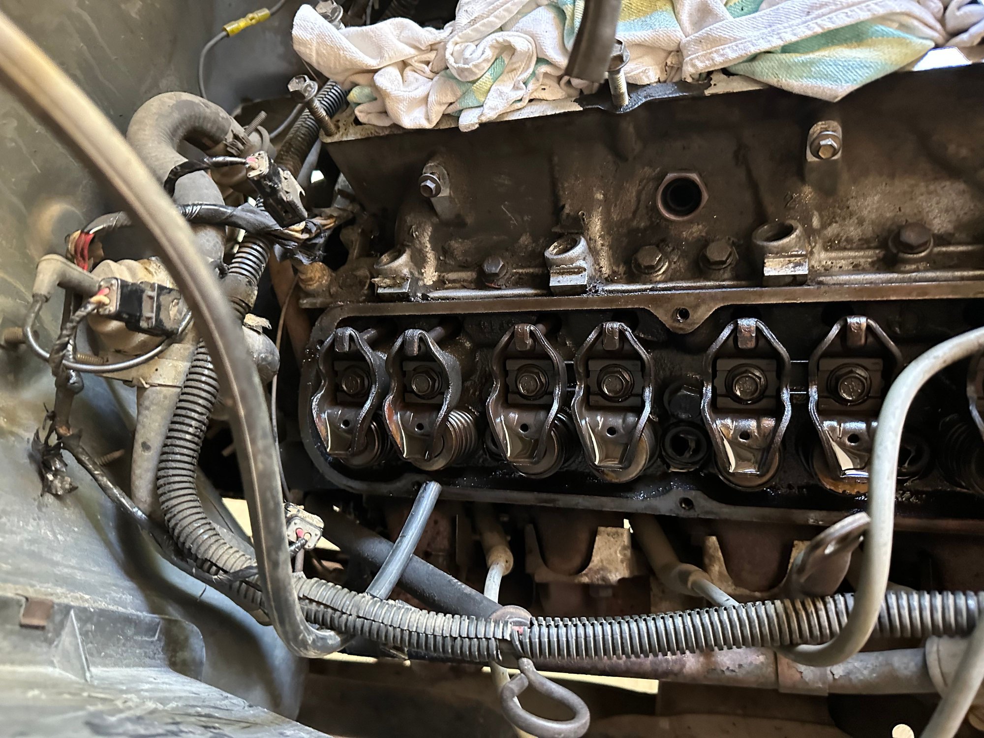

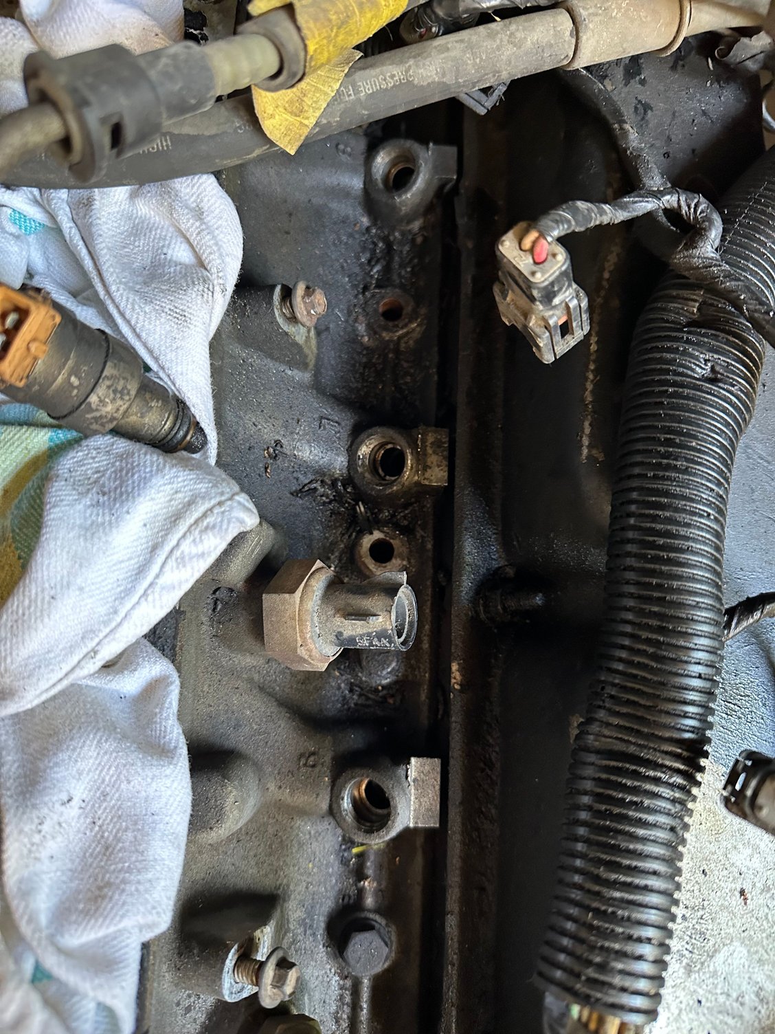

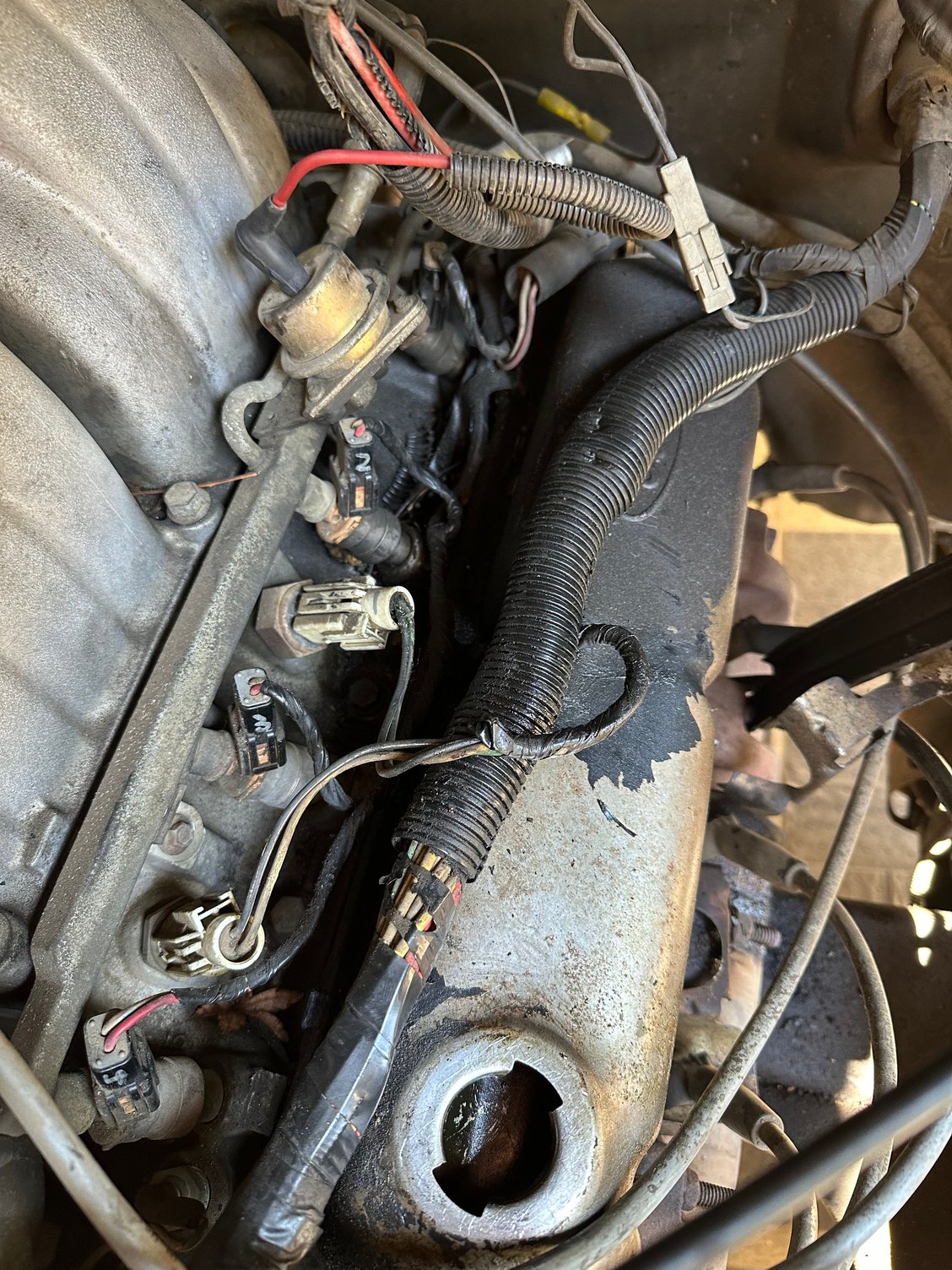

Wellllll, I said I was going to just pay someone to handle the mechanical needs, but I couldn't help getting under the hood a little bit.
Engine was throwing oil on the exhaust manifold, and the gas tank was draining super quick, so I:
Replaced valve cover gaskets
Cleaned and painted valve covers (Ford blue)
Replaced EGR tube
Replaced fuel injectors
Replaced intake manifold gasket
And it stopped burning oil! Biggest repair I have ever DIY'd and it was fun. A long day, but fun. Unfortunately I burned up the starter somehow, so I subsequently replaced that. That was a quick repair.
Now I have more fun problems to find and fix. Motor is running super smooth when cold, but when it gets warm it stutters quite a bit going uphill. My current plan is to:
hunt for vacuum leaks - pretty sure I have a bad brake booster... could that cause it?
Anyway, I am planning on doing a full brake job including brake booster, master cylinder, pads, shoes, rotors and drums.
replace EGR
replace MAP sensor
replace O2 sensor
Any other tips y'all can offer on things that could be causing stutter? Oil pressure is also reading pretty high (L on the NORMAL range). For the interior, I just threw a seat cover on and cleaned 'er out. It's growing on me as is.
Thanks in advance!
