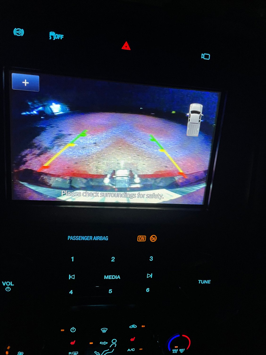

Originally Posted by slowfarmer
Thanks for the recommendation I was wondering about that site as I saw it while googling and it seemed an easy solution. It works well with your stock screen?
Yes it works just fine. Truck recognizes it as factory as far as I can tell.
Be sure and order the one for C&C. They have a different plug than a truck that came with a bed.

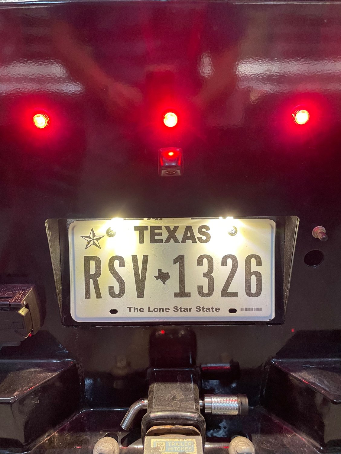

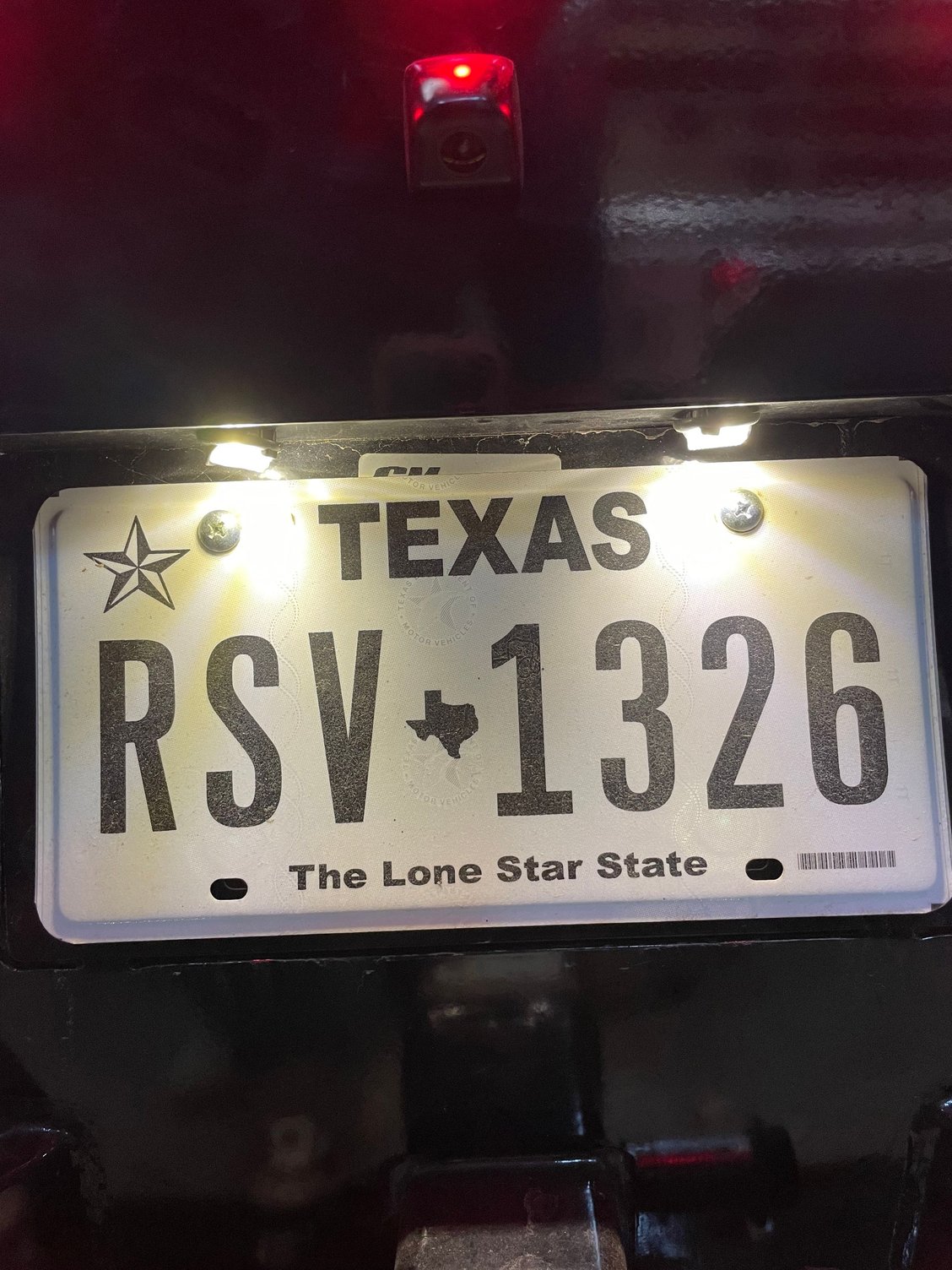

Finally remembered to take these last night just to give you an idea of the camera I used
