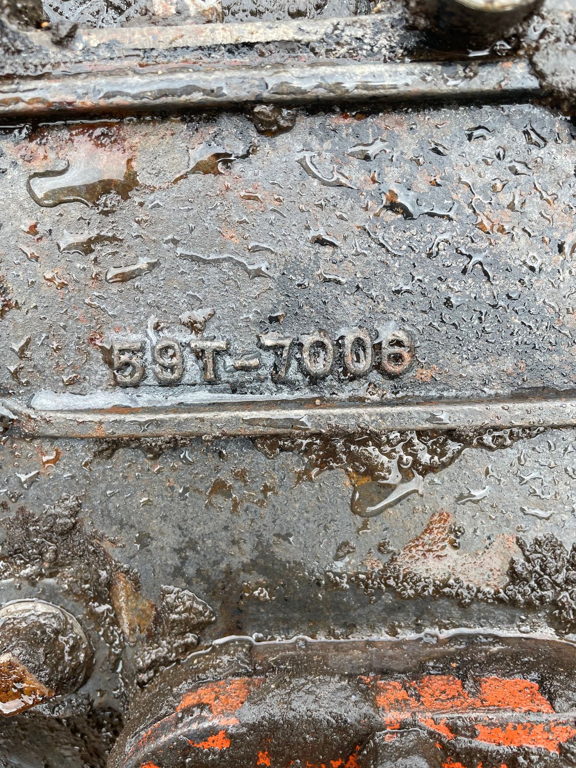

3 Speed or 4 Speed? I have a 1950 F1 V8. It has the original three speed. I have a 59T-7006 four speed. Which one would be best for highway use?

That 4 speed is all spur gears. Operation involves double clutching. The F1 3 speed options have helical gears {excepting the heavy duty option that has spur 1st and rev) and doesn't have the complications of double clutching through all the gears.
All the transmissions have their highest gear as a 1.0 ratio gear.
