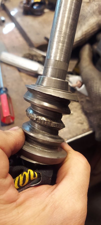

I realize I'm coming a bit late to the party here, but I'm looking to change the worm gear on our 1956 F250 steering box.
I see in the discussion above that it is said that the steering shaft is longer on a 1956.
I just want to change the worm gear itself.
Are all the worm gears the same on these 53 to 56 trucks regardless of the length of the shaft?
I would like to reuse the shaft that I have but I'm wondering if there is a special worm gear for the 1956.
thank you
Gemmer box. #3CC03

Mid-fifty lists the interchange on the worm gear as 53-60.
