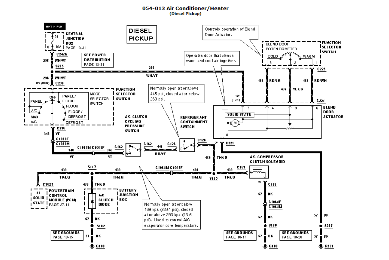

I lost AC the other day mid-route driving in my F350 - just blows warm air. Took it to a shop to have the system fully evacuated and recharged. No leaks detected but the compressor still is not kicking on. There's no power to the binary high pressure switch behind the compressor. No luck wiggling the wires or connector. The 10a fuse in the cab for the compressor clutch tests good. Before I go disrupting wire insulation to see if there's power before the plug, is there a relay I'm missing in the owners manual here?

Is there power at the switch on the accumulator? If no the there is a main connector up in the corner where the inner fender meets the firewall. The A/C is on it's own little mini harness starting w/ that connector. If no power there then could be dealing with a in cab controls issue. If you do have power to the other switch then the wiring problem should be between the switch and the inner fender.
I do have power at the switch at the accumulator. It's nice to rule out the in cab controls.

I have no power to the ac diode in the engine bay fuse box

I dug into this further today. The sensor on the accumulator is presumably bad as jumping the plug causes the compressor to kick on. Is this sensor valved to where I can I pull to replace without evacuating the system again?
