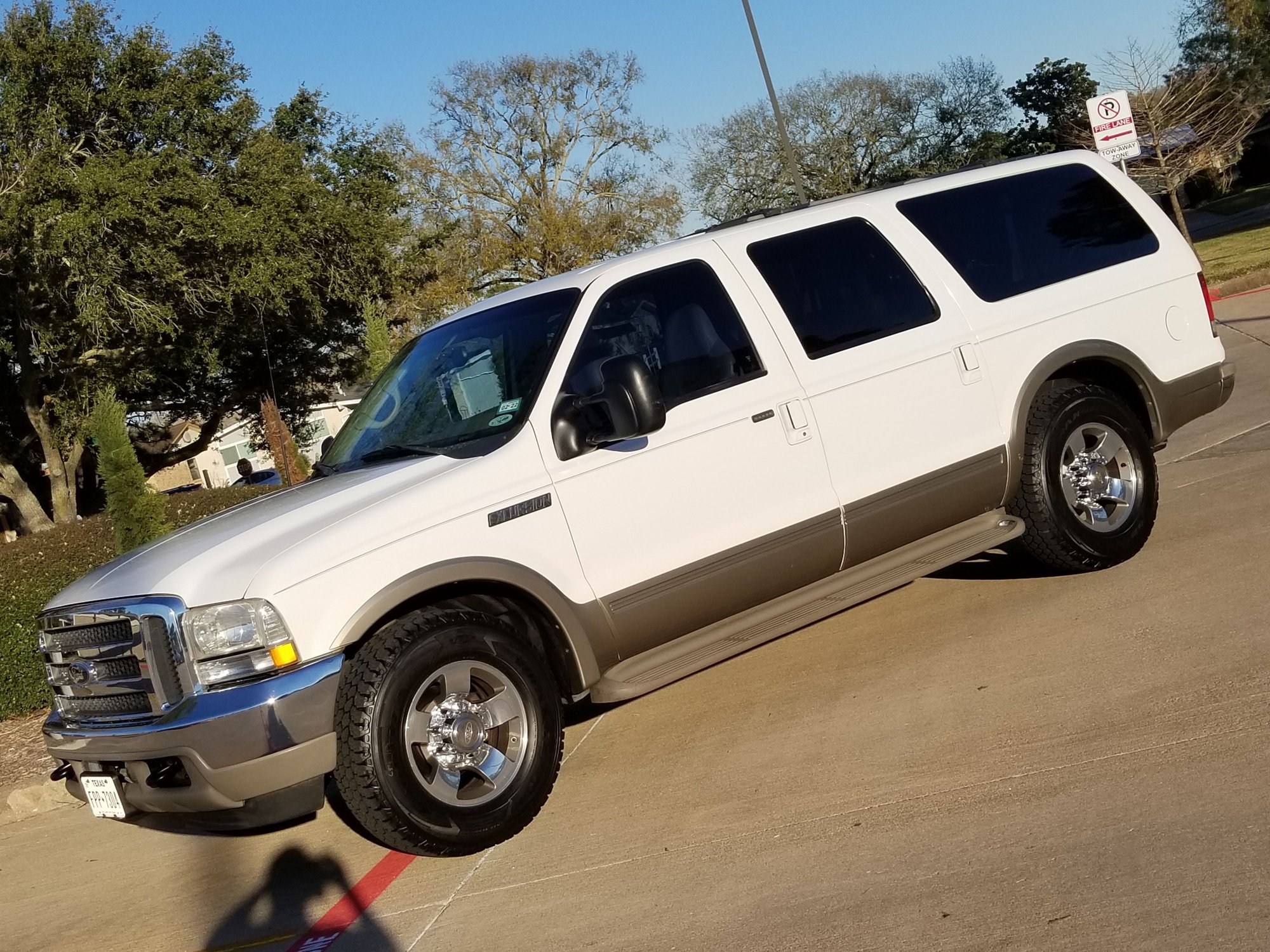

That year Platinum truck did have the front moon shade from the factory...don't know what that is on the top back of the cab though. I would also look into getting some wheels which have a closer offset that work...you'll probably be doing it later when it comes time to replace those 22" shoes when you see how much $$$. If your just towing...and doing so relatively heavy...I would go this route rather than the spacers. The 18" diameter wheel and tire would be a good popular fit. If you can find them there is a one year only 04 18" factory wheel which has the proper offset to work without rubbing. I have 3 sets, a KR set with 275/70/18's on the wife's 2wd Excursion, an XLT set with 295/70/18's on my F350, and a spare XLT set I'm trying to figure out what to do with. Here's the wife's Excursion to know what they look like...
