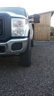

Here's some pics. Went with Cooper stt pro.

How deep is the lip on those wheels? I am thinking of getting the same wheel in a 20 inch, but the same offset or a -12 offset. Any way I could get some really detailed pics of the wheels from different angles and close up?

Those look great.
I have the same year truck, same color but 4 door. Yours looks lower than mine for some reason.
I have the 2" blocks in the rear and my *** is sagging a bit.
