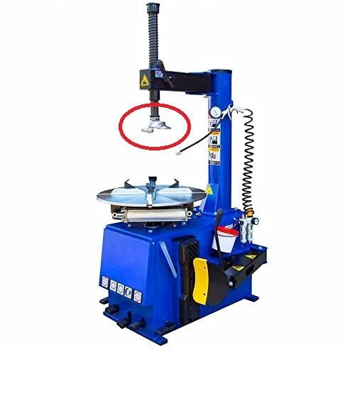

Once I saw the picture or the machine. I think I can see how it happened. The fact it is only on two sections one one rim, and three on the other rim is explained by the fact that is all it took to free the tire.
I find it strange some people thought it was curb damage. In my experience cub damage or rocks never leave marks that look anything like that. Sand and mud can cause scratches like that but never just one.
The tech took pictures and is notifying his manager. It is a small business in a small town and those rims are expensive. I don't see any happy ending here.

Originally Posted by Lamoon78
Easily with the way dually rims are
the duck bill doesn’t get anywhere near that part of the wheel though, atleast from what I’ve seen with my equipment which is pretty new. That said, I’ve only done a handful of dually wheels vs a bunch of Jeep wheels.

Definitely carelessness by the tire machine operator. Over 15 years and 5 drw trucks, I've had it happen several times. On the old machines, the operator sticks a tire iron into the loosened bead and then flips it up towards the center of the machine as it turns. Since a dually wheel hub is above the plain of the rim, the iron can rub on that part of the face if pushed too hard.
