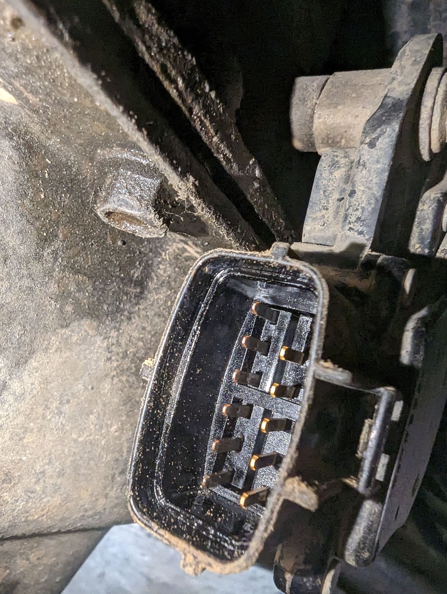

Is this truck an auto or manual transmission? If auto try shifting to neutral and try again. If still no love then you should probably check the connector on the range sensor. It's on the driver's side of the transmission, where the shift cable hooks up. The connector can get corroded and cause a no crank. You can also check the bracket at the end of the shift tube where the cable hooks to the column. The screws are known to loosen and cause this issue. Now if it's a manual I'd check the neutral safety switch should be on the clutch pedal assembly but I don't have a manual so not 100%.

It is an automatic. I checked the range sensor and it looked pretty clean to me but included pictures in case I over looked something (they were taken with the flash on to improve lighting). The screws for the bracket are nice and snug. I haven't had a chance to mess with the shift lever since the truck is currently cranking and starting. I replaced the ignition switch yesterday morning (my old one looked pretty clean though) and had the no crank issue later that day. I was hoping that was my solution and was quite wrong when I ended up in a jam.
What are my next steps?

Is the shift lever loose or sloppy feeling? Those two little torx screws at the end of the shift tube getting loose is probably the #1 cause of a no crank on auto truck.
