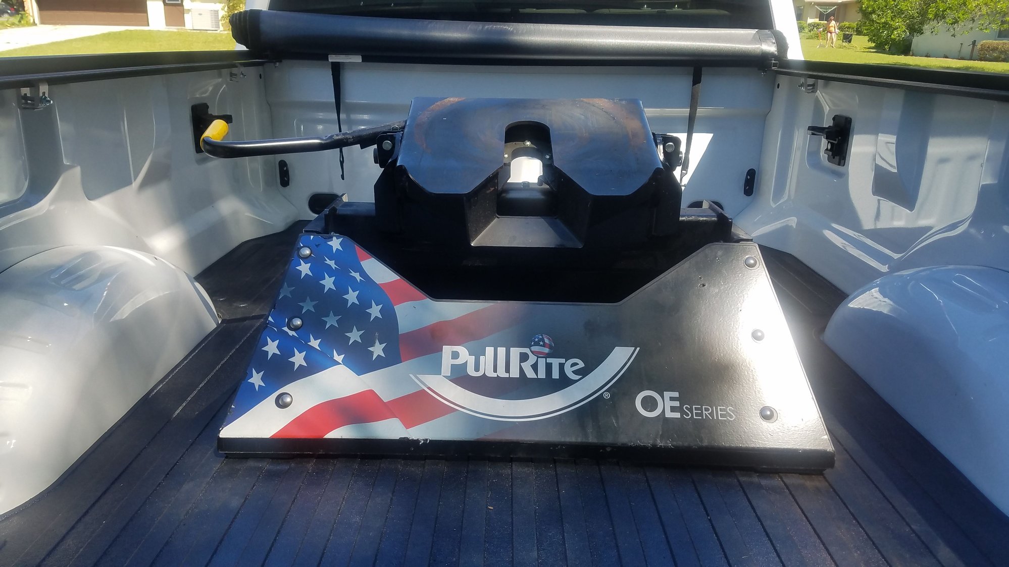

First you have to figure out where the noise is coming from, if it's in the jaws there isn't much you can do. I tried a lot of different things with our now in the scrap yard 20K Reese with some success but it never completely fixed it. I'm now running a Draw Tight Supper Light hitch that's a ball and socket style on standard rails with a standard king pin and all bumping and clunking is gone.
The reason you are getting a bump when applying the brakes is your trailer is moving forward when the truck brakes are applied because the trailer brakes aren't coming in hard enough or not at all and then you get the clunk when taking off when the trailer pulls back on the hitch taking up the play.

Originally Posted by Sous
@rvpuller , do you have a model number or link to the Draw Tight Supper Light hitch you use?
Sorry senior moment it's a Pullrite not Draw Tight.
Amazon Amazon
