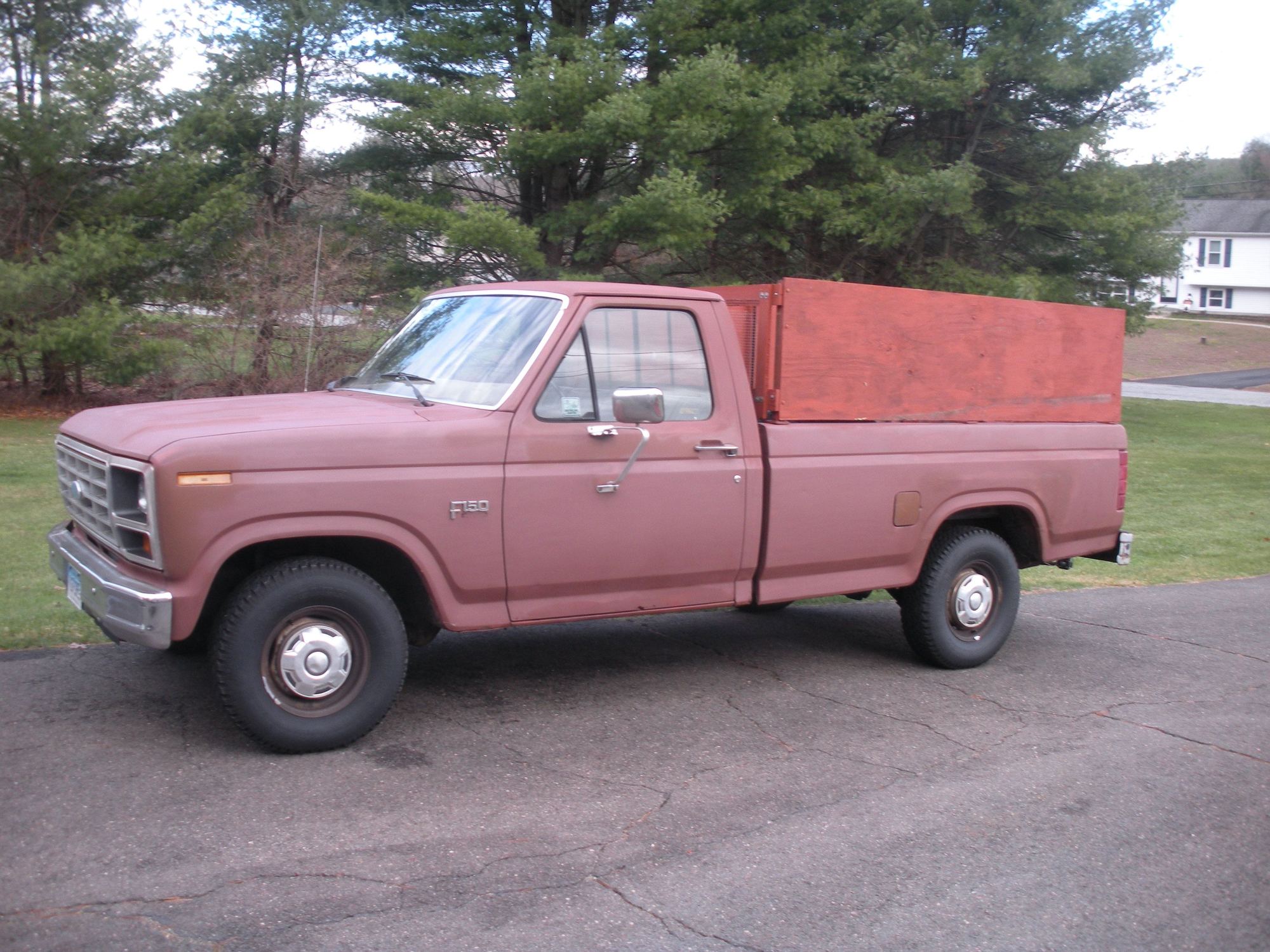

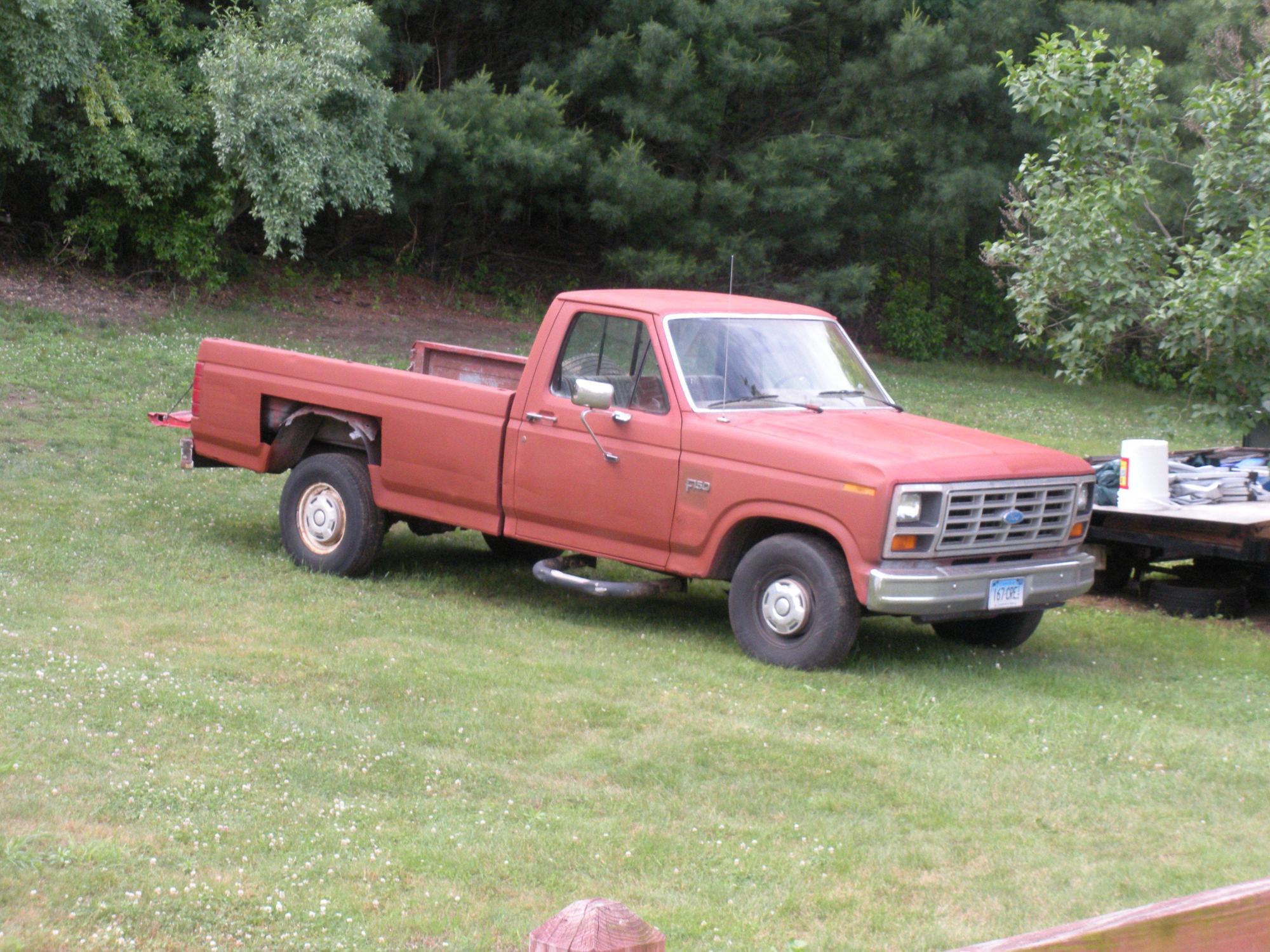

I would say that area is not normal to have rust based on my truck. As for the drivers side rocker...see below. Fluid Film has done a good job over the years. My truck does have the JC Whitney patch panels over the rear tires.
This picture was taken June 2012, I cut the rust out sometime in 2008 or 09. Bonded the panels on 2019, and finally got around to finishing that one side a few days ago.
Maybe someday... I'll get good at body work... I lack patience.

Originally Posted by Max Capacity
I'm glad you included this picture. I'm filing it away in my brain alongside using using a scissor-jack to pull dents.
Whatever it takes... as long as it takes something l already have it in my junk pile.

Yeah, I had to figure a way to hold pressure on the panel to keep it somewhat flush with the fender. Someday I'll sand it a little and get some more bondo to help smooth it out... because we know, looks are everything...LOL
