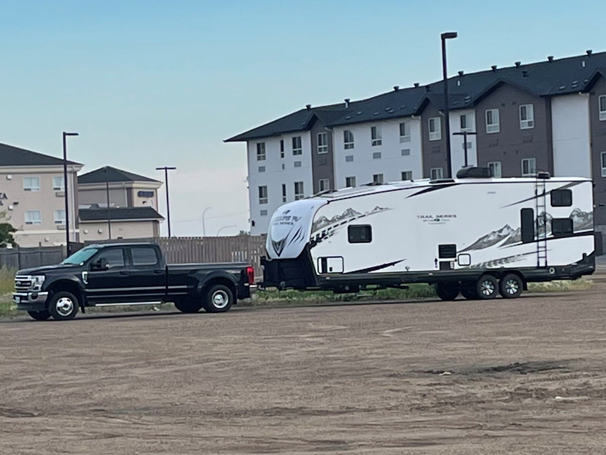

I have 15,000 km's on my 2022 that I just picked up new last July. I just repacked the bearings, greased up the wet bolts (CRE 3000) and inspected everything. The springs look good and I always haul it with a full 100 gallon fresh tank and around a 2000 lb Suzuki Samurai in the garage. They are 7k Dexter axles. I have an ORV 29TRX bumper pull toy hauler.

Nice looking setup!
