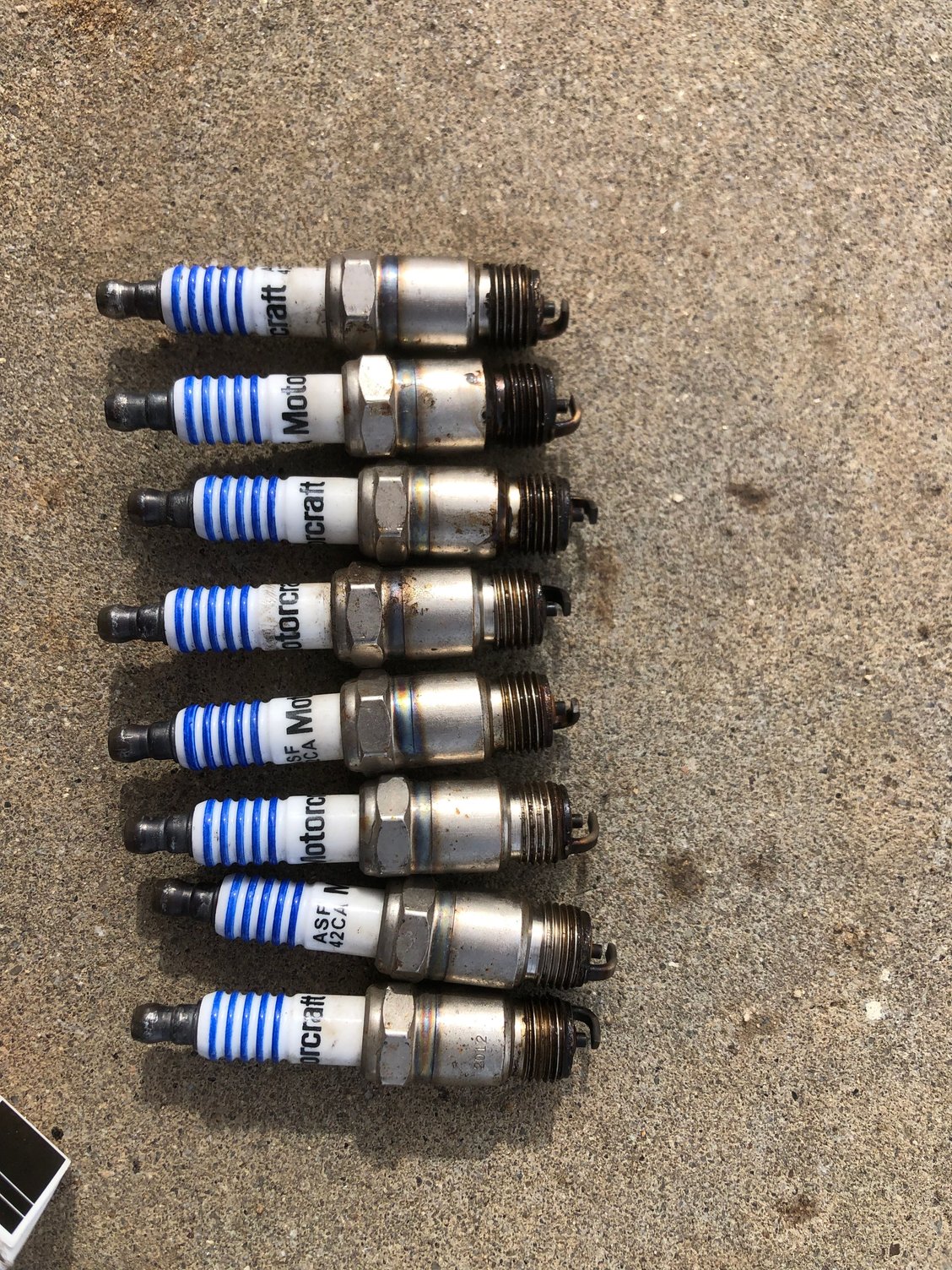

Should I replace my o2 sensor even if I shouldn't expect better mileage out of this thing? I saw its $30 for a Bosch one
these are what the old plugs looked like, unknown miles. But 3 or all of them were hand tight by whoever did them the time before me.

That's pretty bad. But if someone is getting 13mpg with a 7.5l, it's pure highway driving with no load.
Start with the basics.
Check for codes. KOEO and KOER.
Check your fuel pressure.
Check your Timing.
Don't change or O2 sensor. Buy a cheap multimeter instead and spend an hour learning how to use it.
Your plugs look like you're running rich. So it may be a IAT or ECT sensor problem.

The computer won't always catch a lean or rich mixture. But the plugs don't lie. Maybe you have an exhaust leak or unmetered air that's confusing the ecu. Check for codes. I don't remember the od switch being part of the test. I remember the AC switch, the throttle jab, the brake pedal switch, and the power steering pressure switch needing to be cycled.
