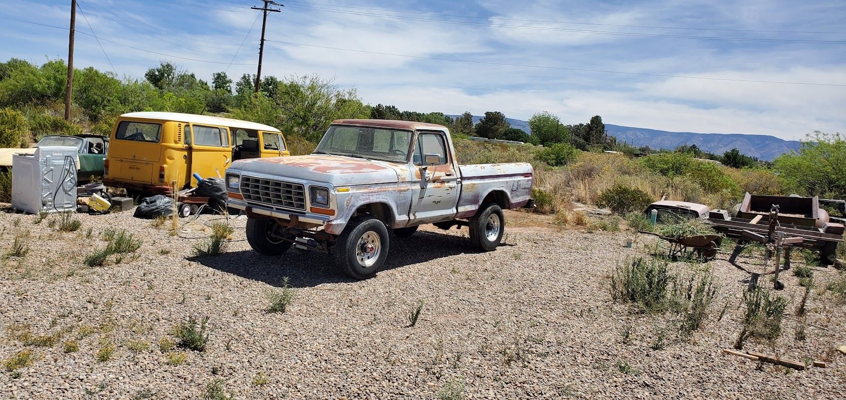

I have been chomping at the bit to start this build thread for the restoration/modification of my Grandpa's 1977 4x4 F150 shortbed Ranger. I was hoping to get some early photos of it when he had it, but unfortunately, I haven't been able to find any. Anyway, on to the story of this rig:
Growing up, I used to spend a week or two at a time in the summers up at my Grandpa's place up in Northern Colorado. He had a cabin that he built himself sitting on about 35 acres out in the middle of nowhere. I used to love that place, and I especially loved his 1977 Ford truck. I remember lugging around in that thing with him exploring and finding new fishing spots.

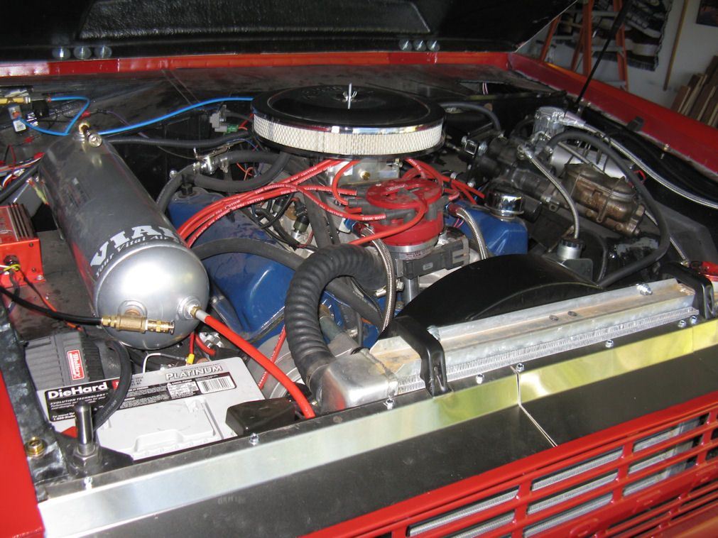

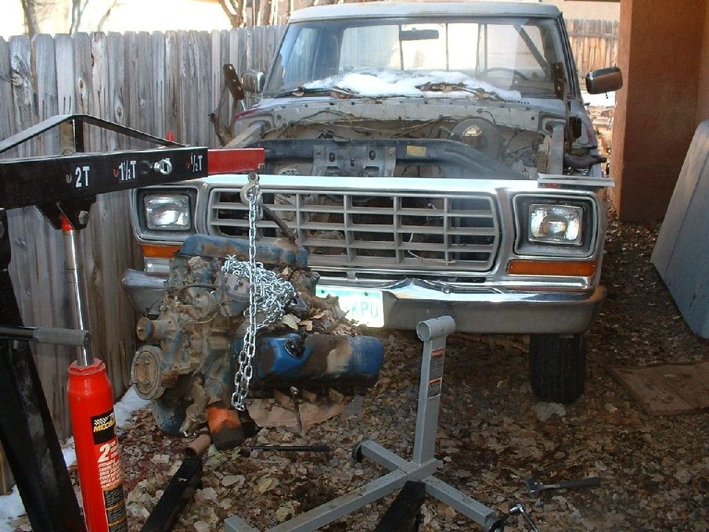

I decided to pull the engine from Grandpa's '77 (a 351M) and use it as the base for my '69 Bronco project. It eventually became a fuel-injected 406 with Aussie 302 heads:
(Pulling the engine from the '77)
(The final product in my '69 Bronco)

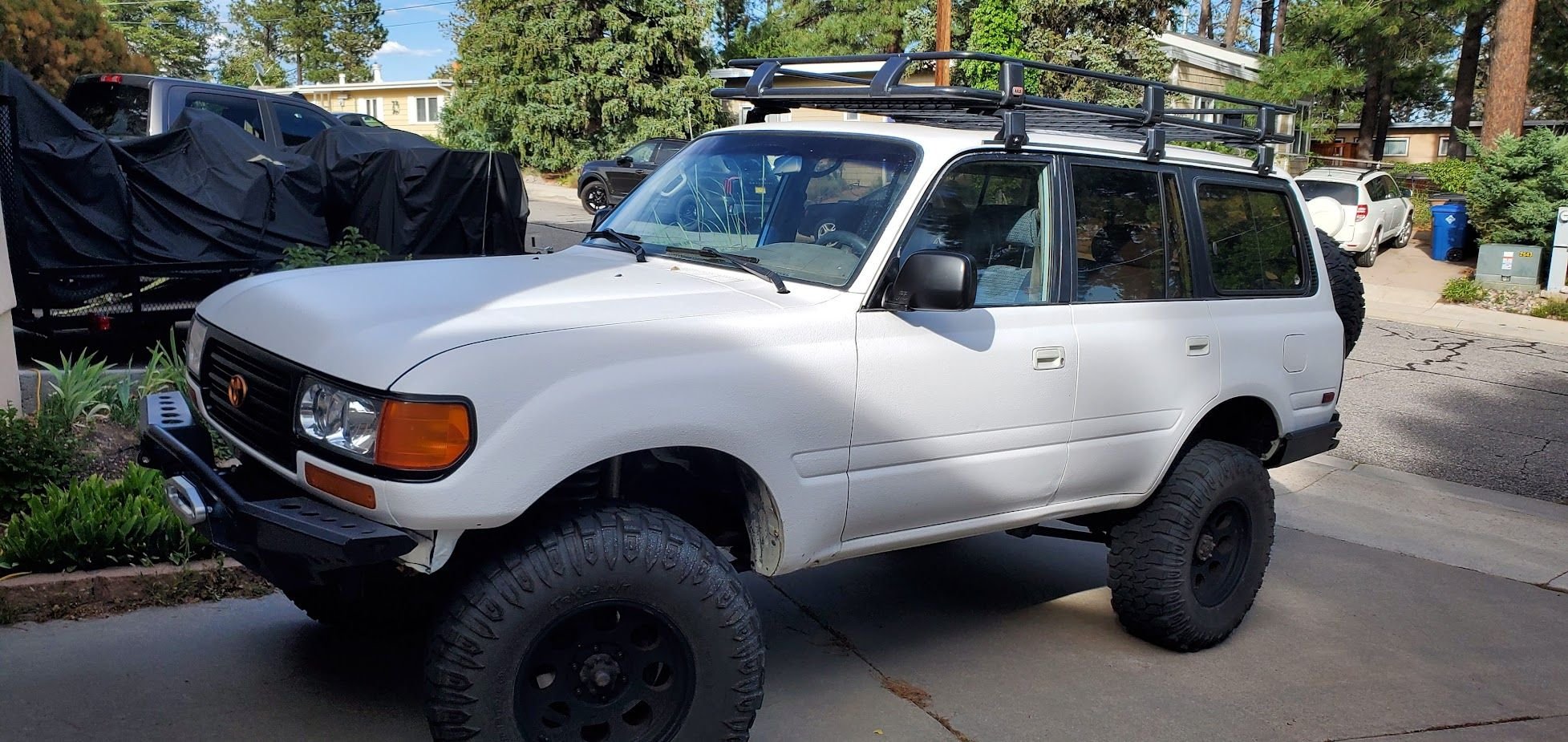

Over time, things changed for me. The kids were growing, and my wife decided to start working again after they were all in school. Finances eased and I was able to start "projecting" again. I purchased an old '96 Land Cruiser and turned it into my camping rig. I have had a lot of fun building it and exploring the mountains of NM and CO in it. But, I started wanting to get an old dentside again. I started looking here and there, but really wished that I could get Grandpa's truck. Out of the blue a few months ago, my buddy asked if I wanted to buy it back from him. Of course, I said yes, and we immediately went down to get it:

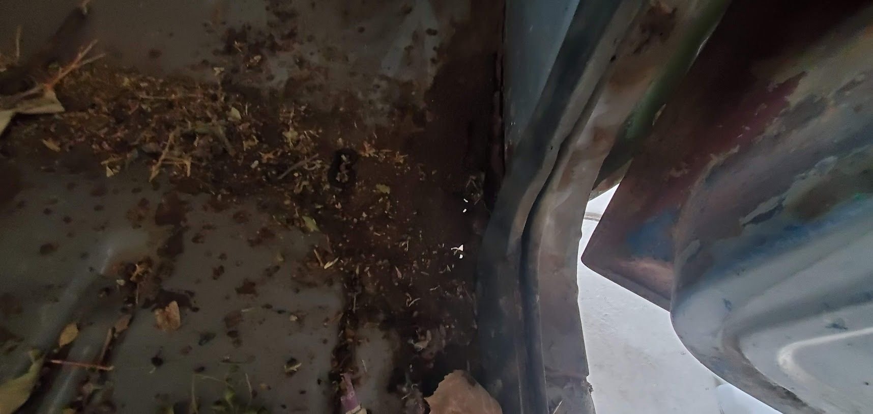

Over the last week or so, we started tearing into it.

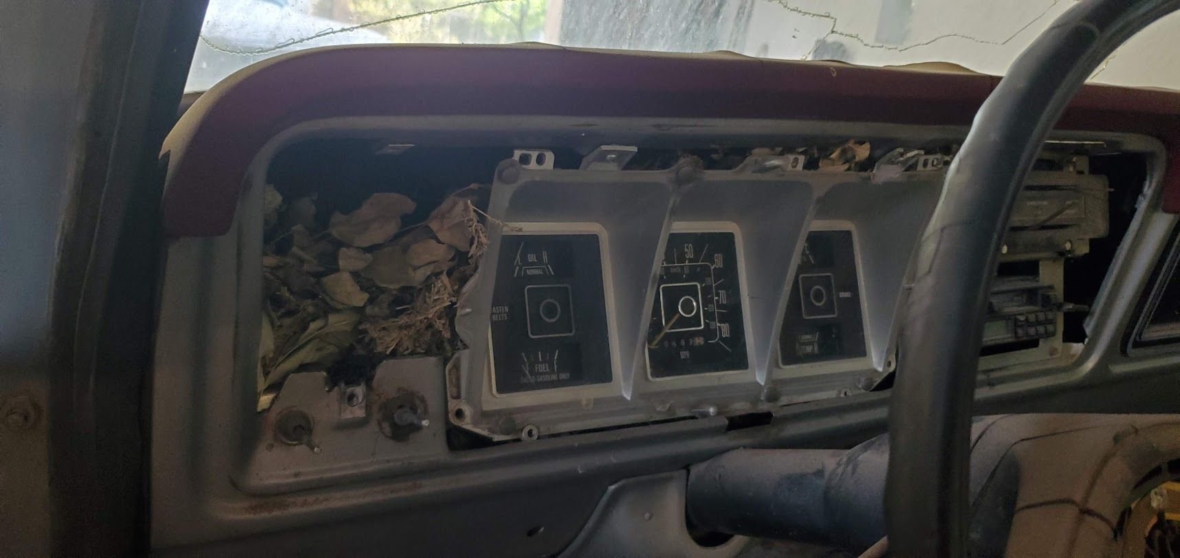

(we found plenty of rats nests - and a dead mouse)

Great story and very happy for you that you got it back. That thing had quite the journey, and so did the rats apparently. So odd that they chose to get behind the instrument cluster. Best of luck and keep us updated!

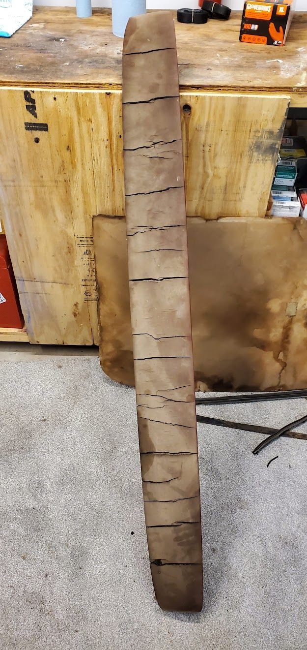

Years of sun can be a little harsh on a dash pad. The vinyl had all come off of the headliner, also:

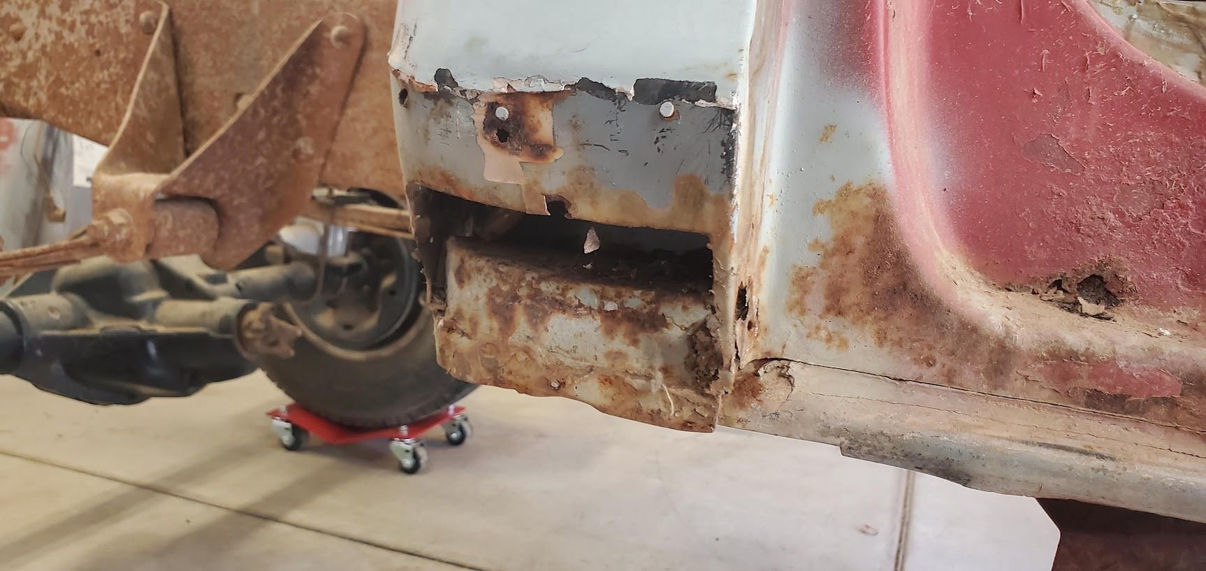

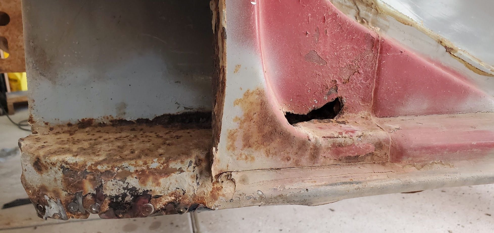

I also found some rot on the passenger side floorboard, as well as the cab corner on the driver side:

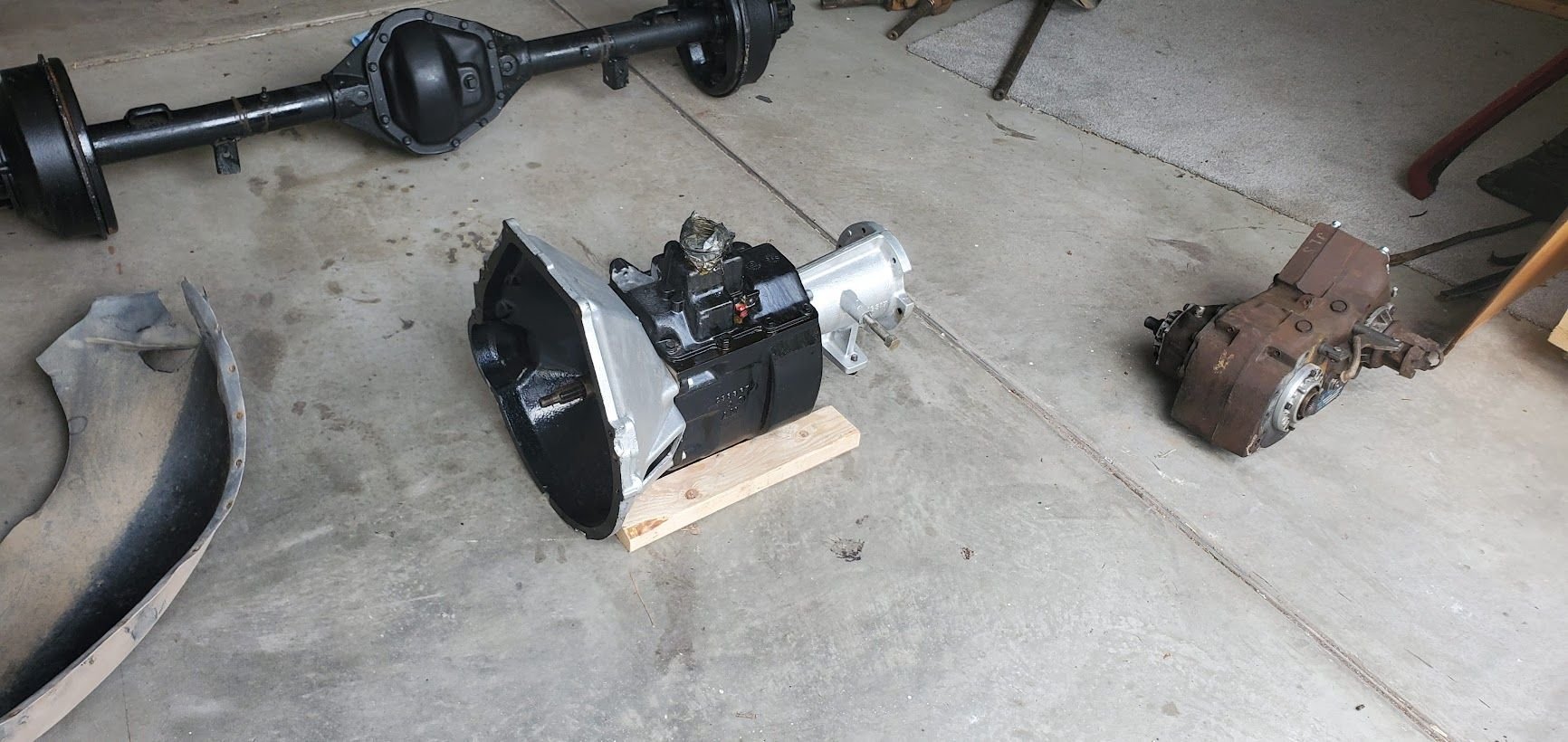

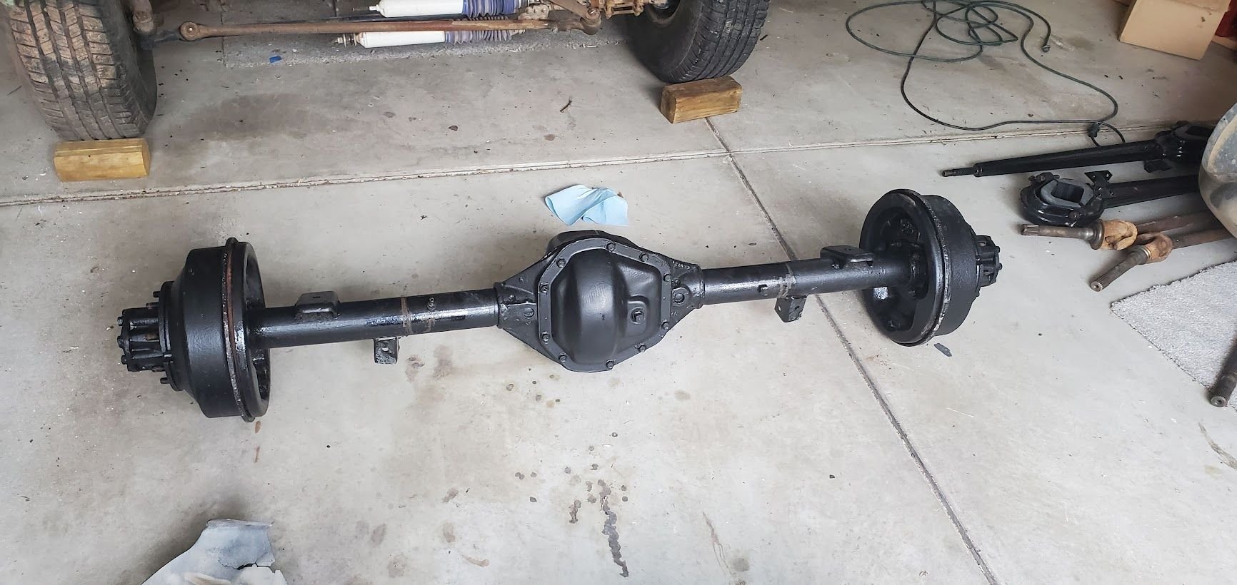

Disassembly continues. Also, my friend who owned the truck for the past decade or so, dropped by with a load of parts. I was mistaken in thinking that the Dana 60 with the limited slip was already under the truck - that was a different 60 he had to get it rolling. So, he dropped off the correct 60 for me, as well as a bunch of other parts.
Badges:
NP435 and NP205:

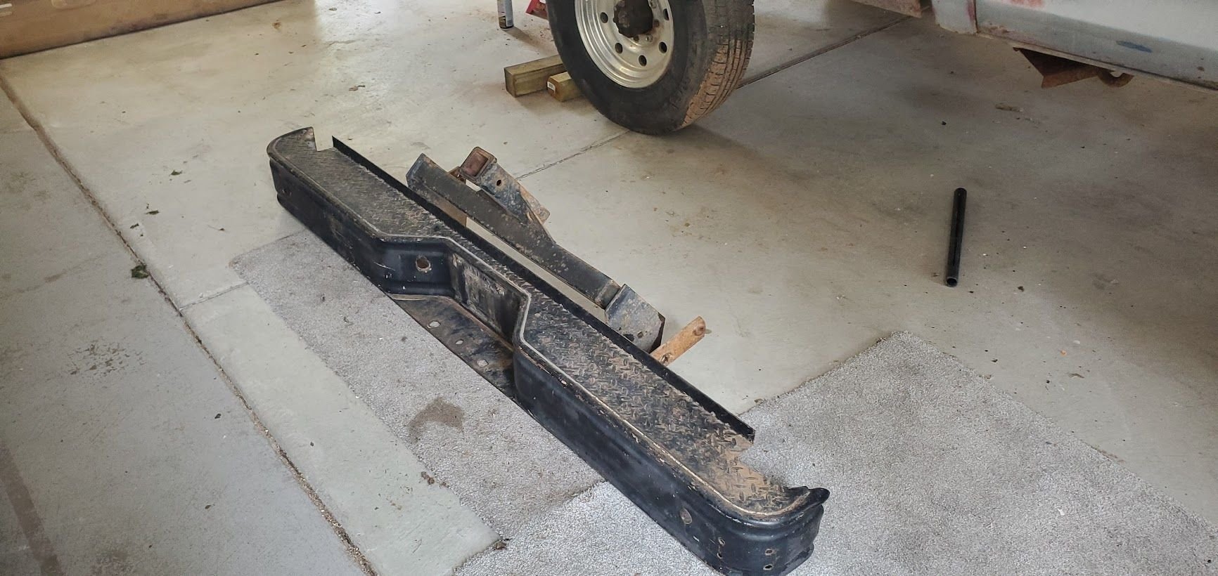

Rear bumper gone:

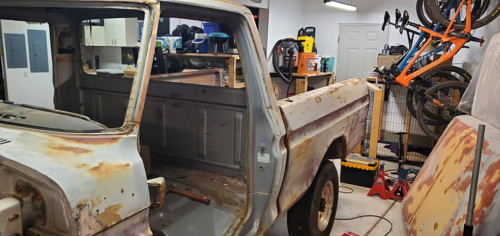

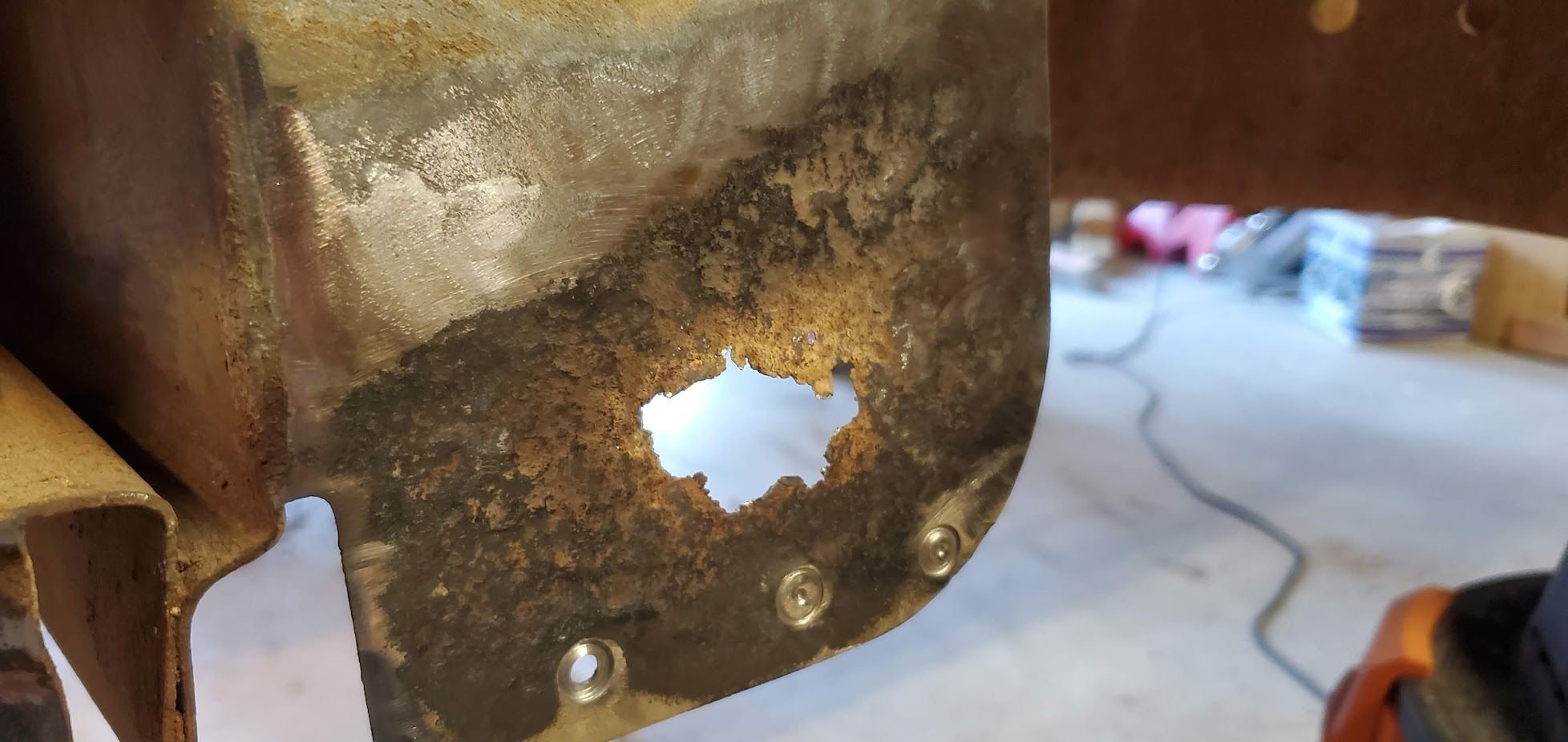

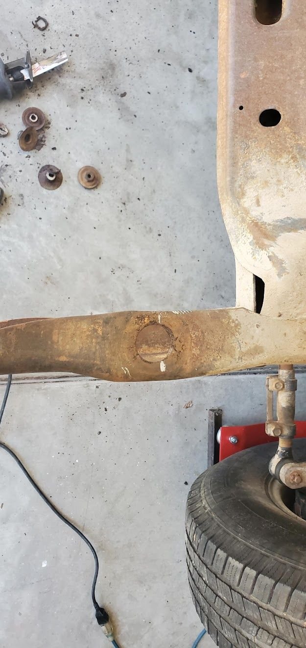

Cab is gutted. There are 4 holes in the floor where bolts wore through. The cab mounts must have degraded and sunk, or perhaps these bolts were all installed upside down?

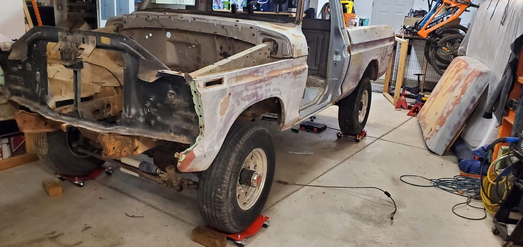

I also got the truck up on some new auto dollies that I received for my birthday. They are pretty slick!

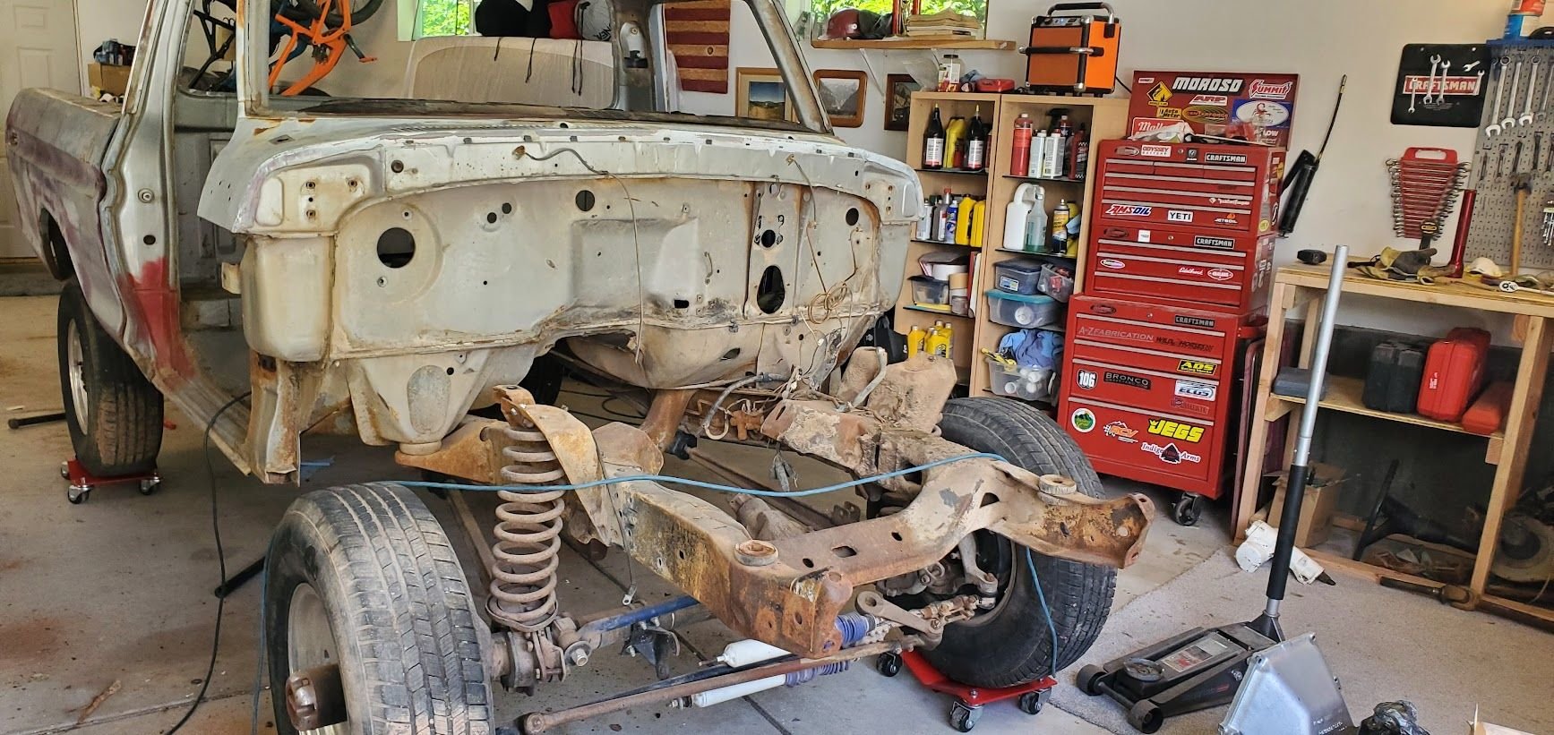

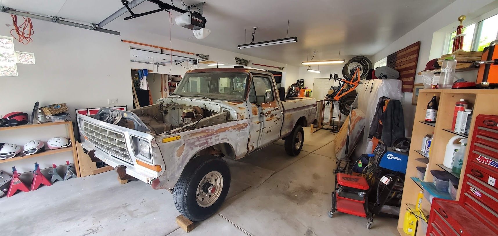

Been getting out and working here and there. I got the front clip and bed removed.
The core support mounts were rusted together, short work for the sawzall:

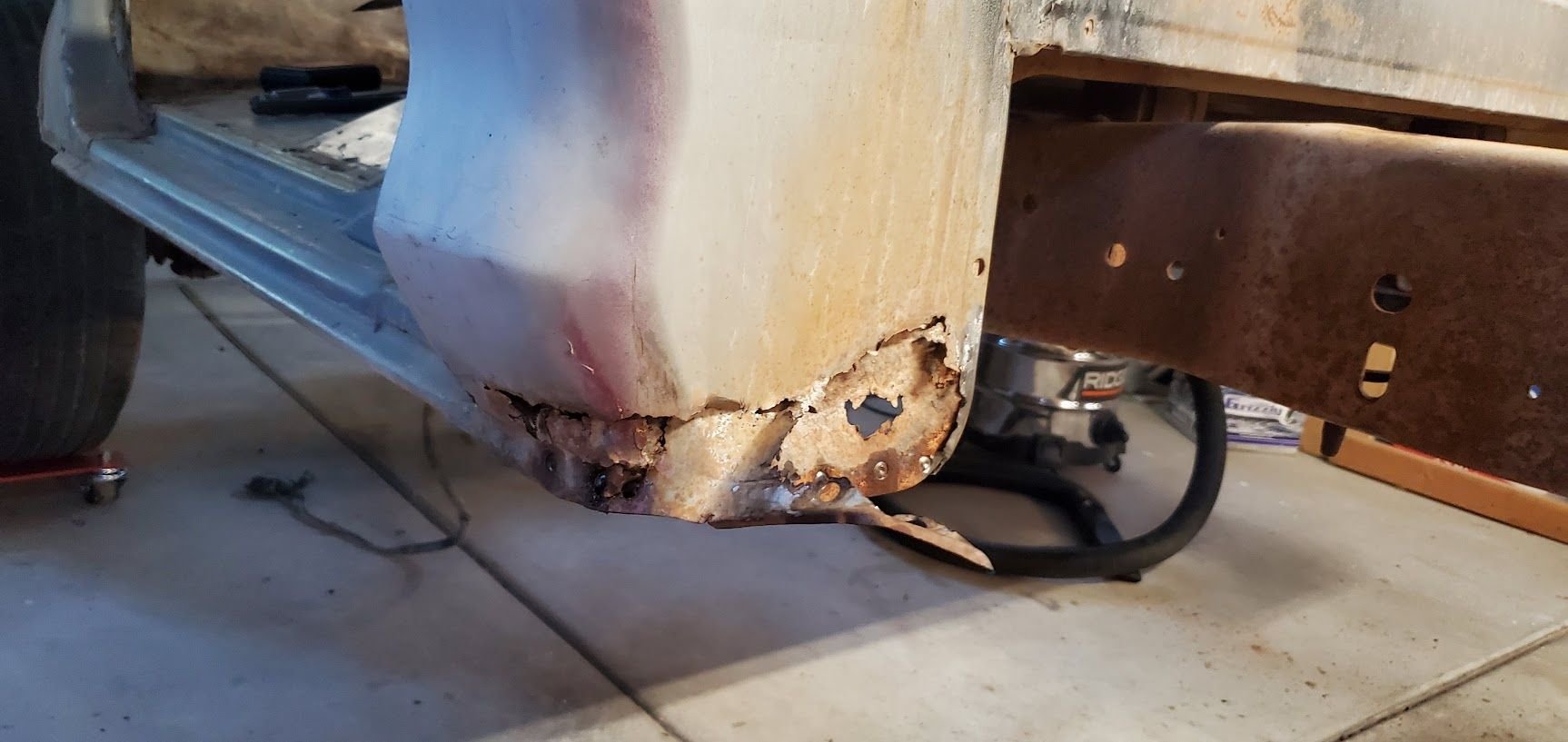

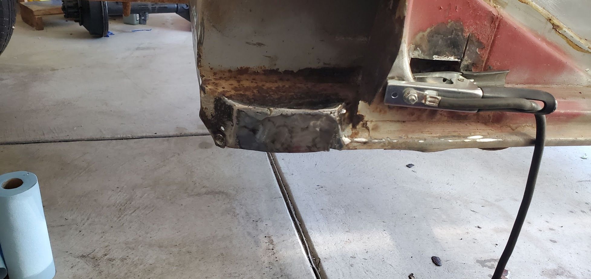

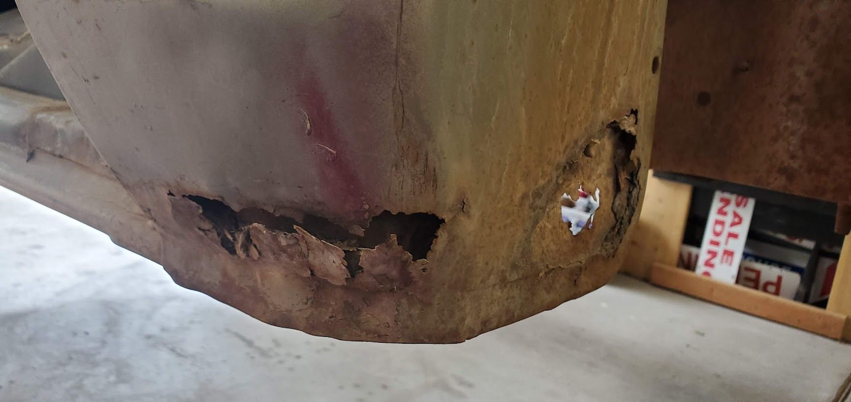

Both cab corners are in need of work. I have new pieces for the outer skins. I'll have to fab up some patches for the inner skins. The passenger side already had some "repair" work done that will need to be replaced.

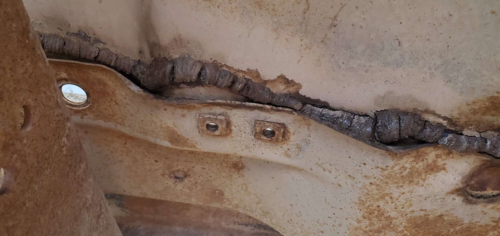

While under the truck, I noticed some odd application for seam sealer under the cab. It is like this on both sides of the truck - misses the seam.

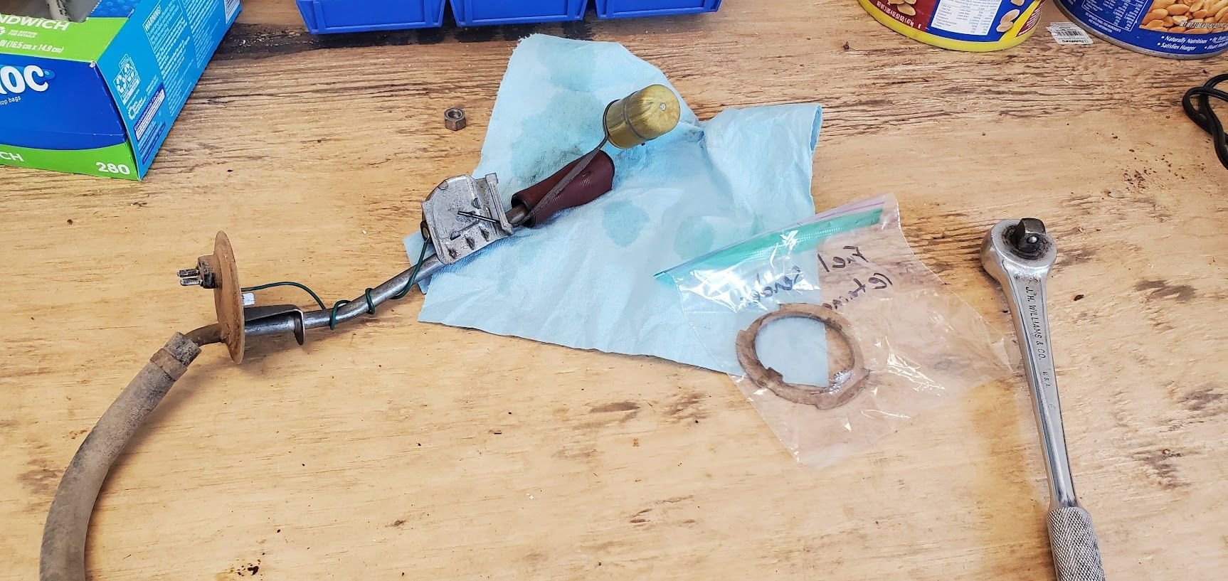

Next up was removing the fuel tank. I've been wanting to do this for a while, as the varnish smell was annoying in the garage. Luckily, there was only about 3 gallons of old fuel that needed to be drained, which fit in a single fuel can. Overall, the tank looks to be in fairly good shape. Although, the skin is pretty thin underneath where it contacts the support rails. I'll look at it closer a bit later to determine if I will keep it and refurbish, or just get a new one.

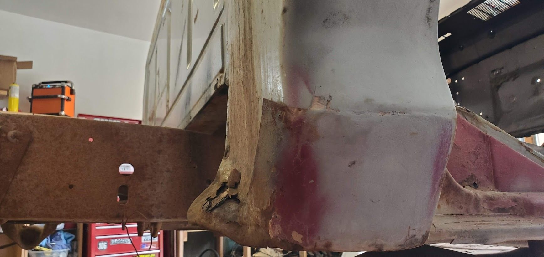

Then I started tackling the cab corners. I didn't get too far this weekend. The passenger side had a repair patch that was screwed in place.
Driver's side:

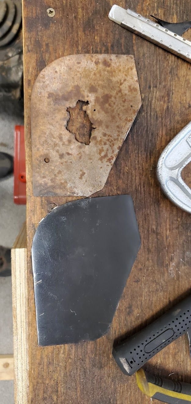

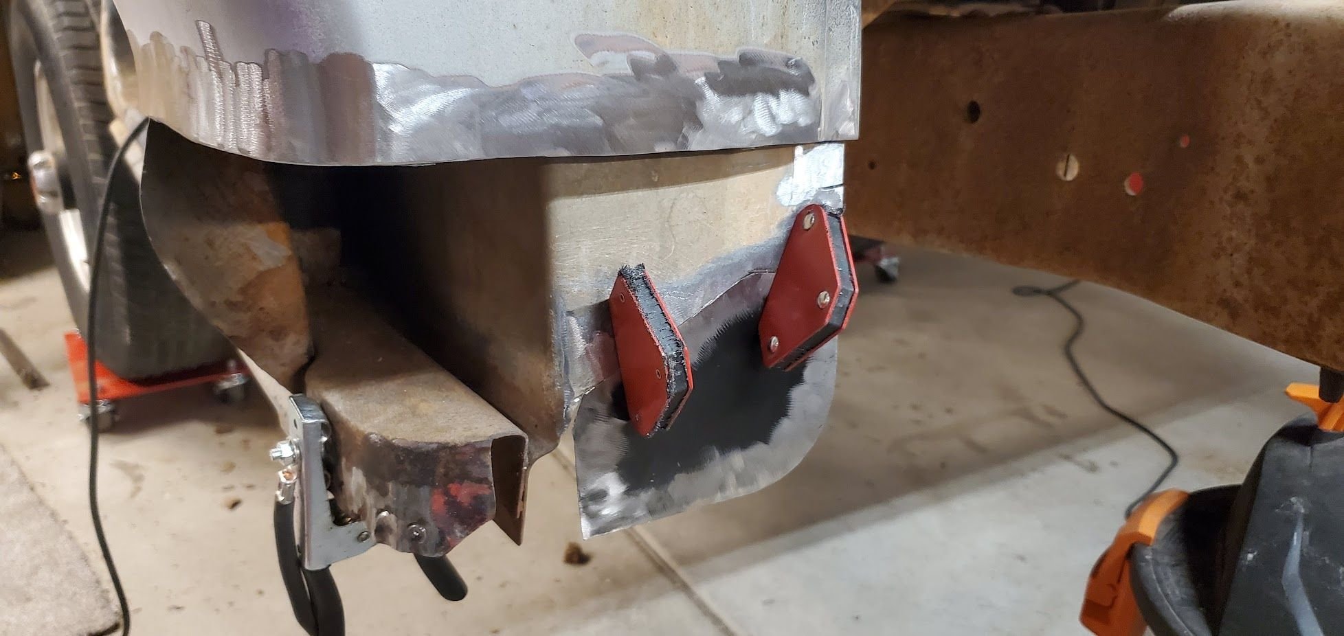

Been a bit since working on the truck - we took a family vacation out on the east coast. I got to get out for some work the last couple of nights. The first "new" part is officially tacked on to the truck. I fabbed up a new piece for the inner skin on the back side of the driver's cab corner using some of the leftover replacement skin that I had for the outer cab corner. Turned out pretty well, and was good practice for the parts you'll actually be able to see later on. I've read that the replacement panels are not as thick as OEM - and that is a fact.

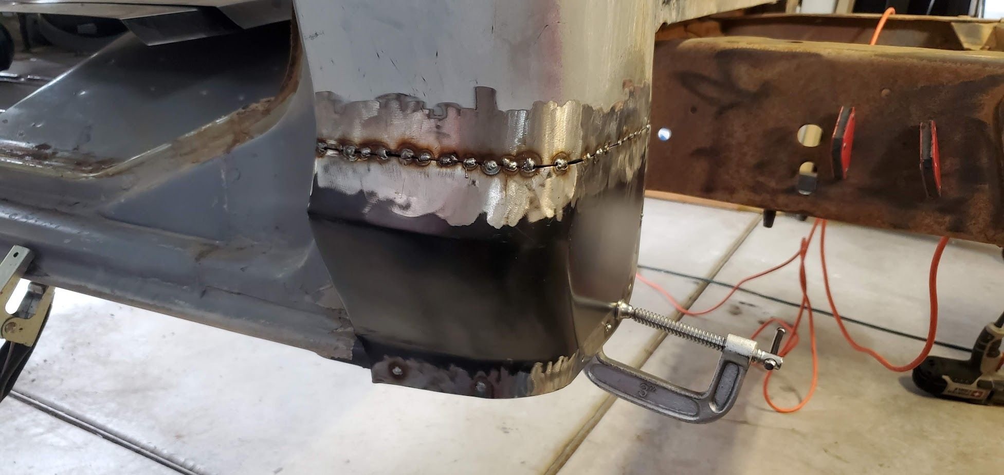

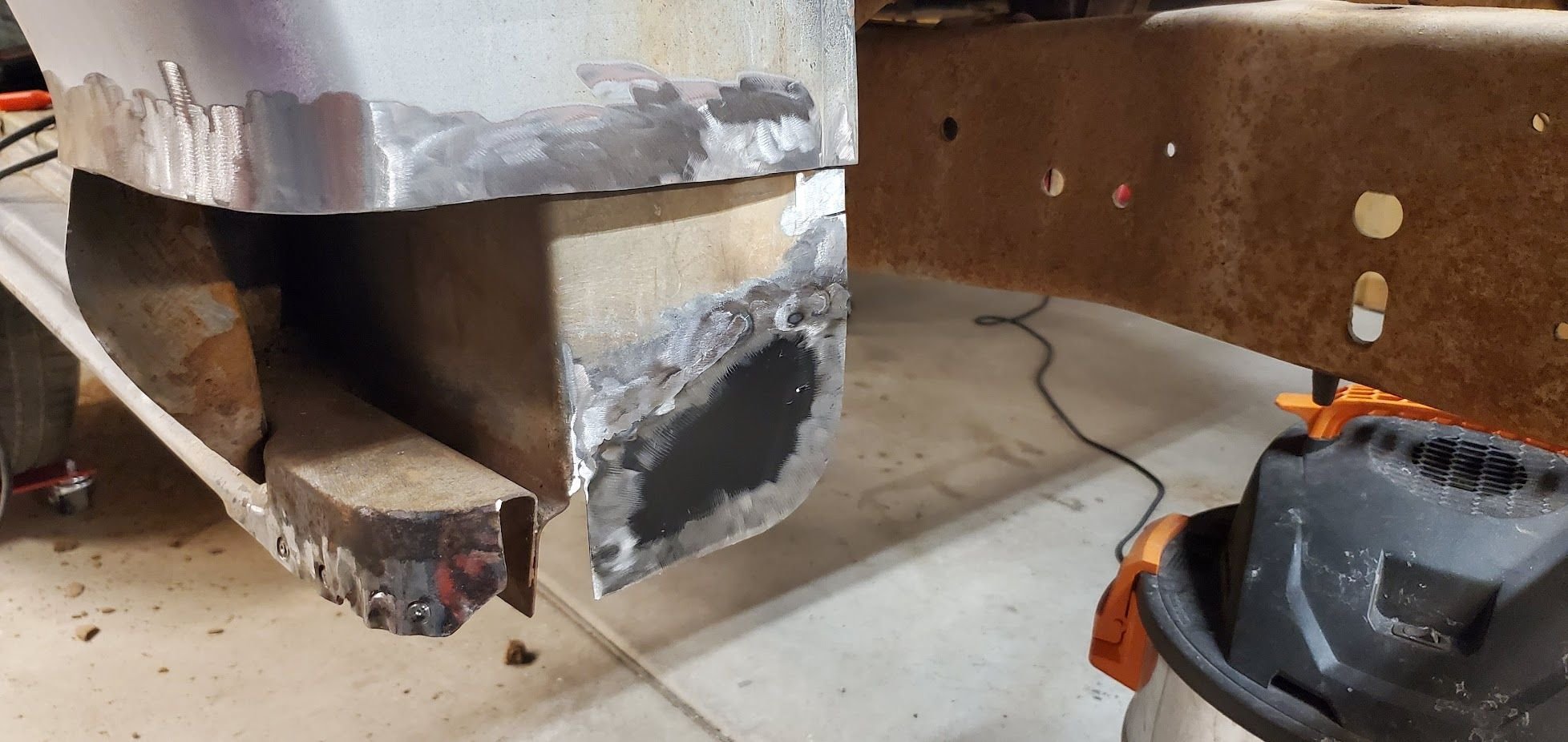

The passenger side cab corner is significantly worse than the driver's side. I still have some more smoothing/finishing work to do, but I have most of the sheet metal in this area patched up. I do still have some more patch work to do on the underside of his corner, but I think I am going to wait until I have the cab off and tipped back so I don't have to weld and grind upside down.

I prepped the area and applied POR-15 on the inside of the cab corners. I then started tacking the corners in place. I got a little too ambitious on the driver's side before stopping to take a measurement. Turns out it was off, so I had to remove it again. Not sure where I went wrong, but I had to order another one. The lines just didn't match up to the door nor the bed. The passenger side looks good from an alignment standpoint, though.
One thing that was slightly frustrating is that on both sides, the replacement pieces were too deep - they don't match up with the inside edge of the cab. I tried and tried manipulating them with no success. In the end, I just tacked them in place, since that spot is going to be hiding behind the bed. But still...
