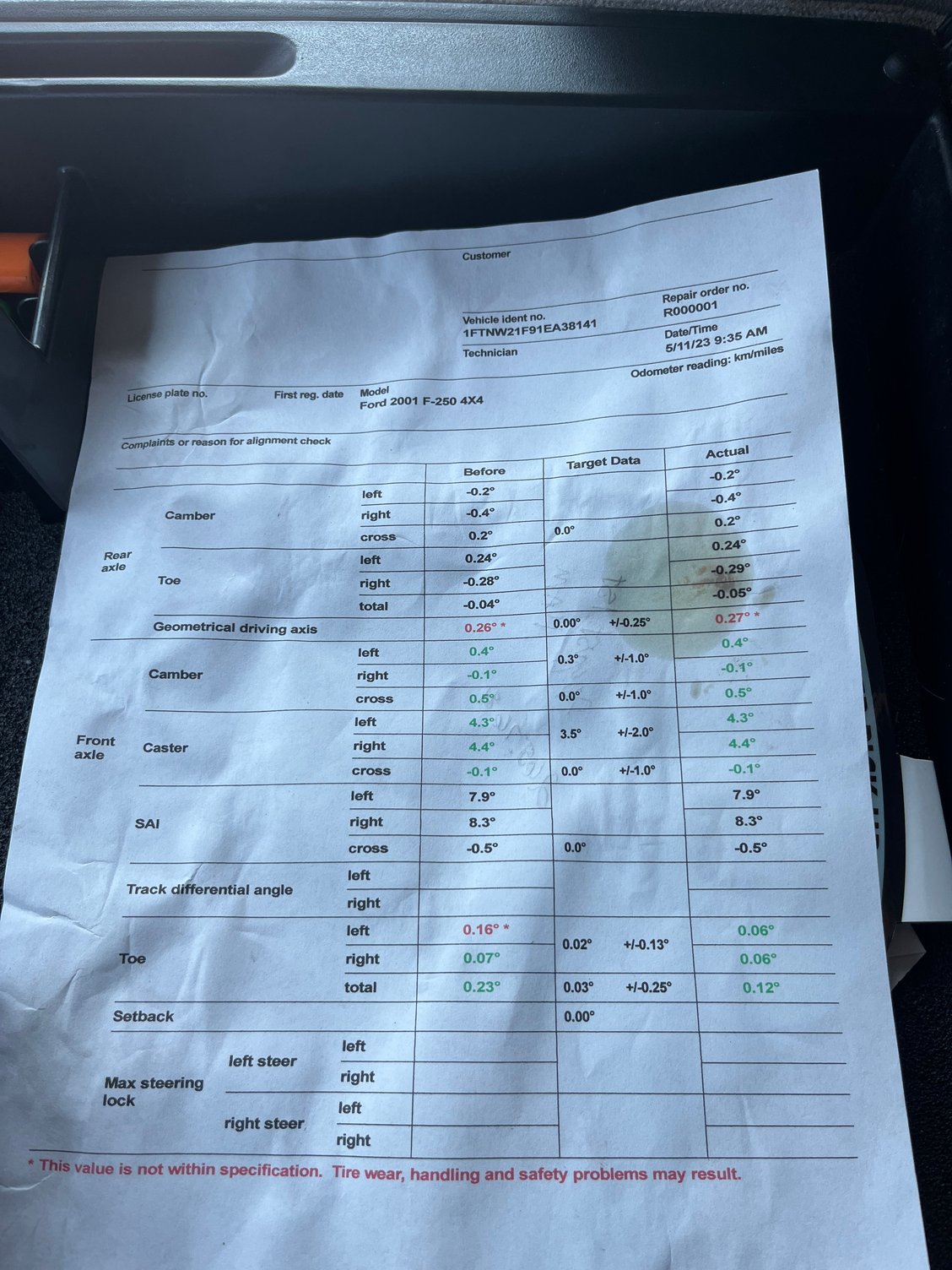

Looking for some insight... Just replaced all 4 ball joints, both hub assemblies, and the drag link end at the pitman arm. The other end of the drag link and both tie rod ends were still good. Took the truck and had it aligned at a tire kingdom. Something still isn’t right. If you correct left, the truck continues to track left. Same if you correct right. Anything over 65-70 is super sketchy. There isn’t any bump steer. When breaking there isn’t ANY pull. Same for accelerating, no pull either way. There isn’t hardly any return to center either. It tries a little…. Very little.
I’m questioning if I have too much preload on the knuckle? I followed some directions I found in a thread on this site… torqued the bottom joint to 30 lbs. then torqued the top to 69lbs + clear the pin hole. Then torqued the lower to 150 lbs to finish. Greased everything good. Put about 250-300 miles on her today. Still like driving down a balance beam…
I set up some angle iron on the wheels, leveled them and ran 2 tapes. To measure the toe. It’s a dead nuts 1/8” - 3/16” toe in.
i don’t believe it to be the steering box, because the truck steered just fine until the hub when out, then noticed ball joints had a little play…
what’s the next move? What’s the proper method of torquing ball joints?

Here is the print out from the alignment shop.

That's the proper way to torque them. I did my truck that way and actually just out a set of Spicer ball joint in a 2012 truck yesterday and it had a paper in the box to do it same way. Said lower to 40. Upper to 70 then tighten to cotter pin hole. Then lower to 150. So basically same as you did.
It does sound like memory steer though from ball joint. What ball joints did you put in it?
