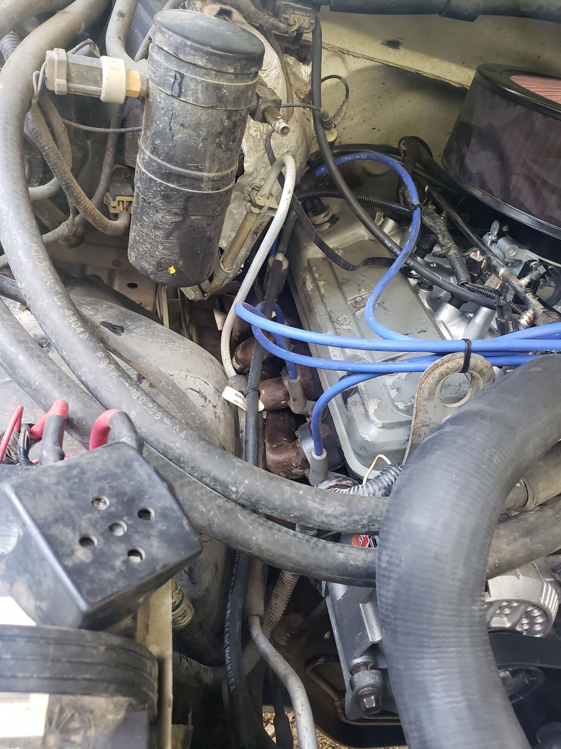

Two years so far. Only thing I have never liked is the ball and socket style collectors. They tend to loosen up over time.

Those knock-off headers claim 10-15hp and Banks claims 68HP from a dyno. There is no way those headers are as high quality. The stainless steel to make them would cost more than $269. Does a magnet stick to them?
Banks flange is 1/4" thicker and they will never warp. They were easy to install when the inner fenders are out of the way. I've checked the header bolts twice since install over 40k miles ago and none have loosened. If you've got the money buy the Banks.

I’ll have to look for pictures. I installed them when I had the front clip off the truck, so that was a easy job. I capped off all the holes for 02 and EGR though. As I have a carb on the EFI intake.
