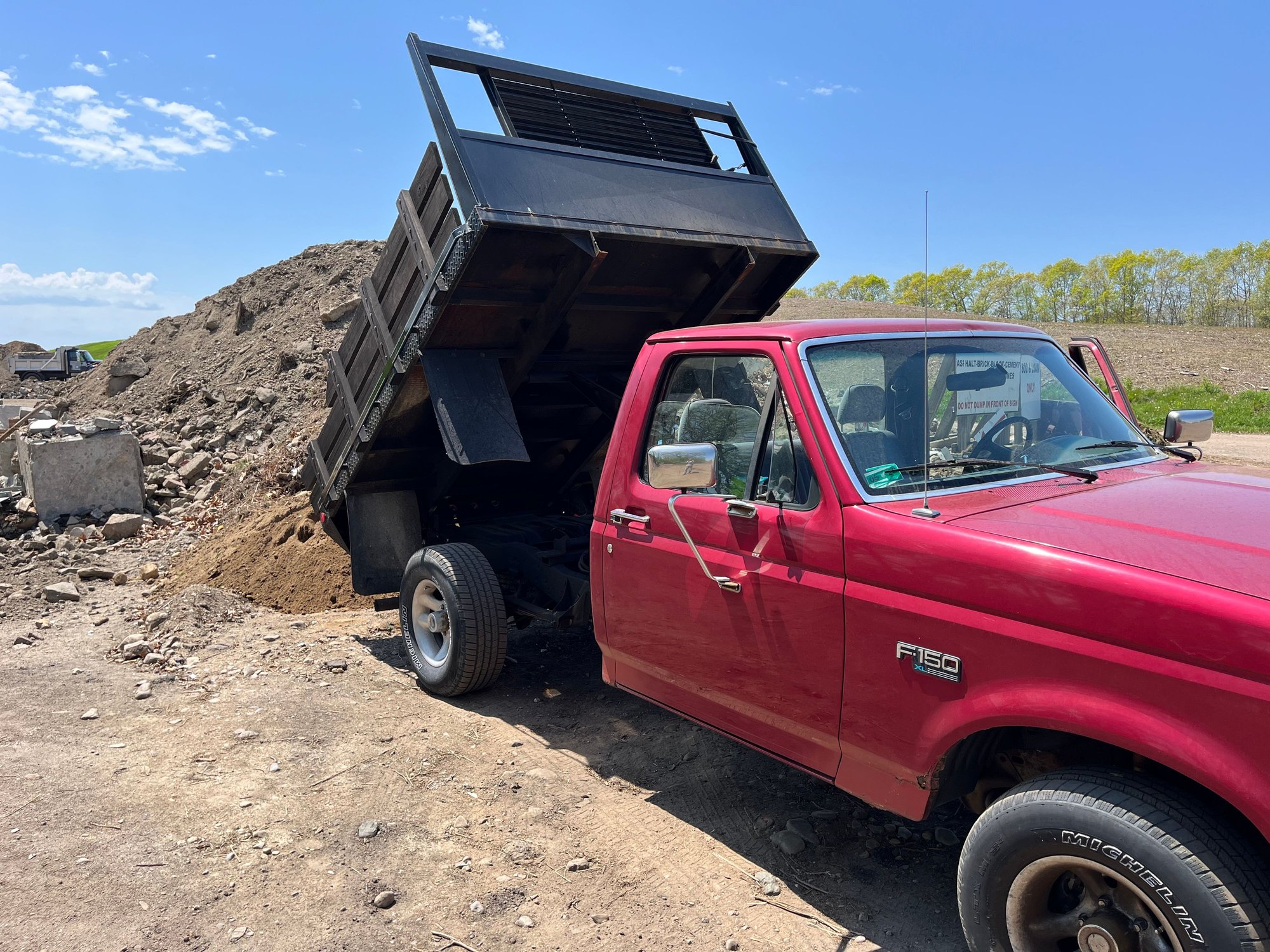

First off I I am not a mechanic. However, I am an electrician and do all the repairs around my house regarding carpentry painting, etc. So I’m hoping that I’ll be able to fix this using your help. I’ve owned this truck for two years. It is a 1994 F150 with a five speed manual six-cylinder. It has 135,000 miles on it and I am the second owner. The first owner was a farmer who did a lot of maintenance on his own and used a dealership when necessary. For its age, the truck is in really good shape (I think), but it is an old truck.
Prior to when I bought the truck, the front fuel tank was not always providing fuel consistently. When I would select it, sometimes it would work fine, and other times it would start to feel like the engine was not getting fuel and I would switch it back to the rear tank. this is not the problem that I am posting about however but it might be related. The other issue that I would like to try to solve is that sometimes it will not start. It turns over but will not start at all other times it starts up no problem
and idles properly. The no start action happens less than one in five times and I started noticing it about three or four months after I bought the truck. Lately it’s getting a little more consistent with not starting about every five times I don’t use the truck much accept in the summer. so that could be over the course of more than a month. I think what I have done to solve. The problem is push the car about a foot or two without it started and then I tried to start it again and it starts up. The reason I say I think is because there have been 2 or 3 times where it will start up in the situation after I switch the fuel tank selector switch. I don’t know if this is just coincidental or if this is a problem that goes along with a second problem that is affecting the trucks ability to start sometimes.
I’m wondering if my moving the truck indicates it could be a starter that’s failing and I’ve noticed that it looks like the starter doesn’t have a heat shield which I wonder if it’s contributing to the degrading of the starters ability to work. But I don’t know if this is even the problem or not. Any suggestions on how to troubleshoot?

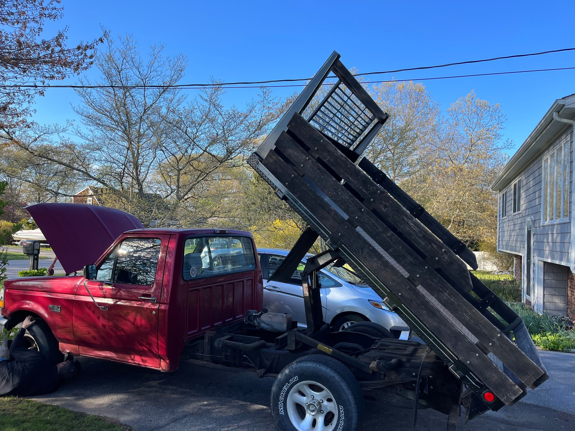

I no longer hear the fuel pump priming the line when I turn the ignition switch to the On position. When the No start was intermittent I would hear the pump prime when it did start and when I didn’t hear it prime it wouldn’t start. Now that I don’t hear it priming the line I could try and see if the fuel pump is getting power. With the dump body lifted I have easy access to the fuel pumps. Can I do this by removing the fuel pump connector and testing at the connection/pins?
Old May 20, 2023 | 10:05 AM
toolman60's Avatar
toolman60
Joined: Apr 2018
Posts: 551
Likes: 151
From: King and Queen Virginia
Yes you very lucky to have dump bed easy fuel pump access and testing.
