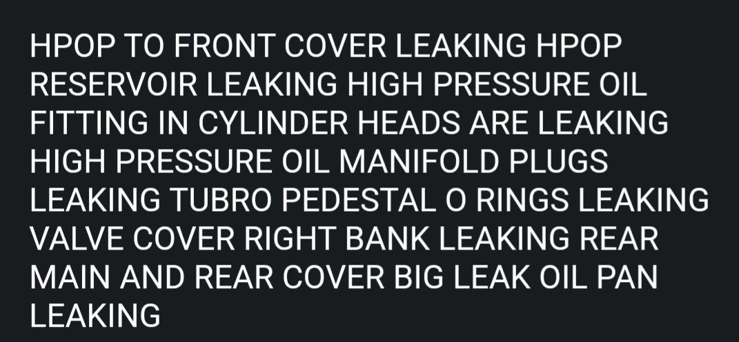

My oil leak has just been resolved. I had numerous locations leaking including the oil pan. To fix the oil pan leak required removing the engine. That required lifting the body to remove the engine. Since we went that far, I replaced the body mount bushings and the fuel tank sending unit. All of the engine exterior components were replaced except the turbo.
I’ve learned that leaks are common on these engines. For transparency, I had a local shop do the repairs as I don’t have the expertise, tools, or place to do repairs.
So far she’s been drip free since April 3.
