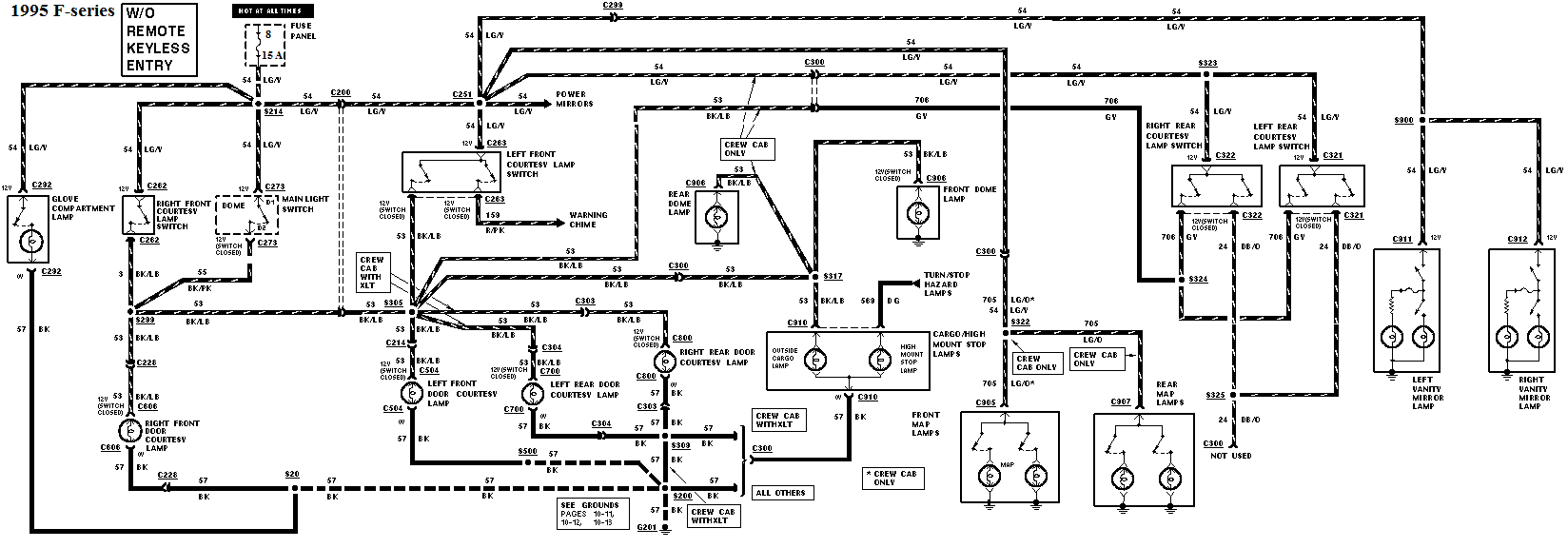

From the link provided above:
Originally Posted by subford
Here is the 1995 F-seres Diagram, Click on it and then click on the + to enlarge:
Attachment 285319
If you click on the attachment it will display larger.

If you look at the diagram, you'll see 2 major color coded wires.
Light green with a yellow stripe and black with a light blue stripe. They power all your curtsey/cargo/interior
Those wires are going to be "hot" almost ALL the time. Anyplace you see one of those blue clips on one of those wires, it's feeding power to some Non-Ford item.
I'd strongly recommend popping those little clips off the factory wires & wrapping a small piece of electrical tape around the "wound".
