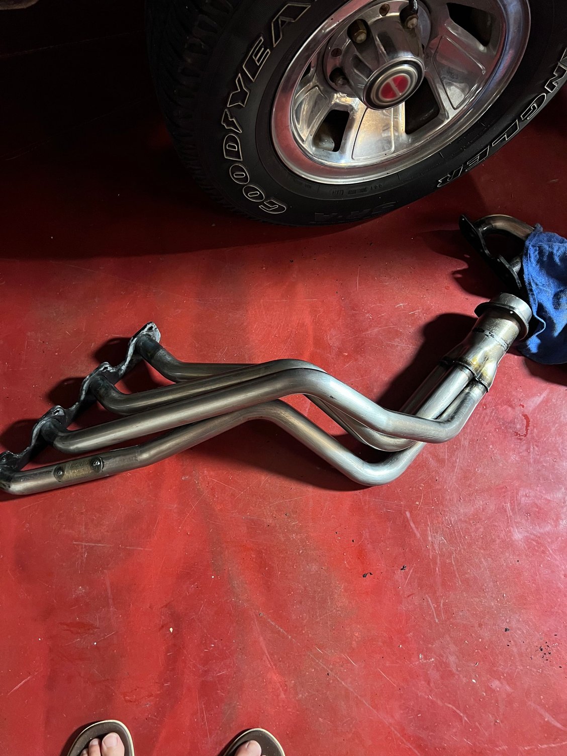

got some hedman fenderwell exit headers and it comes w/ protective temporary paint meant to be burned off.
trying to do this economically, so probably not going to media blast and cerakote these.
how do i best get the temporary paint off before applying a high heat spray on paint?
do I install the headers, run the engine for a while, then remove and repaint?
brush on some paint stripper, rinse, and repaint?
wire brush the coating off?

tried dot 3 brake fluid first...no luck. took off some of the paint but clear that it wasn't going to work.

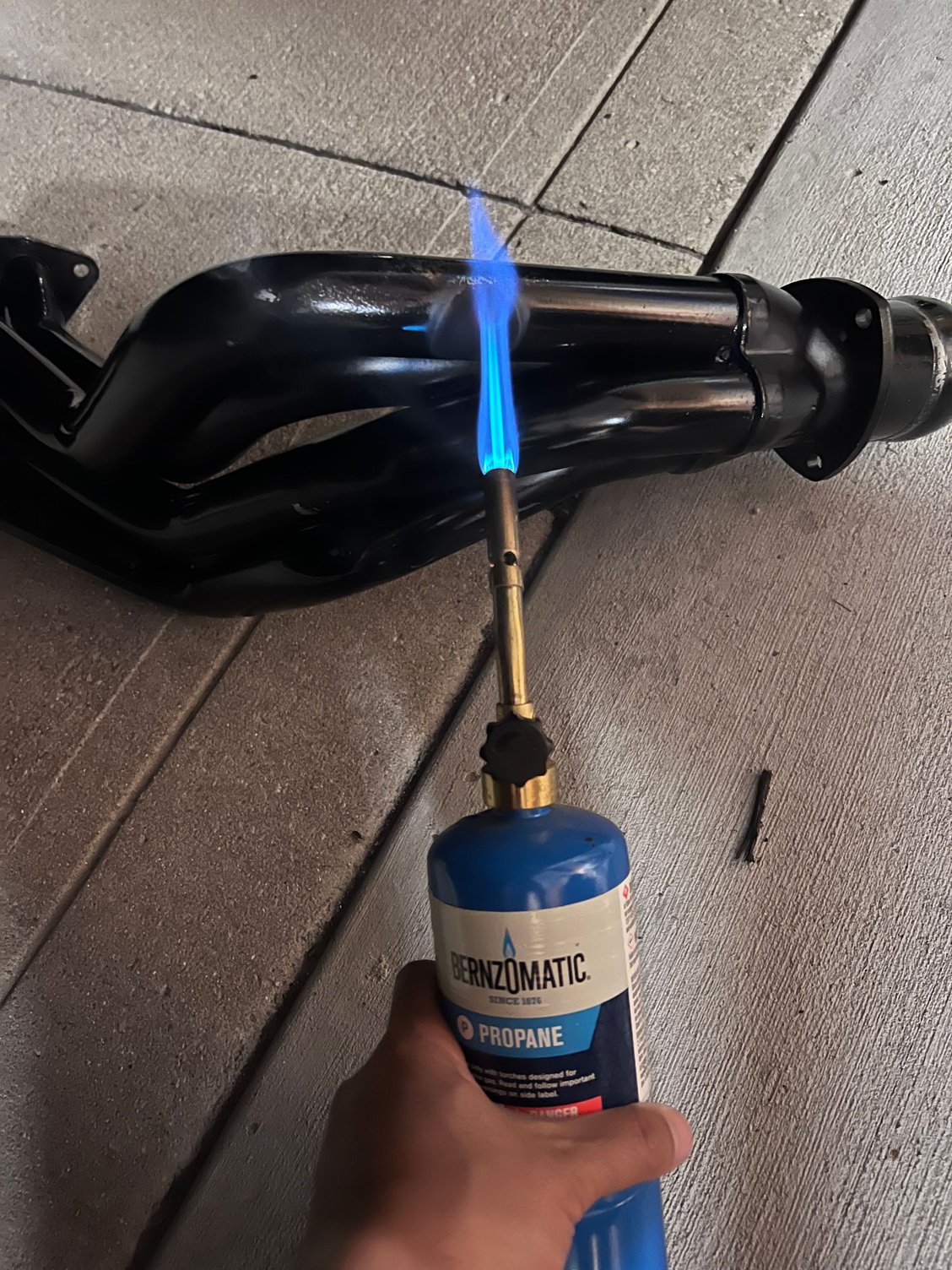

then tried torching an area. took at least 3min w/ the torch in the same spot before paint burned off (I know, yellow torch burns hotter, but blue is what I had on hand).
finally used a citrus paint stripper, painted on, let sit for 24h, then scrubbed most of the paint off w/ a rough scotch brite pad.
as expected, started rusting right away, so put a layer of brake fluid on again until i'm ready to paint.
will clean thoroughly w/ brake clean and acetone just before painting.
also lots of nooks where I wasn't able to get to the paint that i'll likely try burning off w/ the torch.
