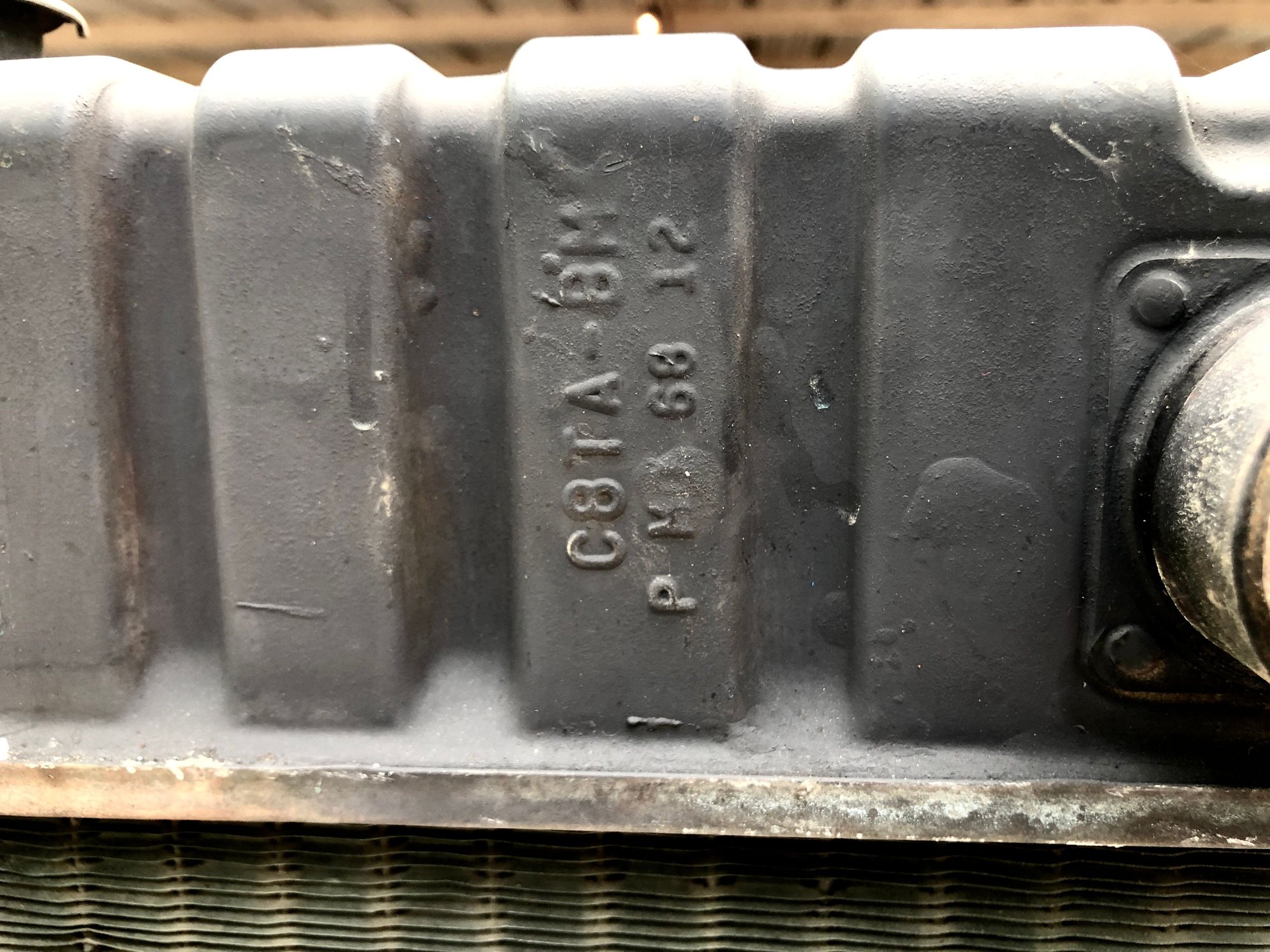

When I found a drip around the trans cooler line fitting I pulled the radiator and was going to take it to a shop. The closest decent shop is about an hour or more away, and I’m beginning to wonder if they can do much with the original one I have. I’ve posted some pics of it - including the id stamped on it. It is about 29.5 X 26.5 and looks to be a 3 row.

This ID number looks like C8TA-BM = C8TZ-8005-B .. Radiator ~ 26 1/4" wide x 19 3/4" high = 1968/72 F100/350 360/390 Use with xtra cooling and A/C

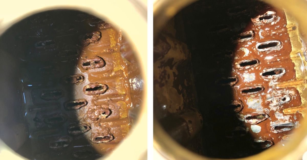

Flushed the radiator with POR 15. Cleaned it pretty good. Going to try and remove some scaling next.
Might try my hand at brazing the spot that has a drip around the transmission fitting. Then find a way to pressure test it on the bench.

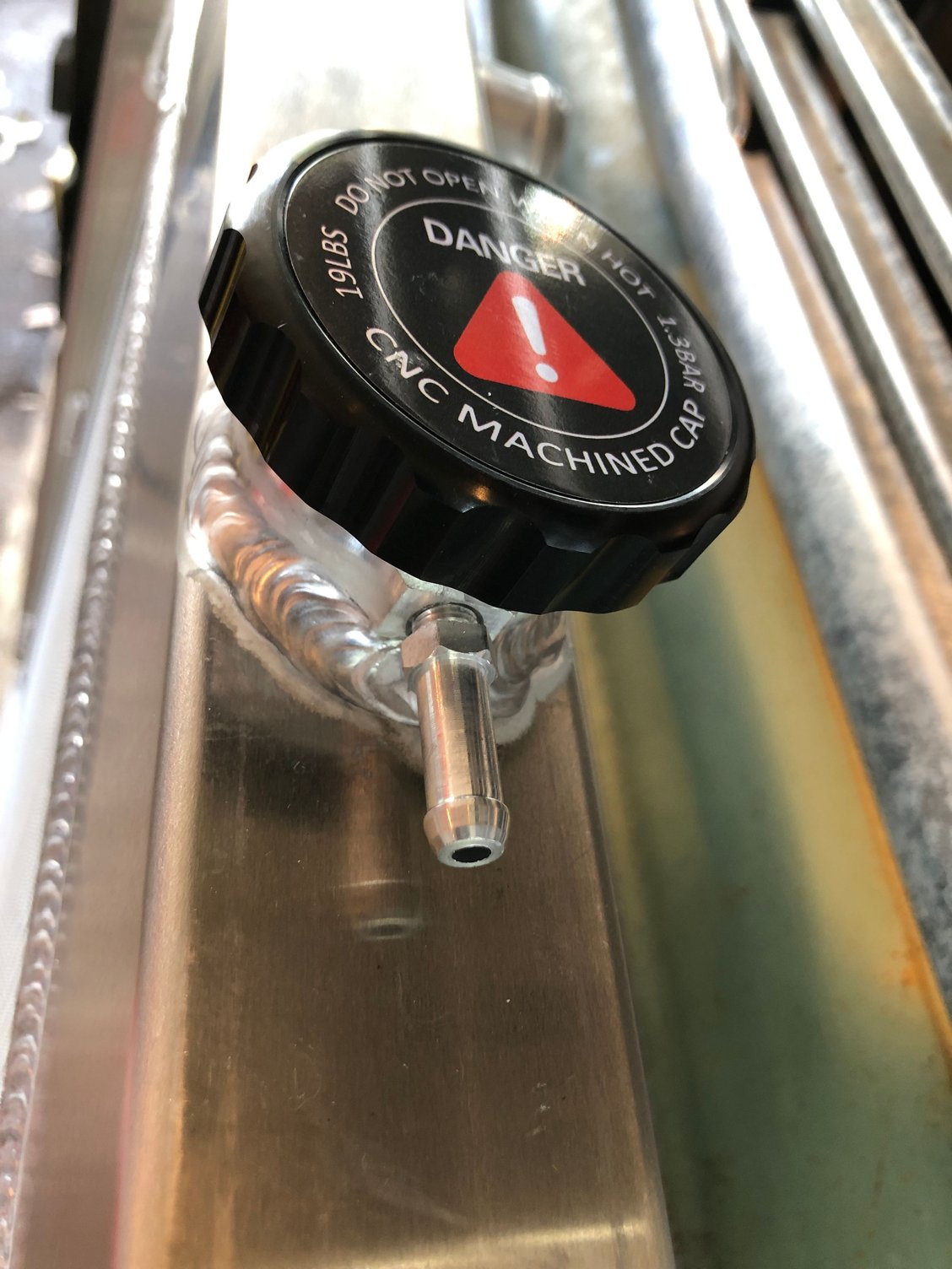

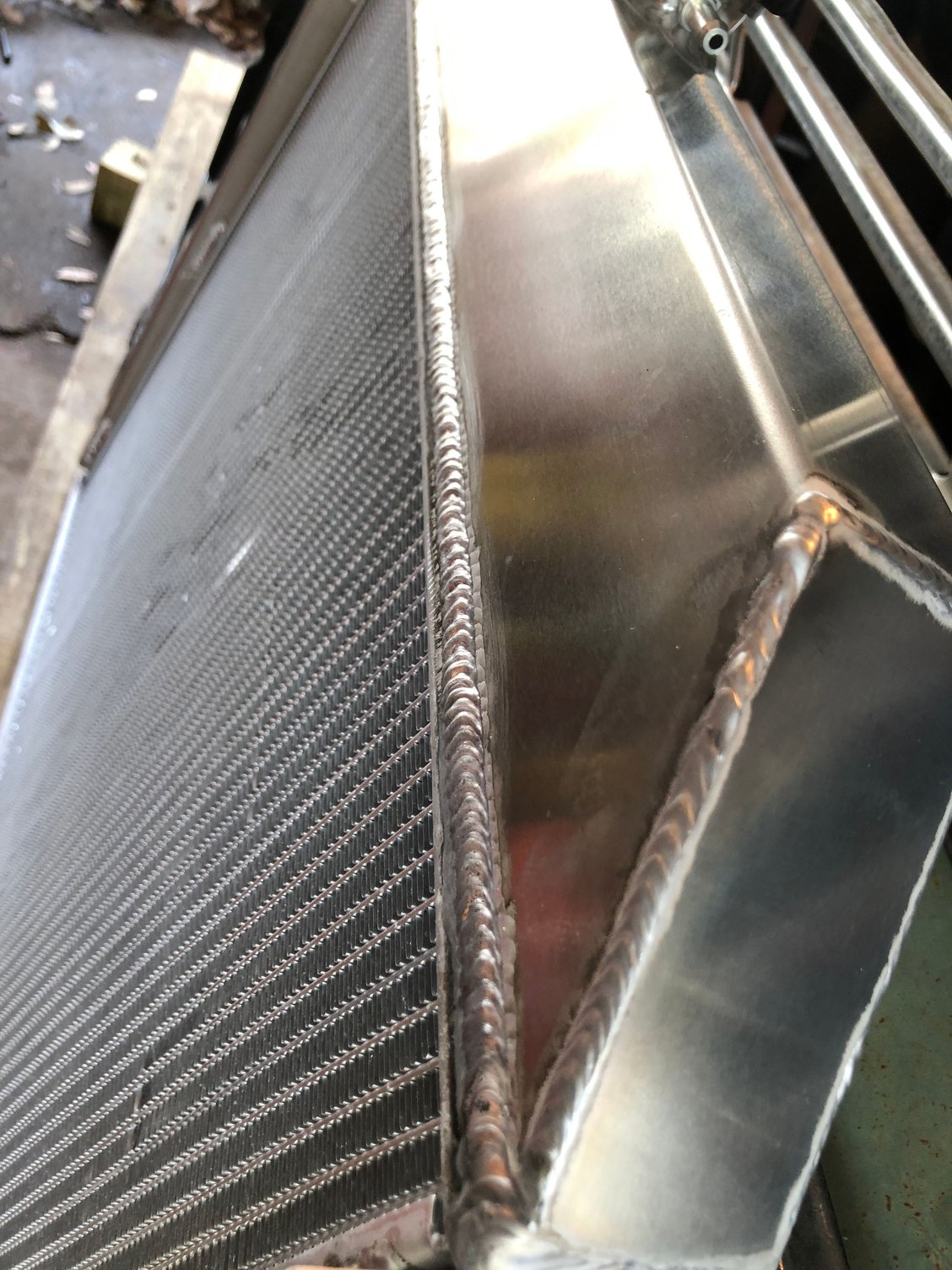

The Aluminum replacement radiator was delivered and appears to be a very close match when compared to the original. Looks like it will sit a little lower when comparing the bolt holes.
No damage when delivered. Seems decently constructed, but no way to tell if it will hold the pressure until later. :-)
The fittings were the correct NPT. It arrived with hose fittings, which I’ll replace with 6 AN.

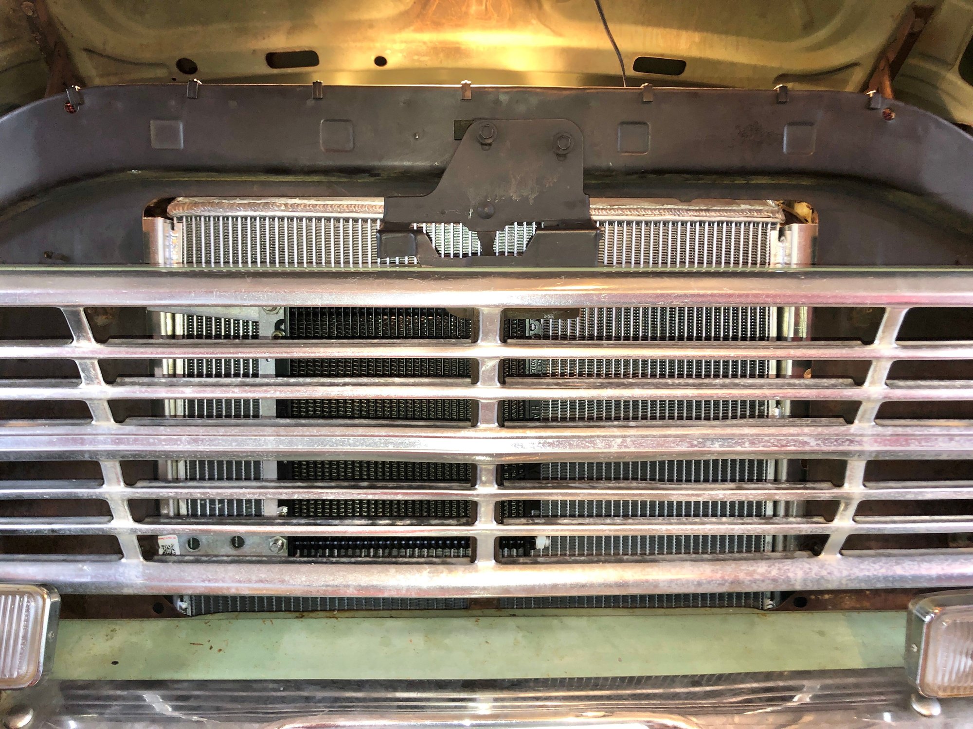

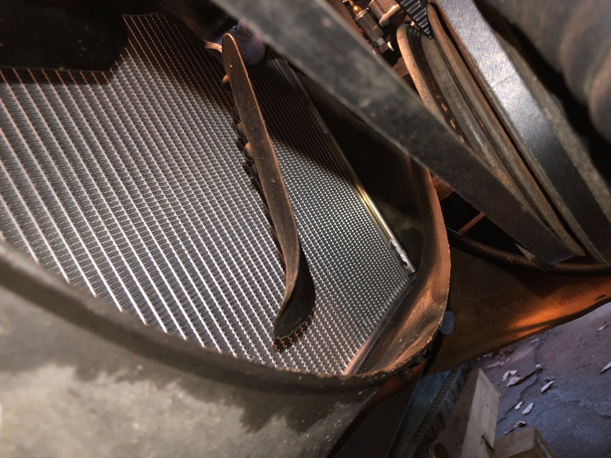

After a dry fit, I found that the front bottom edges bumped against the front cab mounts. I had to trim the corners so it would snug up to the radiator railing when bolted.
I bolted the radiator in place, zip tied the shroud to check position and clearance, and everything looks good. Checked fan clearance/centering etc.
When bolting on the radiator, I came away from the passenger side with HD hardware to mount my Hayden HD Aux trans cooler in front of the radiator.
I’m hoping to have the original radiator revamped, but in the meantime this one will do.
Next - hook up trans cooler lines, engine radiator hoses, and finish wiring the trans fluid pressure and temp gauges. (A transmission overheat was what brought me down this rabbit hole to begin with.)
