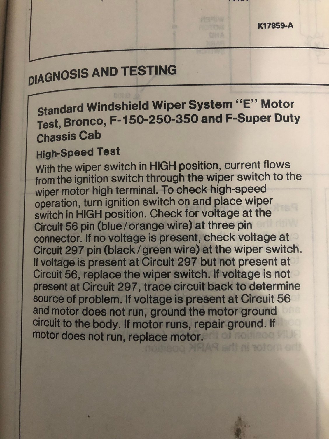

According to the 1992 FSM, yes, there are two quick tests.
BTW, the FSM is not perfect, and this is a good example. Top picture appears to be info that was mistakenly left in from the previous model year.
That I could find, there is no discrete test for the governor- they do have very specific instructions for testing the MFS and the motor, so I guess the process is to eliminate problems with those two components, then the wiring, then assume the governor is defective.
Manuals aside, my experience is that the washer pumps and the wiper motors fail often on our trucks- so it's not implausible that you just have a bad washer motor and a bad wiper motor. I would test those two things first.

Solanum, thank you for the tech page. Easy to follow, other than I didn't have a a Black/Green wire at the switch. Didn't really matter as the Blue/Orange tested fine.
Given these tests/investigations, I am still leaning towards a Wiper Governor/Control Module being the issue. As much as I hate to, as I've looked around 1. at the scarcity of them, and 2. the prices!
