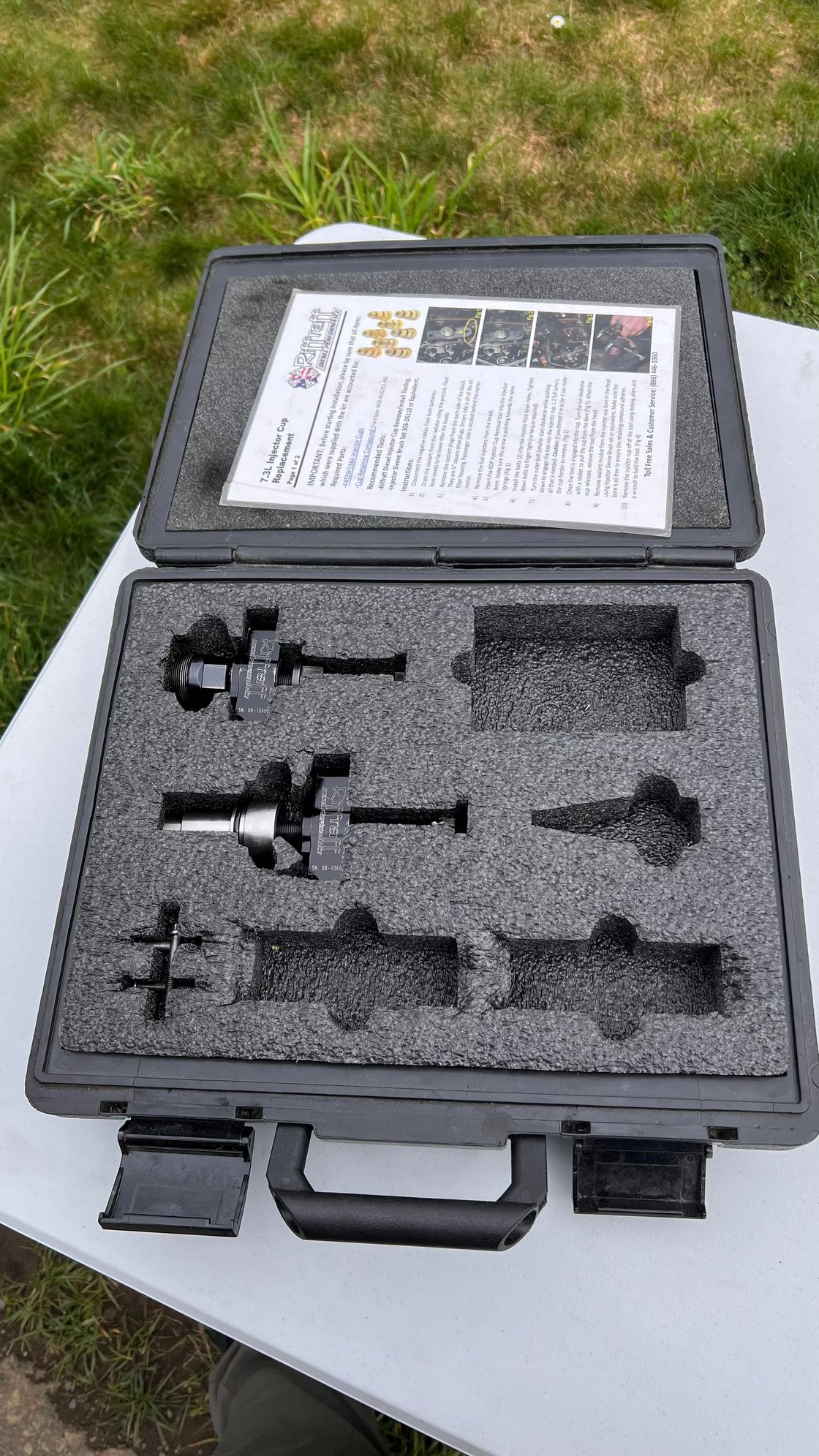

I just got done replacing all 8 injector cups after chasing a fuel-in-coolant issue. That was a tough job! But RiffRaff tool made it bearable.

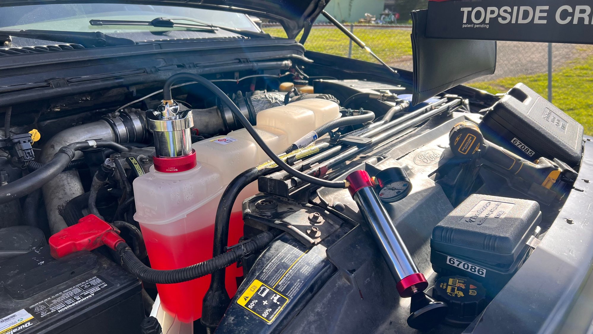

I wanted to pressurize the system to check for leaks before driving it far from home. Glad I did!

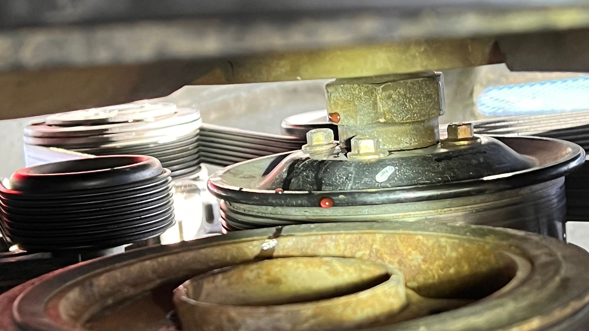

I found a very small, drip leak from the fan shaft at the water pump. Is this the actual water pump leaking or something behind the fan shaft?
At this point I had it pressurized to 16 psi and it dropped to about 15.25 psi over 30 minutes and had the small drip noted in the above picture.

I would think it would leak behind the pully?

Yeah I thought so as well. Usually I’ve heard of the gasket around the outside of the pulley failing. That would be pretty obvious.
I’ve ordered a new water pump anyways.
Just weird to see it drip from the shaft like that only when pressurized via a pressure tester…
I drove it ~75 miles yesterday and didn’t have any trace of coolant leak.
