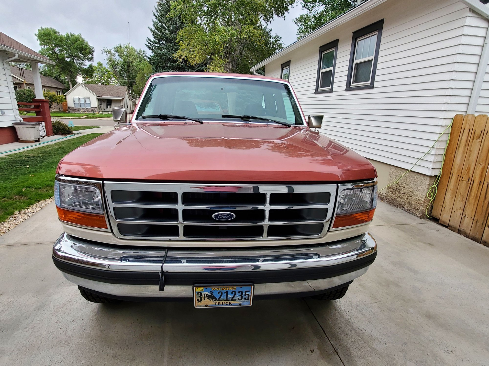

Originally Posted by shelbygt500_653hp
Great idea !
Also just ordered a new front grill and chrome headlight covers. Will replace the old ones.
‘’don
Good idea, did the same. Found everything on Ebay as I wanted oem.
