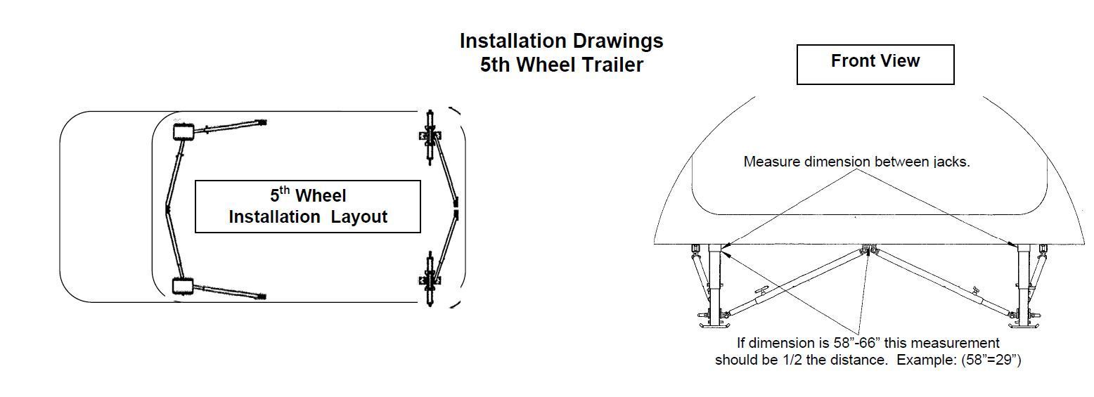

thanks for all the info. I found a little more info of strong arms vs steady fast - the strong arms in the rear are front to back. The steady fast is side to side.
this solidifies the steadyfast for me since the side to side wiggle is the major problem. The front brace and my x chocks will be enough for any front to back motion.
Thats not how my instructions read. The swing bolt that attaches to the jack is fore-aft, but the tube is mounted center to jack. Thats why mine hasn't been in stalled, there is nothing between the frame rails to mount to. I would have to add a piece of either U-channel or angle in order to mount the tubes.
I’ll have to download the k steuctions. I don’t have scissor jacks in the rear and this is what I’ve seen install-wise for the StrongArms (pics in thread)

Our 5th wheel has the two landing gear legs in the front and two scissor jacks in the rear. I bought two extra Steady Fast bigfoot feet to have all four match and have a wider footprint at each contact point. As mentioned before, there are three stabilizer legs and three large wing nut style hand turns.
The stabilizers are on our checklist, which we ALWAYS run through before moving the camper.
There is still a bit of movement because the trailer is sitting on the tires, but 90% of the "wiggle" was removed with the Steady Fast stabilizers and the step stabilizer by Lippert.
I wanted something that was as automatic as possible and provided the most value for the cost. In my humble opinion, having three long bars is better than more short bars due to the leverage and anchoring mechanics involved. The hand clamps take literally one second each to tighten or loosen and I am off to the next task.
