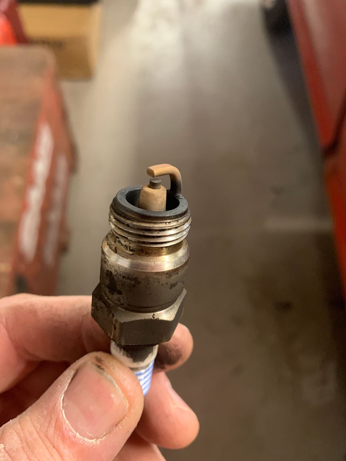

my spark plugs looks like this:
Does anyone have an idea of what might be wrong?

Your plug looks good.

Ok, so far I found and plugged one small vacuum leak, and confirmed initial timing at 10 degrees. I have checked and confirmed both mechanical and vacuum advance, they seem to work fine. Firing order confirmed correct. I unscrewed all the plugs, and they all look like the above picture, except plug number 4, which is black and sooty. I was going to check compression, but alas, my tester broke, so I will go get a new one today. I suspect however, that the compression will be down in number 4...

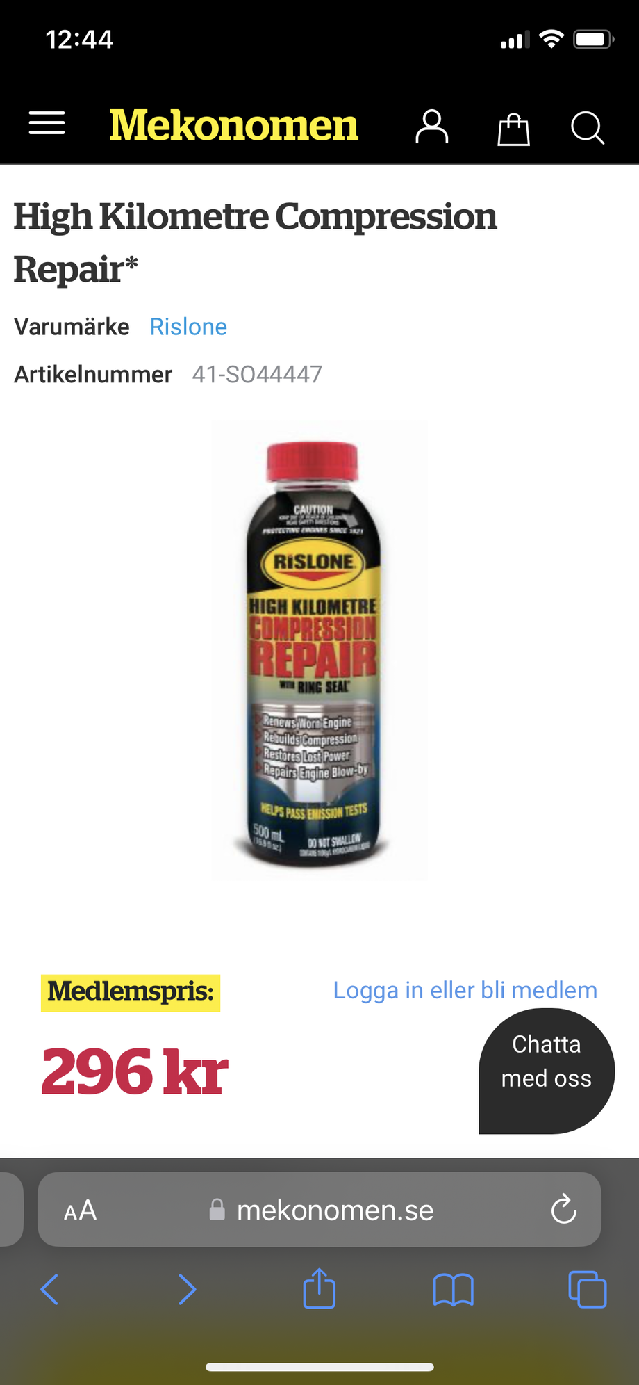

So, I put pressure in the cylinders with bad compression, but can’t hear anything leaking out the carburetor or exhaust, which makes me think it’s rings possibly… I added some miracle fluid to the oil, so I will now wait and see if that helps I guess…
