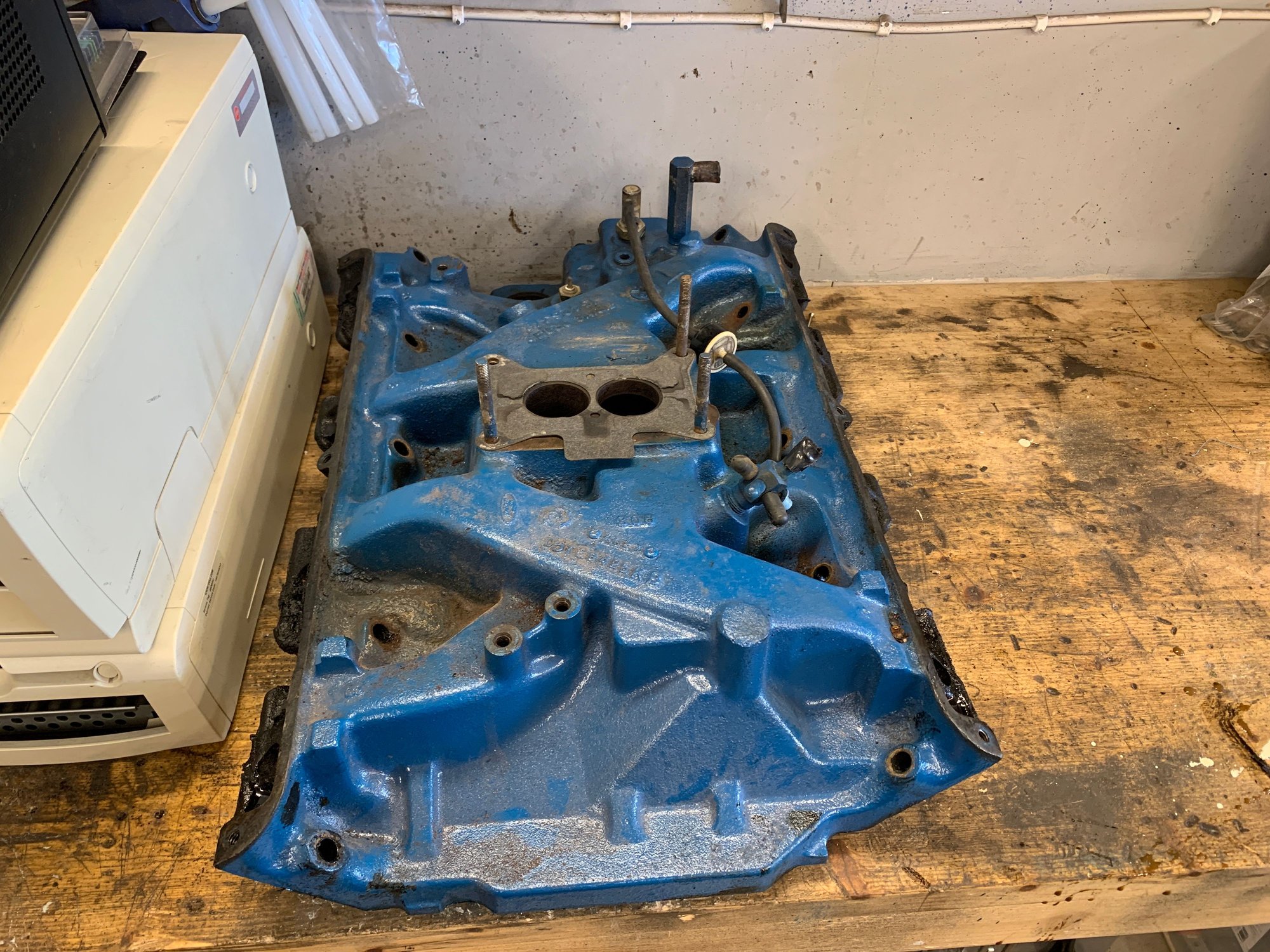

I got home from work and got right to it:
So far, so good…
And you guys weren’t kidding about how heavy this intake is!

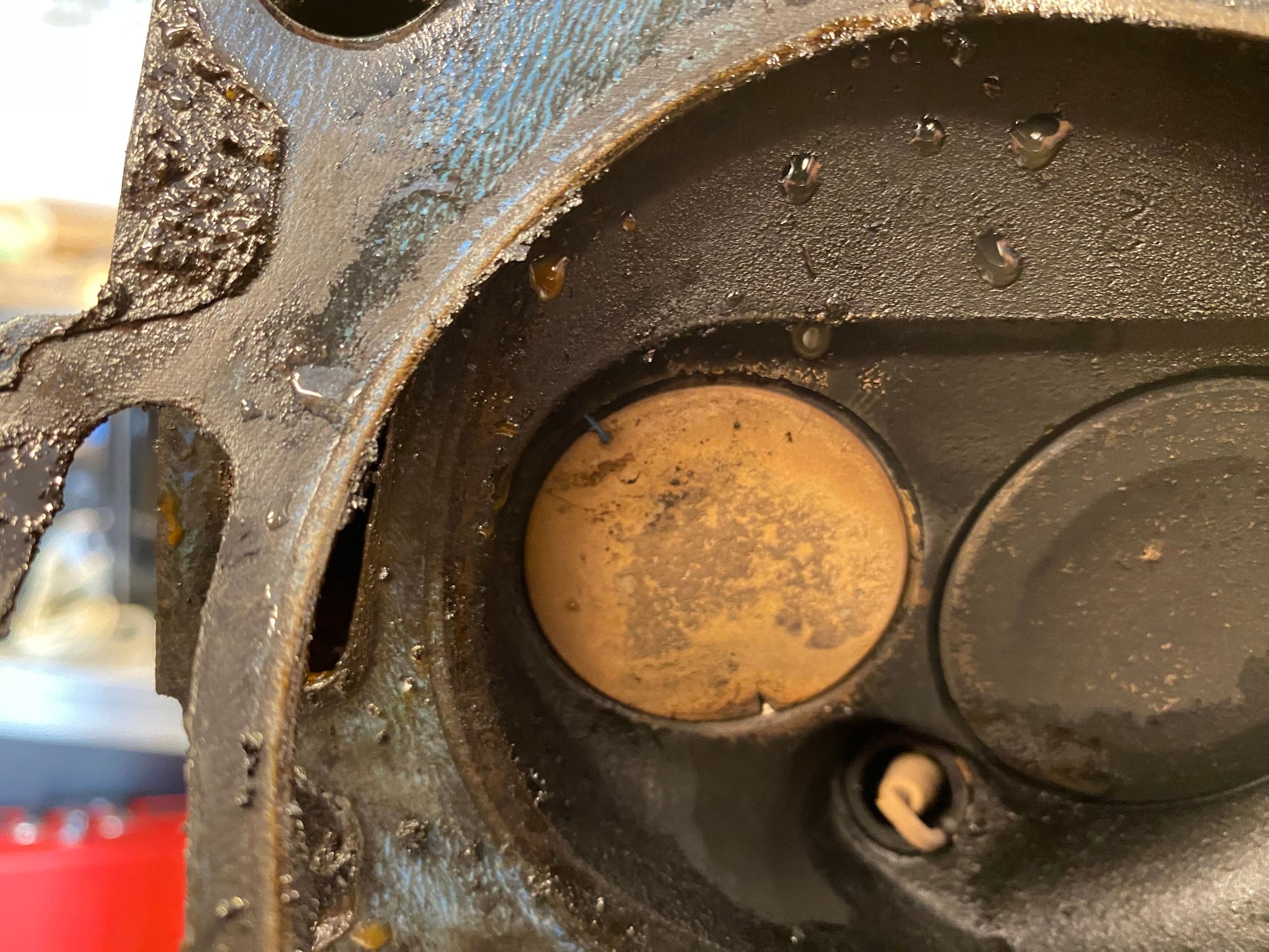

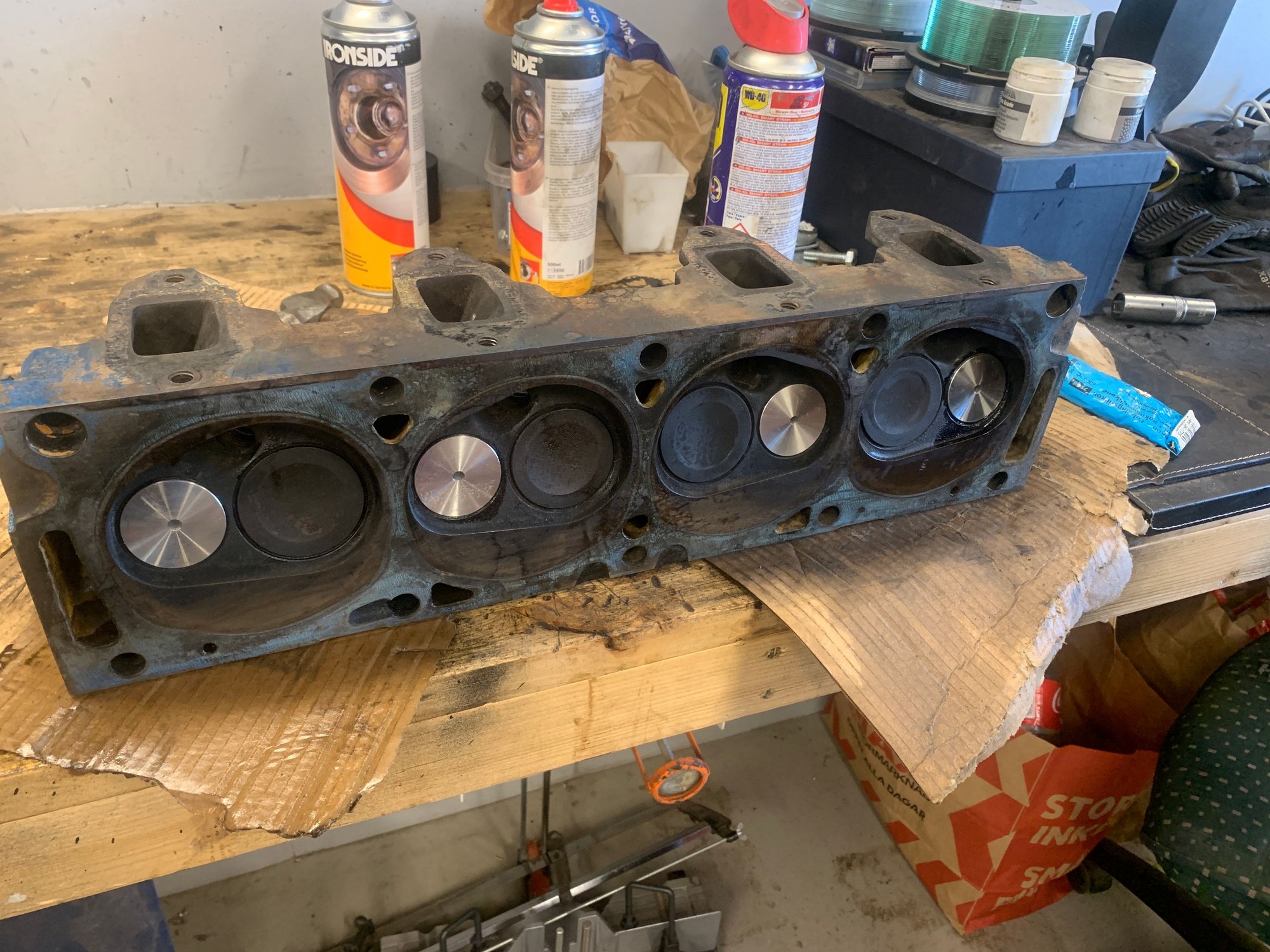

And here they are, burt exhaust valves on cylinders 1, 3, 4…
…and 8…
new valves are ordered!

Are you familiar with the process for lapping the valves?
You may want to lap the burnt ones lightly to see if the seats are distorted and should be refaced while you wait for your valves to arrive.
The blue print on the heads is typical of premium quality Felpro non-stick head gaskets.
If you do not have one I would install a quality temperature gauge and monitor the engine temperature. This many burned valves is a sign of overheating.

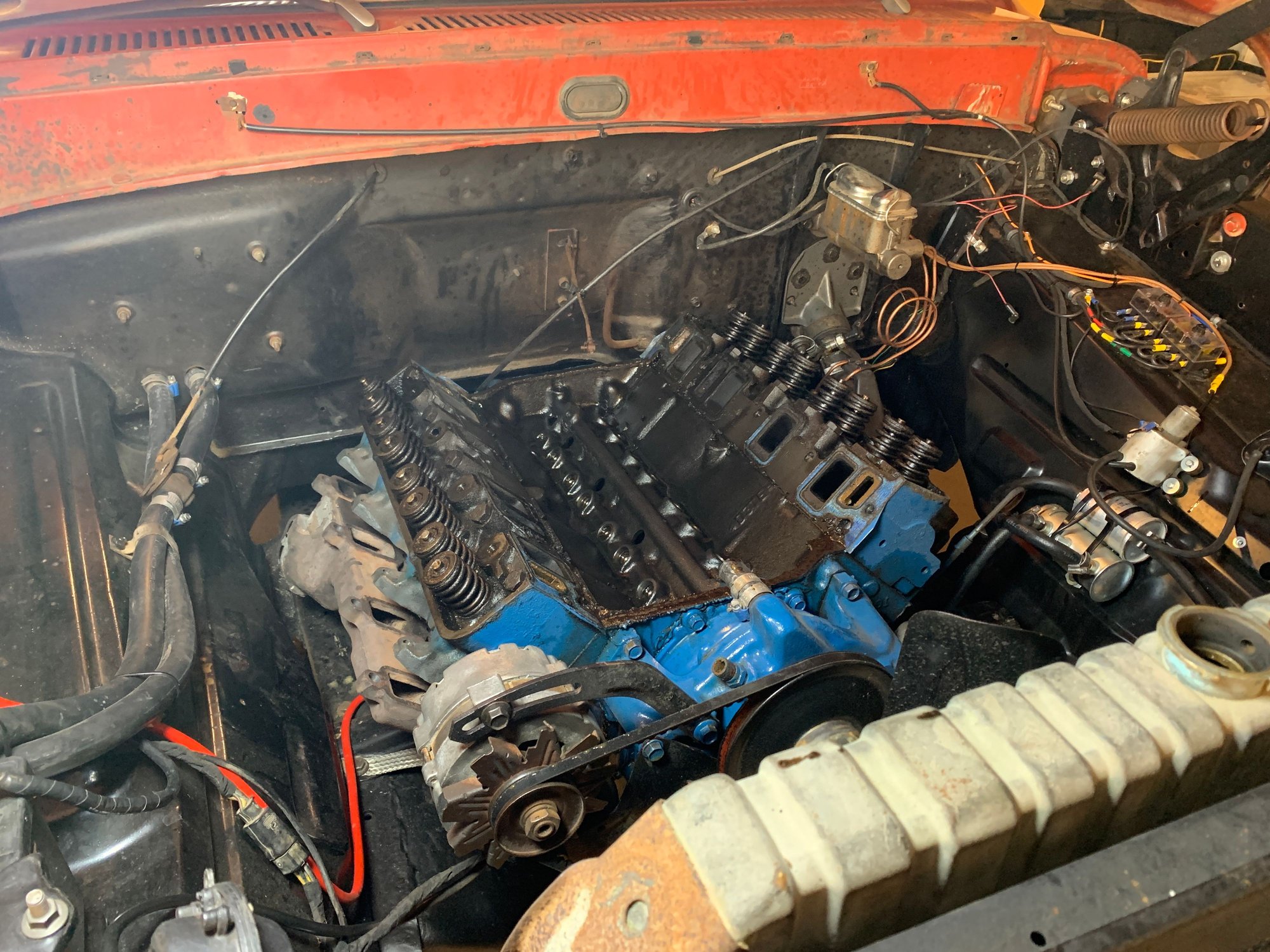

8 hours of grinding later…

Looks good.
A lot of people do not use exhaust manifold gaskets but I typically do on an older engine. Not sure if they would have come with your kit.

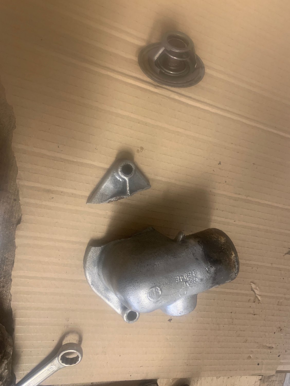

The kit was pretty complete, plus I added some installation paste to them, so they should be tight now. However, I broke the thermostat housing…
I think the thermostat slipped down a smidge, and got wedged between the housing and the intake, so when I tightened the bottom bolt it snapped the ear off of it… cr@p!

I have done this many times. I believe as the housings get old the metal deteriorates and snaps easily.
Aftermarket parts are readily available in the states.
https://www.rockauto.com/en/catalog/...r+outlet,10337
