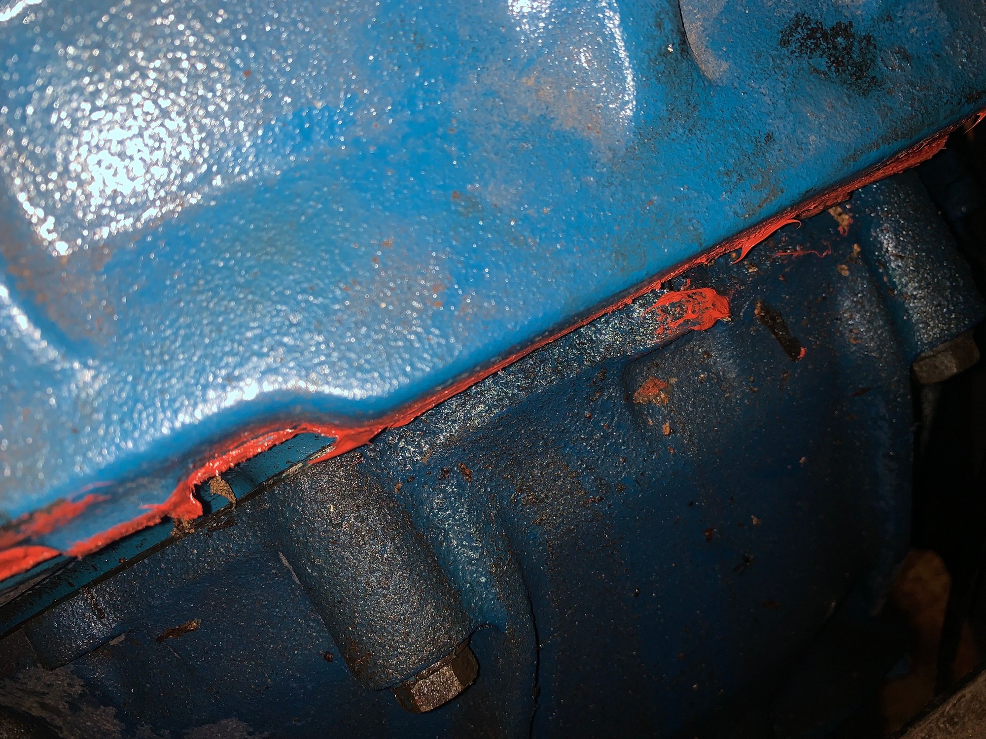

I did use the end gaskets, and glued them to the block, plus put a little bit of gasket in a tube on top, plus a “dab” in each corner.
