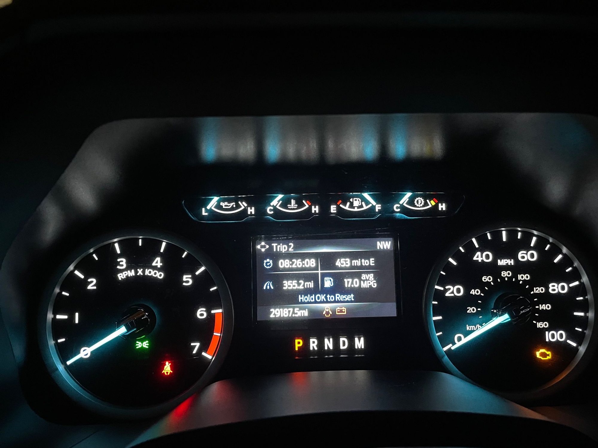

Ooooh, I missed fuel consumption, I love the fuel consumption. So it seems a bit use and rear end dependent. If you are going to tow over 15k regularly you need the 4,30 rear end IMO. Below that the 3.55 and 3.73 (F350) ratios give pretty good mpg for trucks like this. Last spring we did an empty 2 week road trip from CO to FL and back the long scenic way, 5500 miles, lots at 80+ on interstates and my truck returned 15.5 mpg. This is on 35" tall GoodYear Duratracs big block F350 3.73,.4x4 and not running slow.
Around home in the summer I see 16-17, in the winter more like 13-14. Towing the gooseneck with my old F250 on it to Kansas was 9.5-10 loaded, 11 coming home empty. This 7.3 10 speed truck is getting 3-4 mpg better than my last steel body 6.2 3.73 six speed auto truck. No complaints on fuel mileage from me
