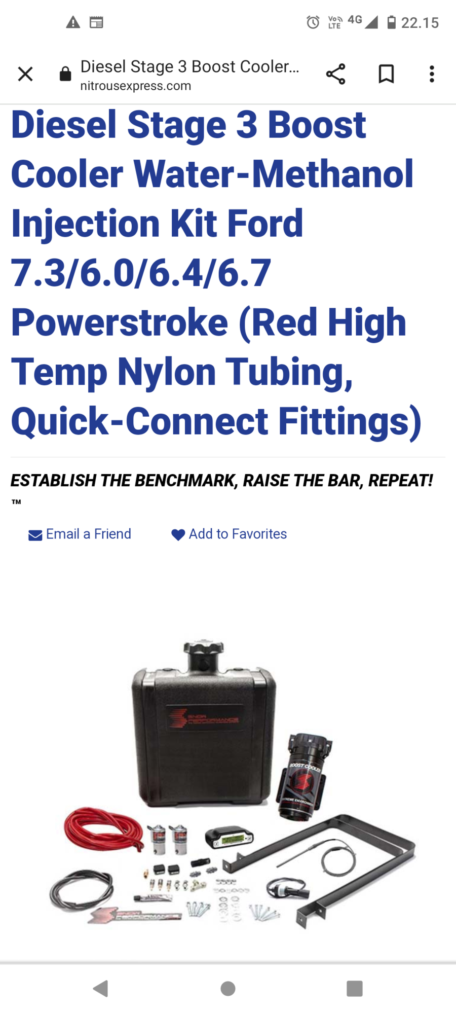

FinnishStroker's Avatar
FinnishStroker
Joined: Mar 2019
Posts: 2,907
Likes: 788
From: Kinnula,Finland
https://www.nitrousexpress.com/Diese...lon-Tubing.asp
