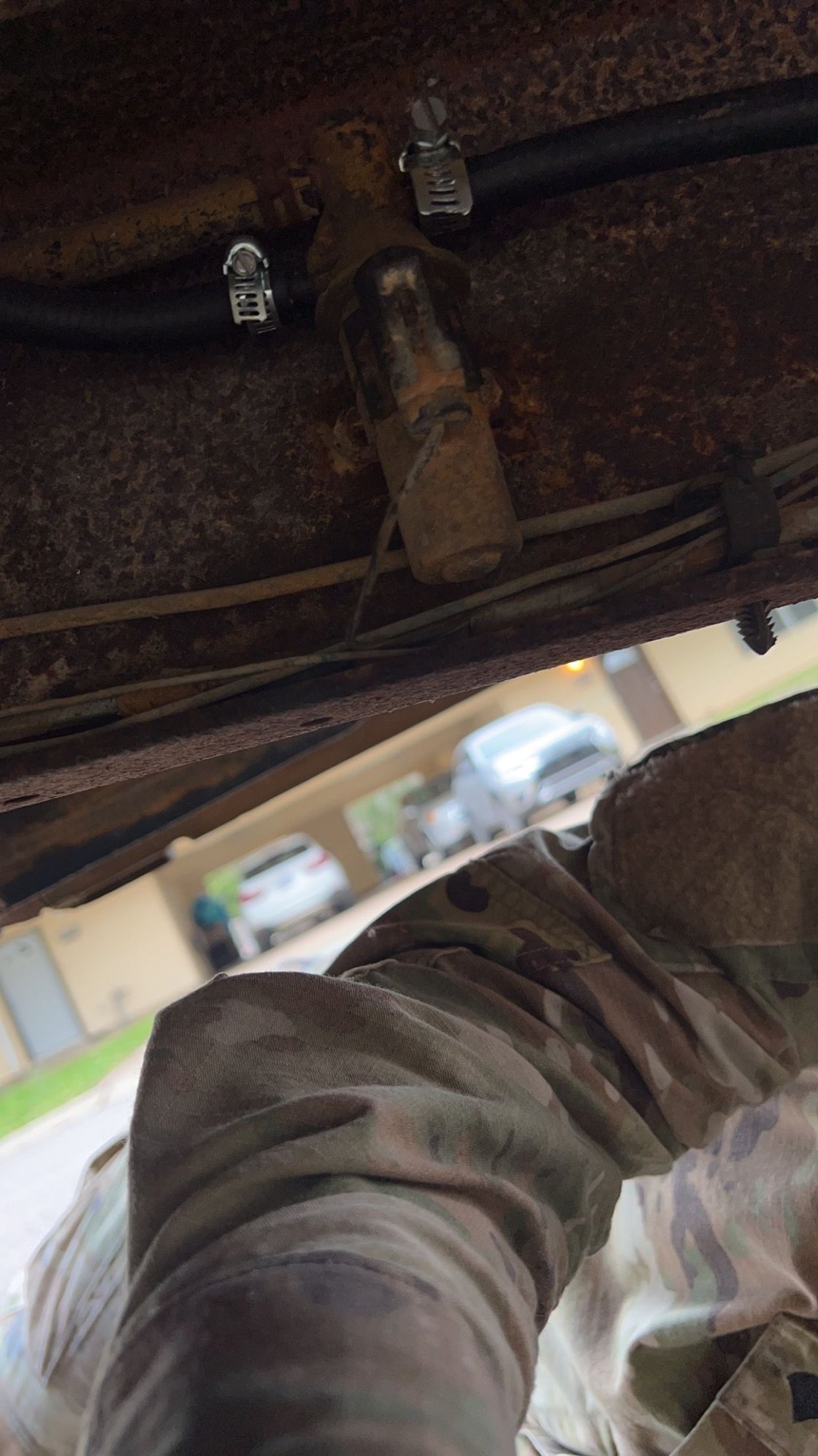

3651w 95 guy what dose your switching valve look like?
Is it a 3 port valve with 1 wire going to it or something different?
What ever you have you (I would) move that pump or a new electric pump to just after (starting from the tanks) the tank switching valve so it is a little closer to the tanks and hope it stays more wet than up where it is at now.
Just my .02
Dave ----
Yeah the pump is right next to the washer fluid and it’s underrated anyways. Pretty sure it’s the three port 2 in and 1 out with a wire, not at the house atm. I’ll get you a pic when I get home

This is the fuel tank switch
