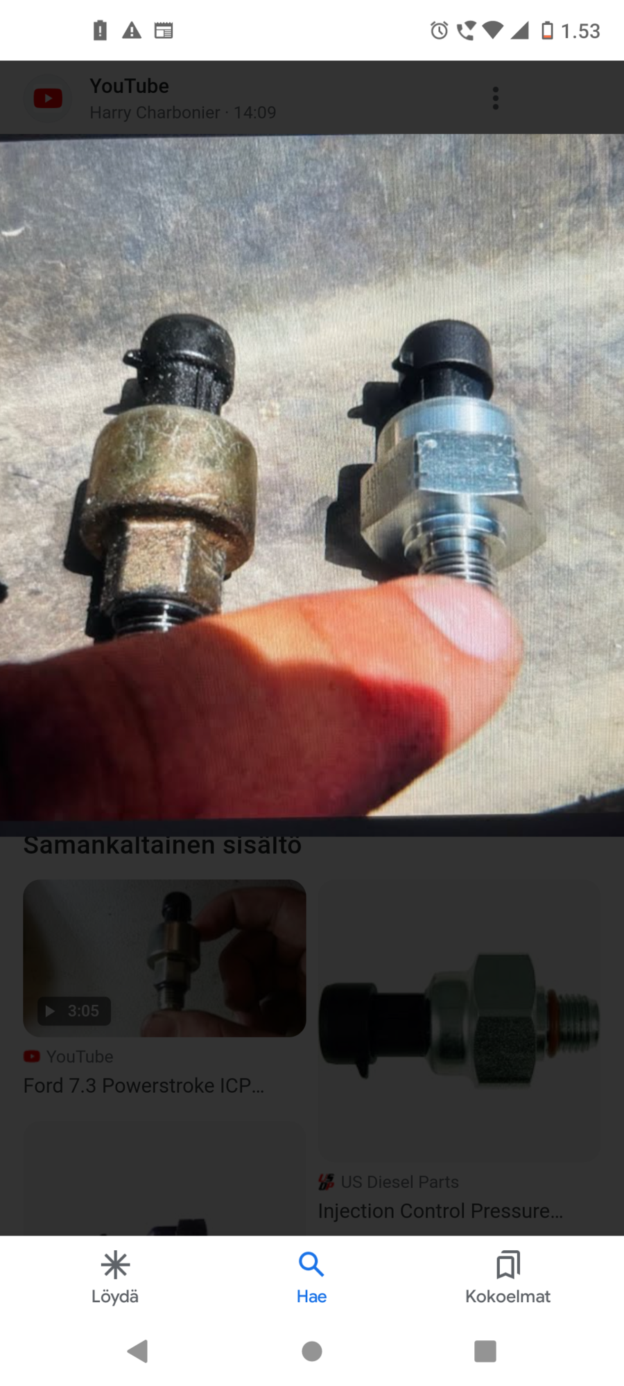

Take a closer look. OEM sensor left and modern design sensor right.
I recommend to buy new Motorcraft ICP from reputable seller and keep the old working sensor in the glovebox.
I had 500k in my OEM sensor when i replaced it after injector swap.It was working,had to change it during chasing Idle issues.
