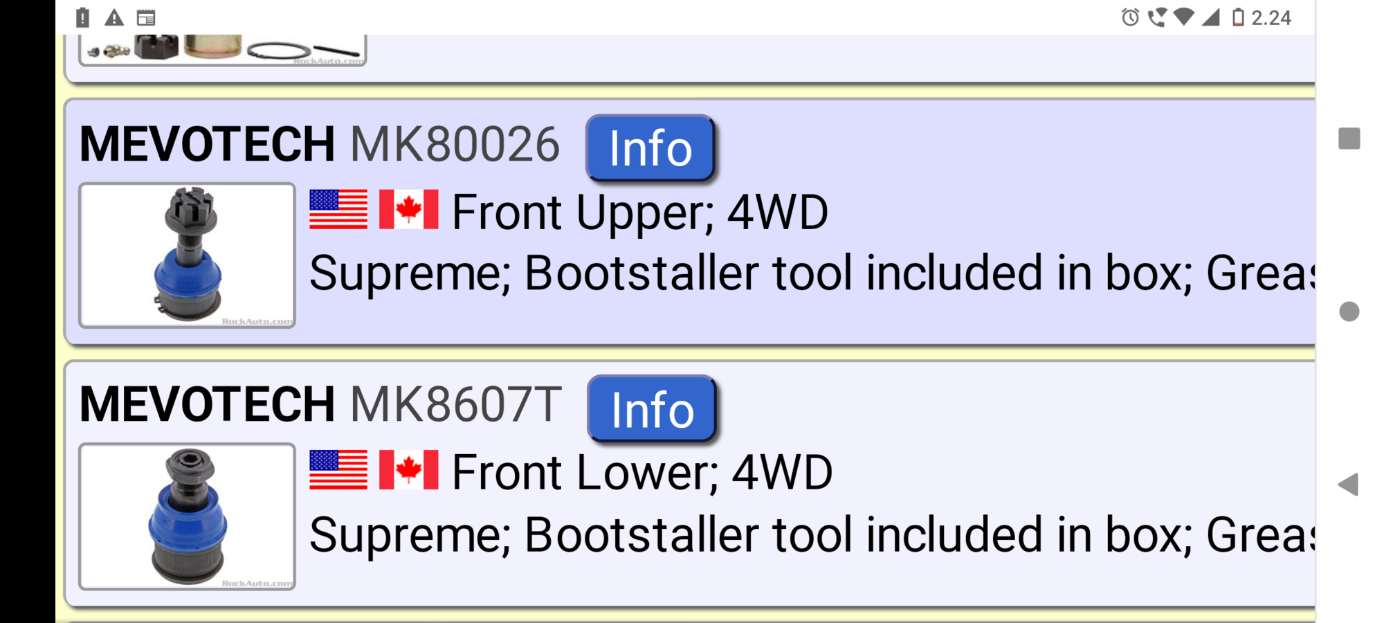

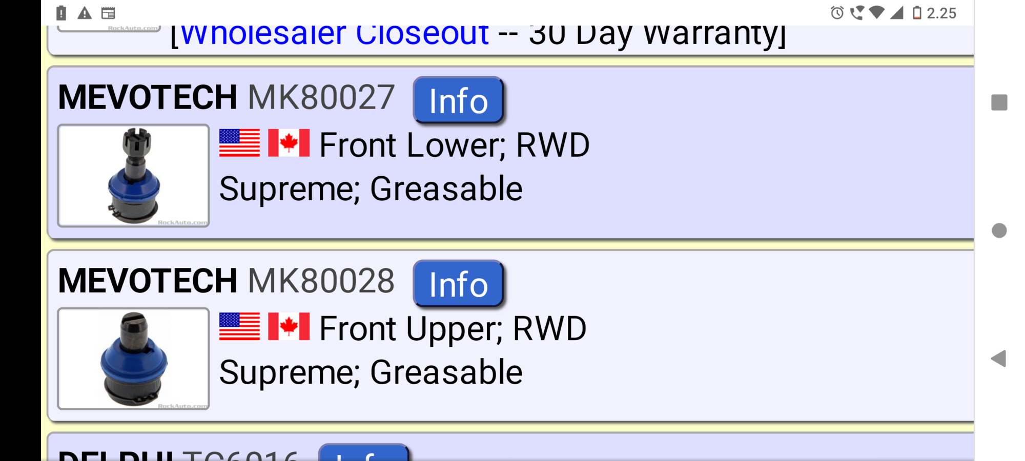

So you have a 2wd?
Let's take a look:
Your kit
Ball joints in that kit
4wd
2wd
Ball joints in that kit does not fit in 2wd.
