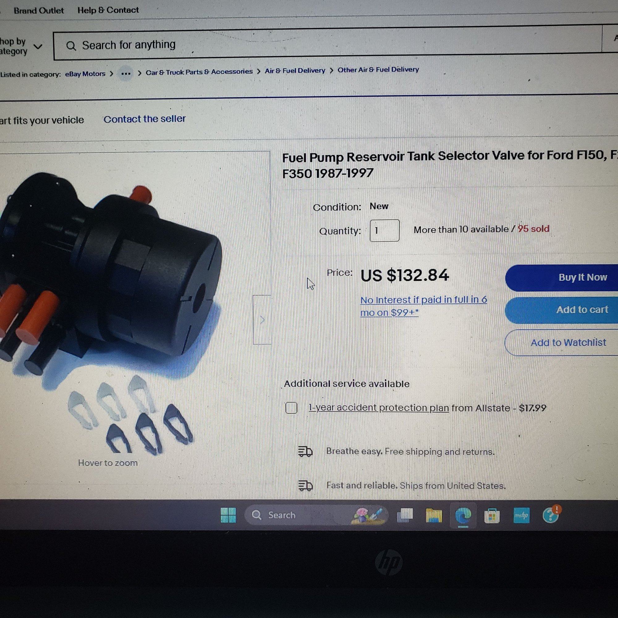

Both of your in tank pumps should put out 40 lbs
Check the pressure out of both at the crossover valve and then at the fuel rail
Should have 40 lbs both places, both tanks, until the regulator takes over
If you have 17psi out of both tanks, all of the sudden, your crossover valve may be at fault
That is why you want to check the pressure on both sides of that valve (thru a new fuel filter up front)
At least you can still get a new crossover valve for the newer ones 1990+ like yours
I doubt both tank pumps failed at the same time
It is common for the rubber hose on some of the in-tank pumps to fail and cause low pressure

There is no "crossover valve" in the fuel system of a 90+ gas pickup, in fact the only thing inline between the tanks and engine is the fuel filter.
The FDM inside each tank contains check valves the are supposed to prevent crossflow between tanks, but these get contaminated and leak and some replacement modules apparently don't contain check valves or have poorly designed valves that don't work, and that results in the active pump filling the other tank and low fuel pressure problems.

Consaki
How do you suppose the gas got back to the wrong tank on the ones that required the one way valve recall?
That recall was around 1994 or 1995 I believe

Only 1990 and up diesels have the selector valves since they don't have fuel delivery modules (FDM) in the fuel tanks like the gas trucks do.
