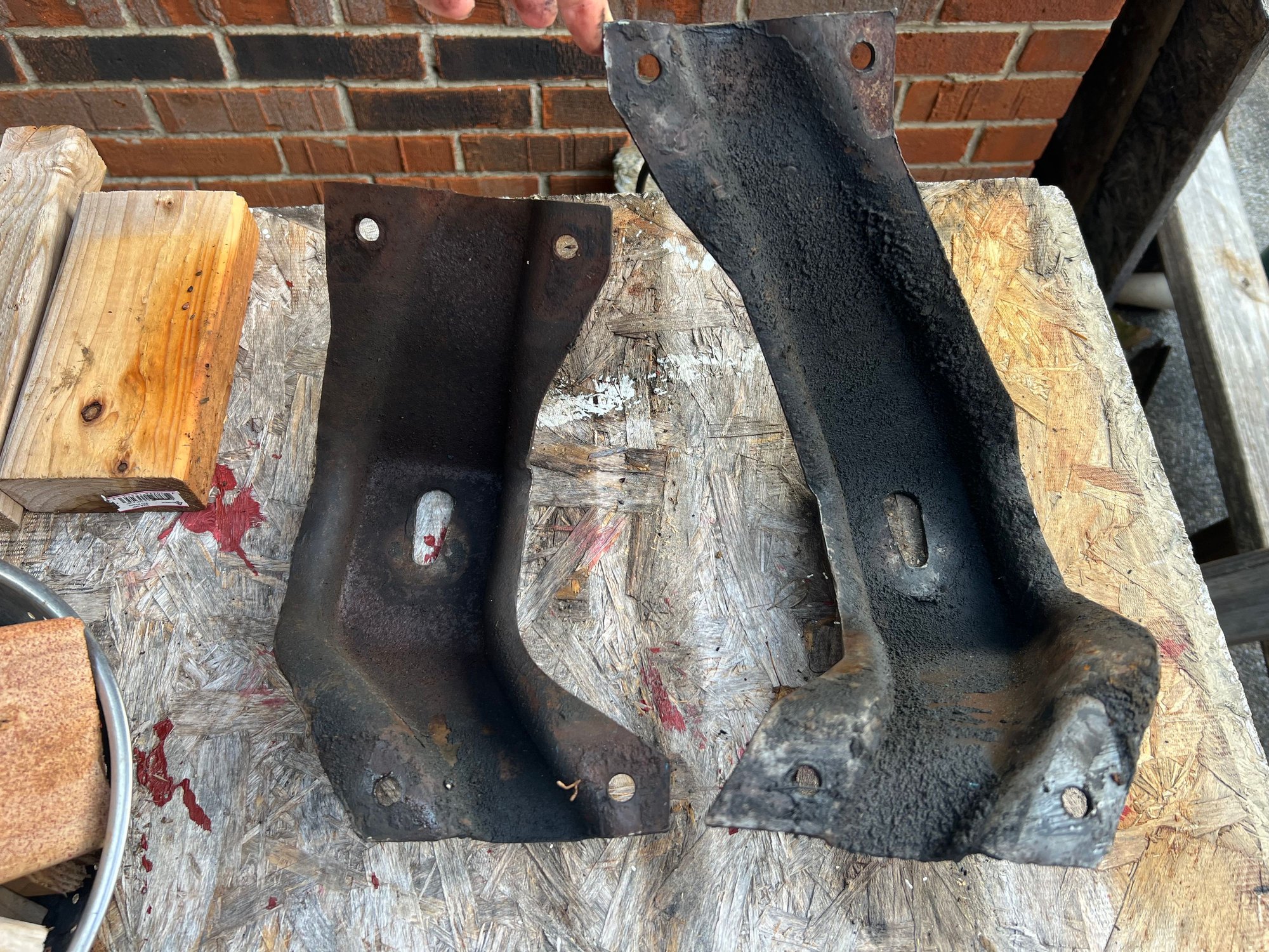

I have a 1970 f250 where someone swapped in a 351w some time in the past. looks like they kept the old FE perches in… and wrong mounts with brackets bolted on to fit onto engine.
I recently acquired engine perches which I believe to be for a small block ford… I have a 351w that sat on FE perches with makeshift engine mounts.. I wanted to put the correct engine perches and mounts… now that I’m putting the passenger side perch it looks way off… and with the new engine mount(anchor 2329) looks even more off. I’m just test fitting for now… but it looks like it’s going to be sitting way too far back towards the transmission. Like 5 inches back from where it used to be if I use the new setup. Having the engine put back in on 2 days and have to go back with the old setup or figure this out between now and then.
do I have the wrong perch? Wrong engine mount? Is there a left and right for mounts.. from what I’ve read the mounts are the same left or right.
any help appreciated. Thanks!

What are the engine supports (aka towers/stands/perches) from? Cars use different perches than F100/350, the 351W was first installed in trucks in 1981, but 1980's parts will not work on 1960's/70's trucks.
What some people do, is they use 302 perches, the 302 was first installed in F100 2WD's in late 1969.
All different engine perches are specific to right and left, but the rubber insulators for the 302 are the same right/left.
FE rubber insulators are right and left specific. I can't tell what the parts are from, there's no Ford ID number stamped on perches, but there may be on the insulators, post what you find.

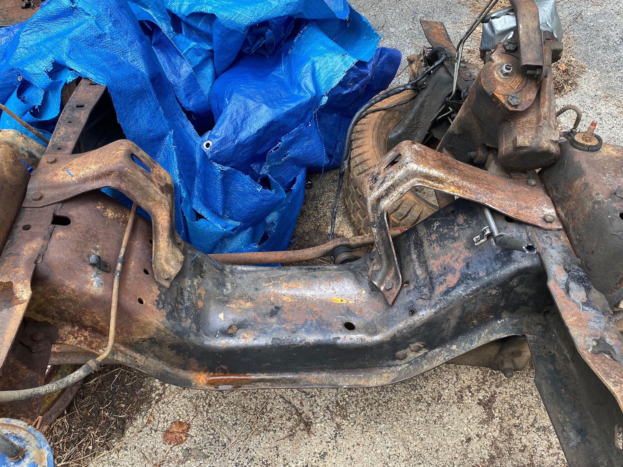

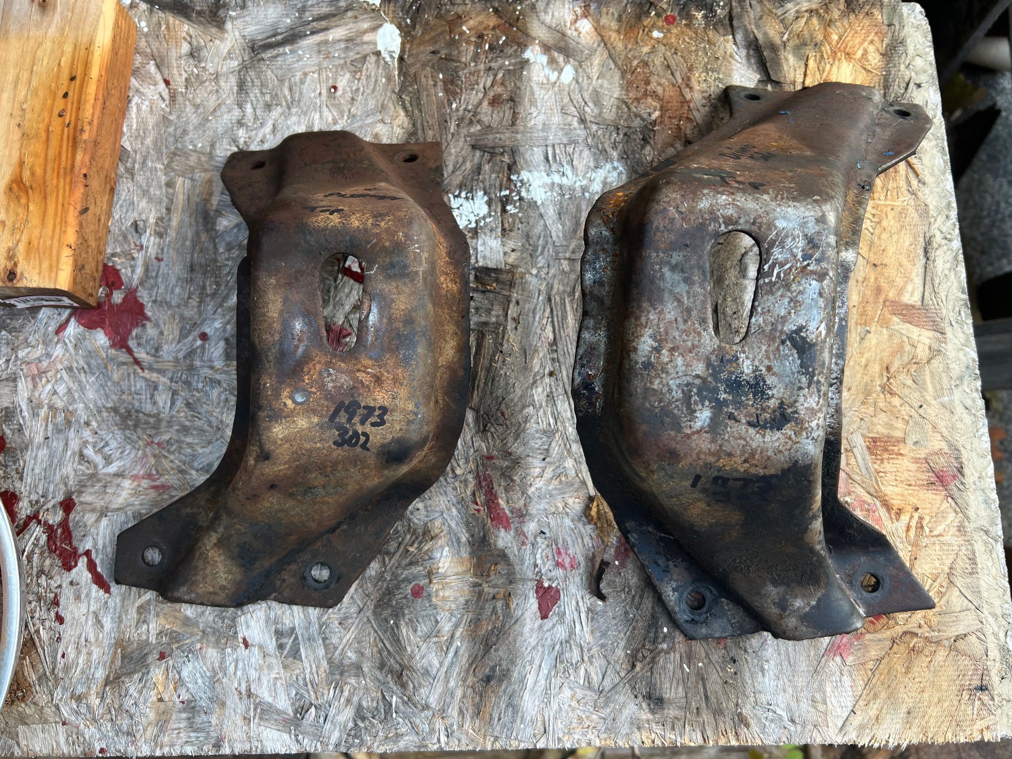

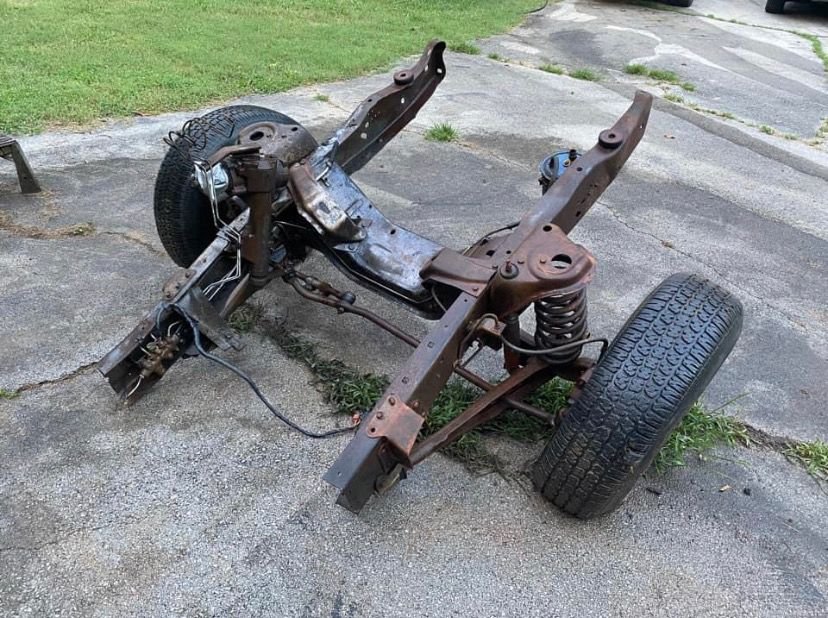

Maybe these will help. These are pictures of 302 perches on a 73 F100 frame i acquired for front disc donor parts). My understanding is that these are the same for Bumpsides and Dentsides, and for 302 or 351w.
My understanding is that these are the same for Bumpsides and Dentsides, and for 302 or 351W
OP may not be aware what these nicknames refer to.
Bumpsides are 1967/72 F100/350 // Dentsides are 1973/79 F100/350
The 302 perches are the same: 1969/79 F100 302 / 1975/79 F150 302 & 1977/79 F100/350 2WD 351M/400
No 351W's were installed in F150/350 & Bronco until 1981, 351W was never offered for F100's. These perches will not work on 1979 and older trucks
The Econoline got the 351W in 1975, but Econoline engine mounting parts will not work on F100/350 & Bronco!
thanks chirkware and numberdummy,
the pictures definitely help, they look a lot like the the ones I want to put in except mine are slight rounded at the bottom front and too right corner where the bolt holes go. Put the location and placement of holes looks the same as the ones I have that I want to put in.
the perches I acquired supposedly came off a 1977/79 2WD 351M/400 engine. I don’t know for certain but that’s what the guy thinks where I got them from.

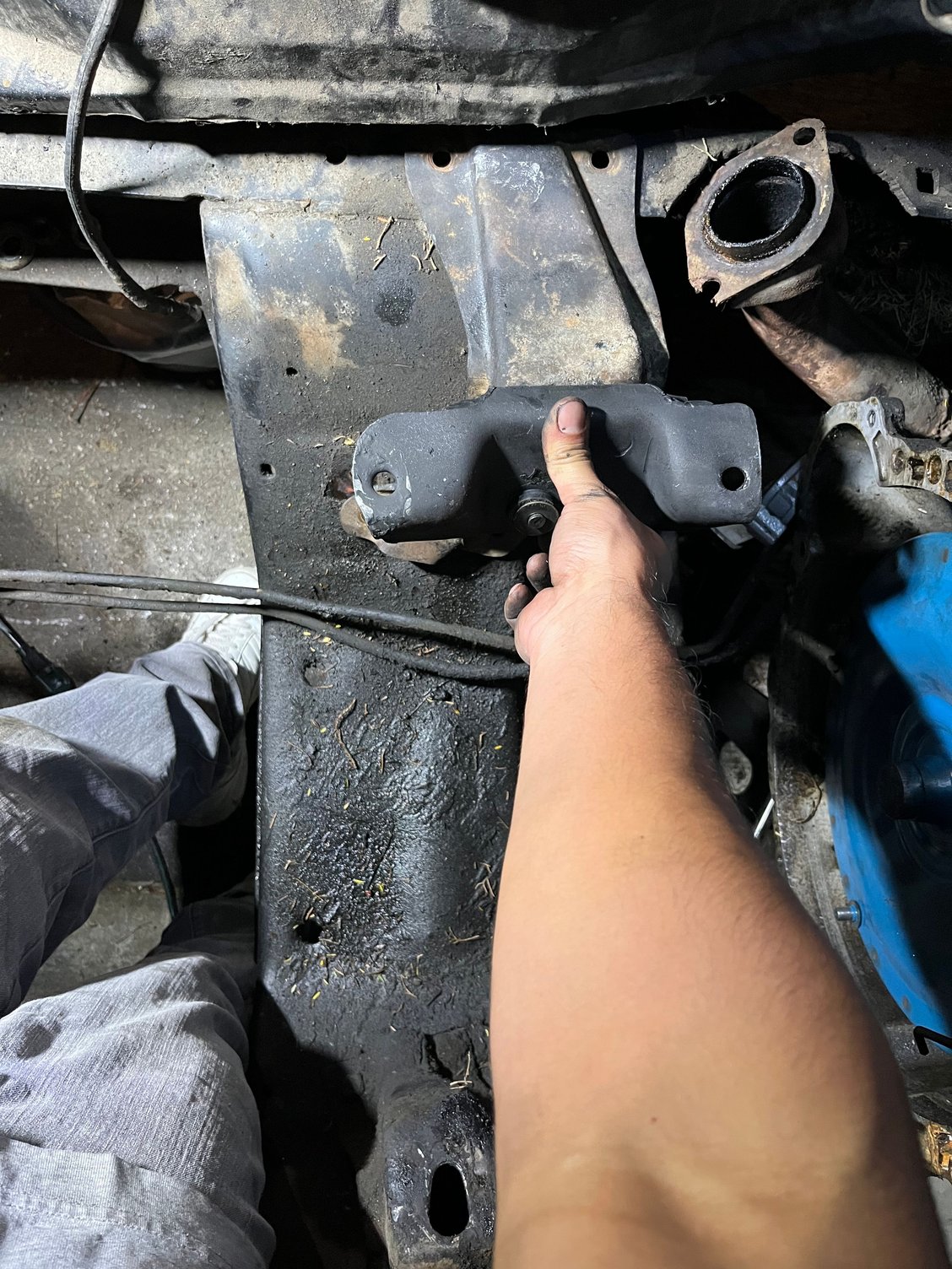

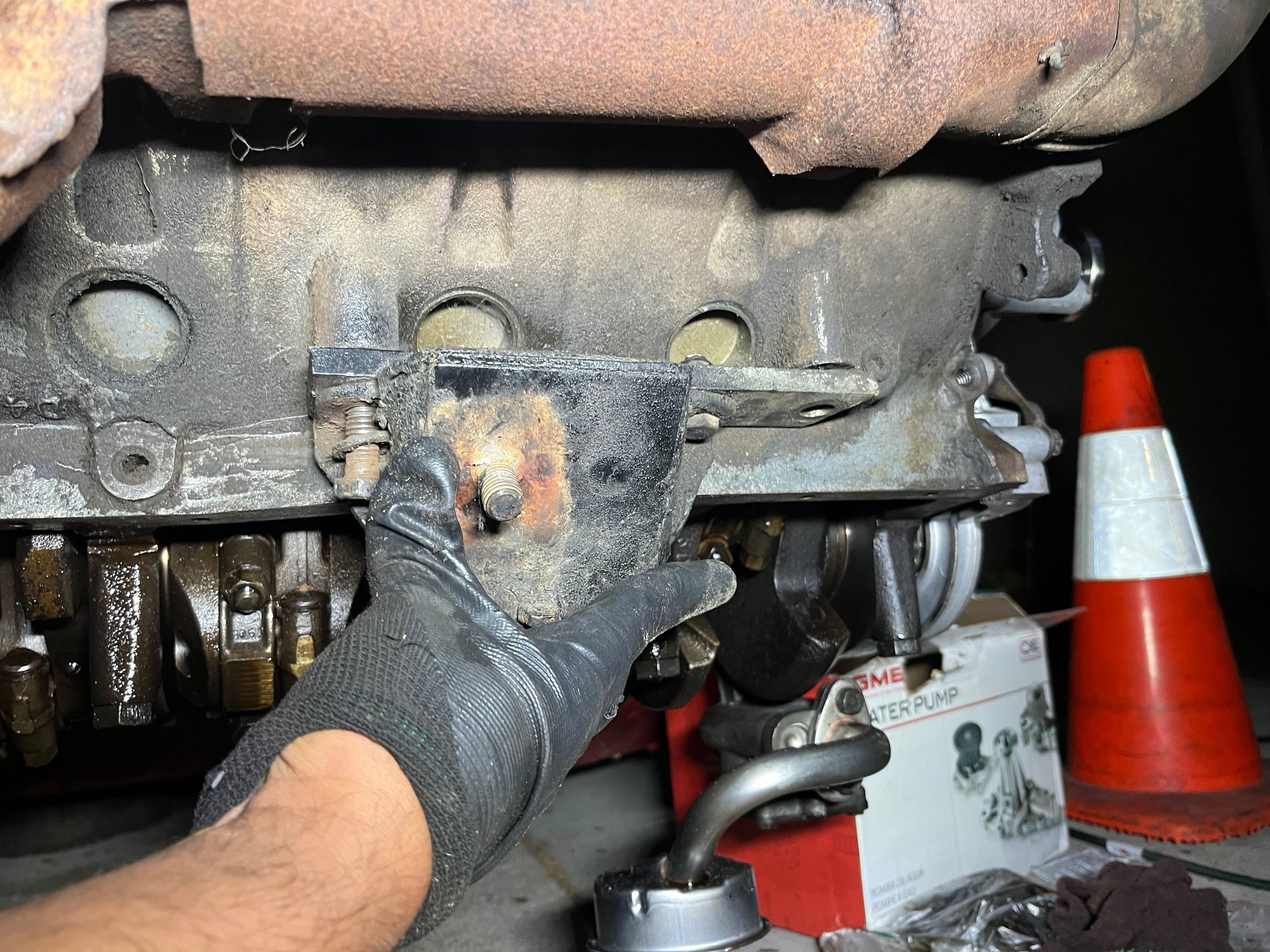

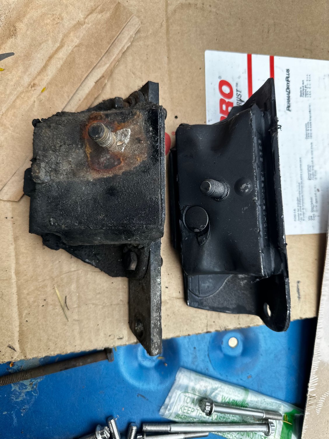

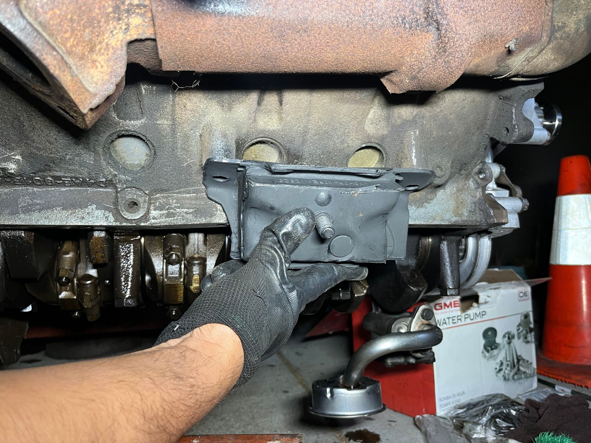

Here are some pics I took last night with test fitting and also a pic of the mount that came out of the engine and the new one I want to put in.
so if I use the perches it already had in, which look like FE perches, along with new mounts then the engine will sit about 1.5-2in closer to transmission… I I use the small block perch and new mount then it sits like 5-6 inches more towards transmission…
this sounds like a big difference and will it even bolt up or will there be a engine/transmission/ driveshaft issue since I’m moving the engine more rear?

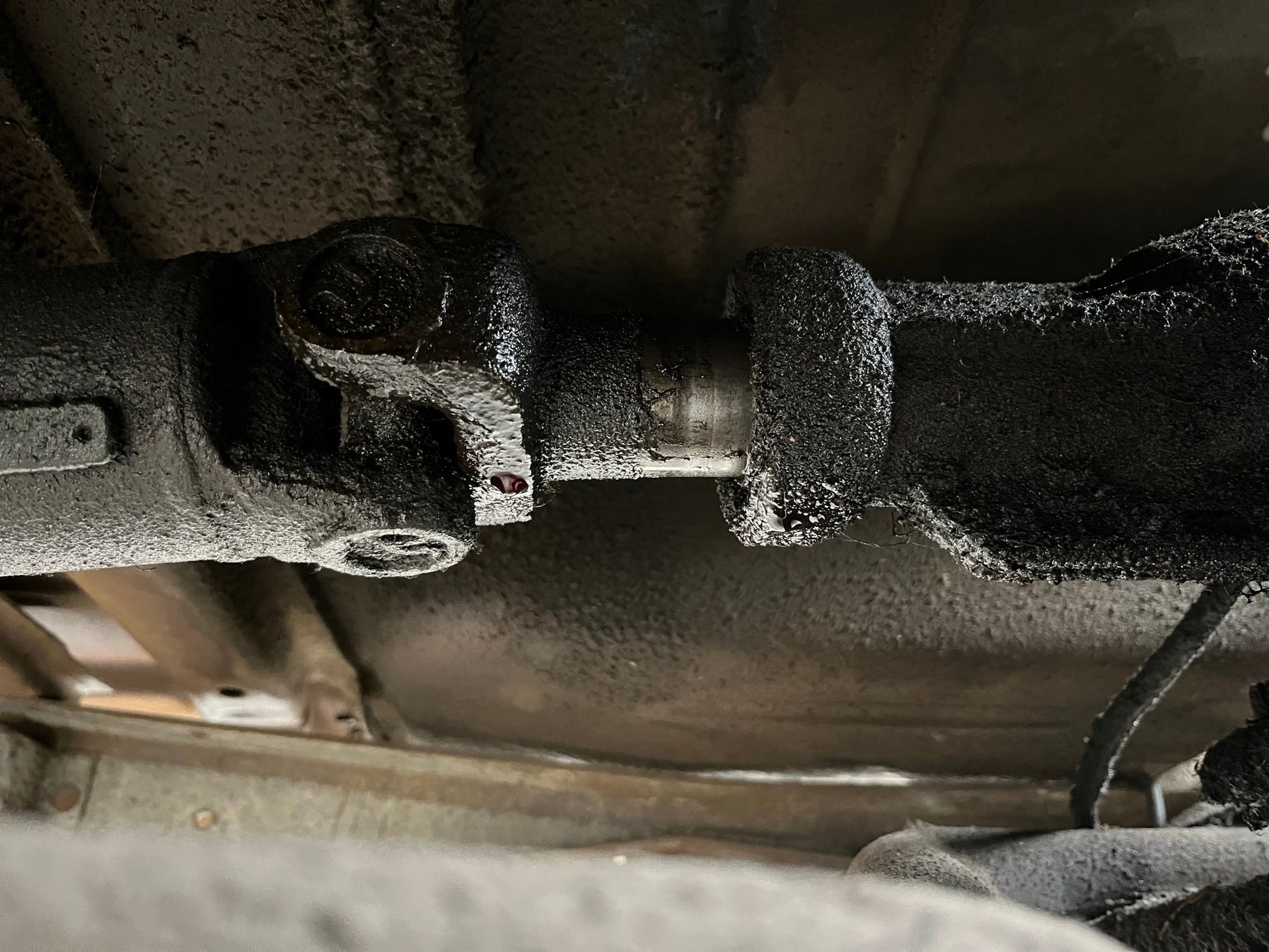

Update:

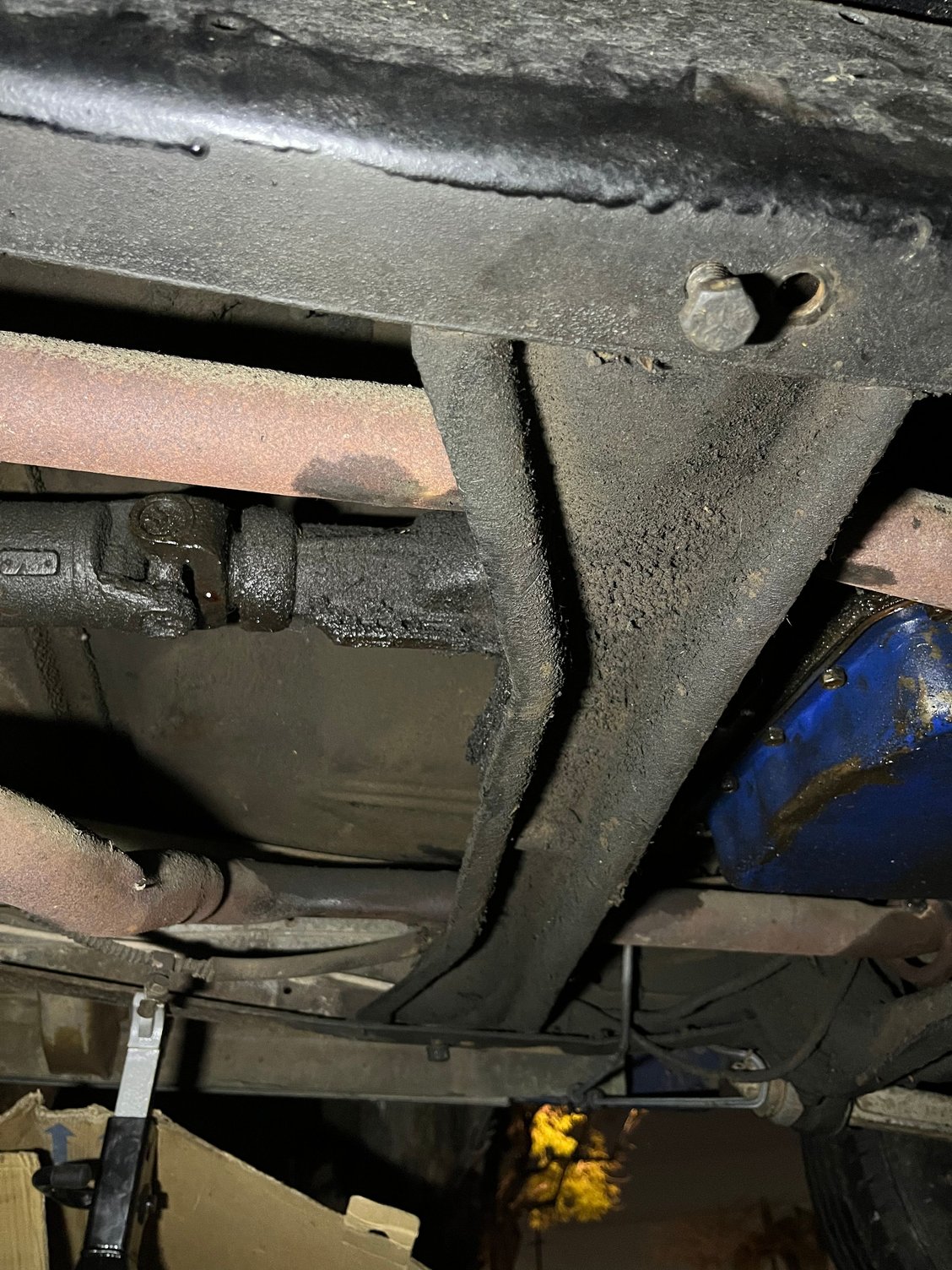

I used small block ford engine perches. I used anchor 2329 mounts. I bolted on the perches to cross member, and mounts to engine, the engine will not sit… the engine needs to go towards back of truck about 1 1/2 to 2 inches… the transmission has no more room to go back, has only about 1/4 inch of space from yoke(?) to end of transmission tail shaft, it used to have about 2 inches of space.
so even if I go back the 1/4 inch it has left the engine mounts will not sit on perches. And there will be no space for transmission/yoke to “slide”….
the transmission is an fmx based on pan bolt pattern) that is not original to truck and the 351w is not original to truck…
-does anyone have any ideas on how to make this work?
-also not sure if my transmission crossmember is correct… does the flat part face the front or back of truck?

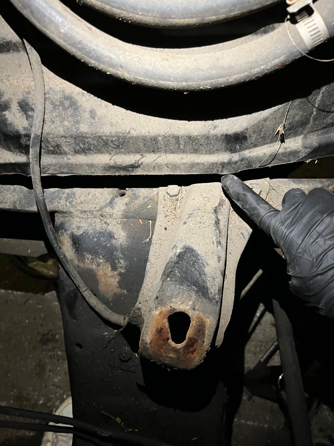

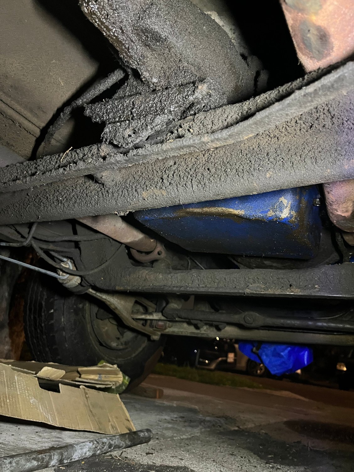

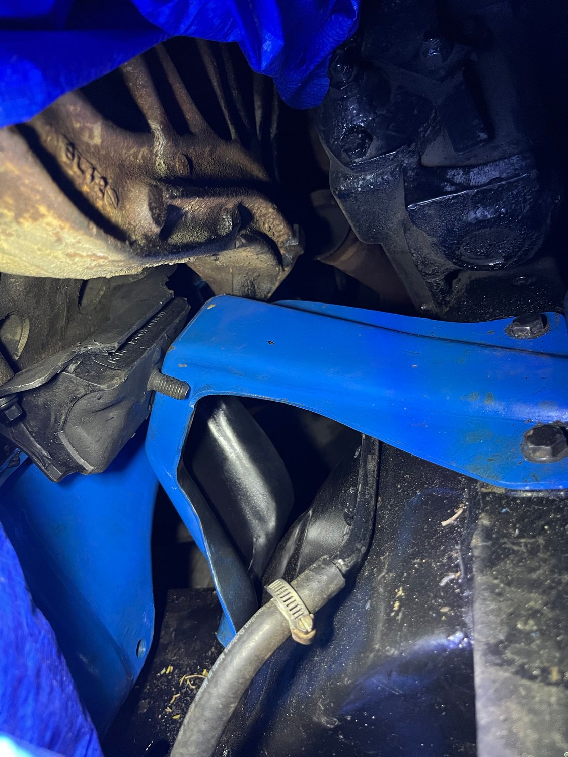

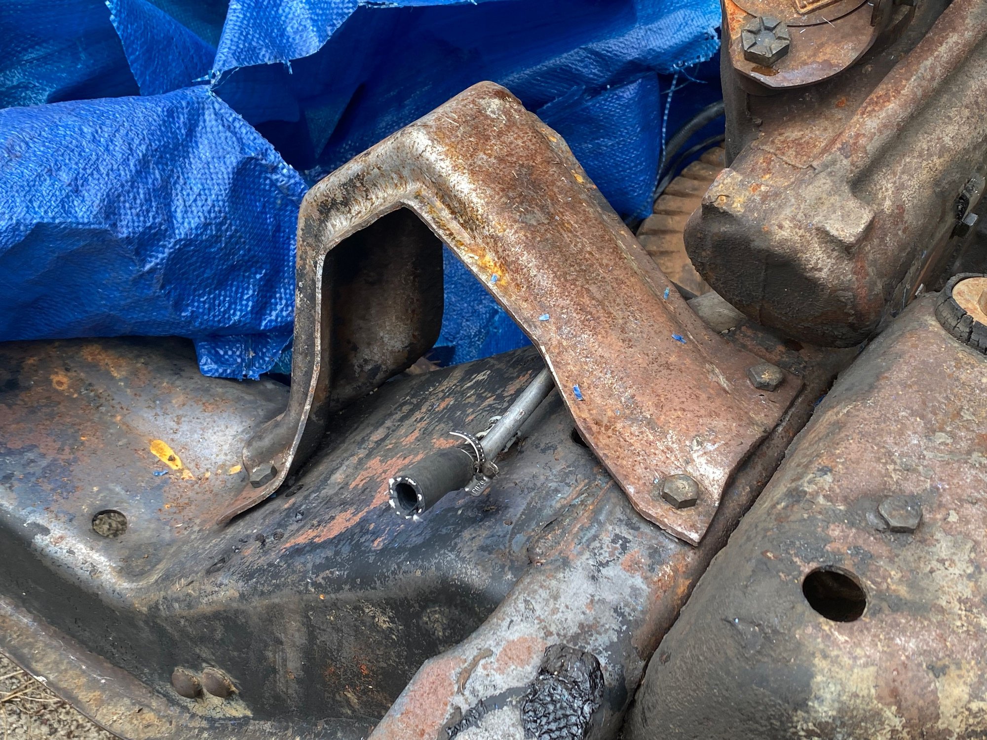

This was before putting the engine back in
This is now with the engine in… also moving the crossmember bolts to the holes towards rear(there’s 2 holes). I also think the cross member is backwards? Like the flat part should face the back? Not sure… also the transmission mount is missing a bolt that I think the go through the
… also the transmission mount is missing a bolt that I think goes through the triangular part there to secure it to crossmember. Where do I get one of those or what are the specs for it?
Driver side perch… the mount misses it by a little maybe 2 in or less.
Passenger side perch seems to miss it by a little more but I think the engine is just sitting at an angle.

Dump the driveshaft as it will need to be cut to fix this *******ization. The 302/Windsor never came with an FMX, only a C-4, which is shorter than an FMX. Shove everything back using the engine as your starting point. Use the photos from the Fordification site to align and drill new holes. Then cut the driveshaft to fit. That is the only way to get proper alignment.
