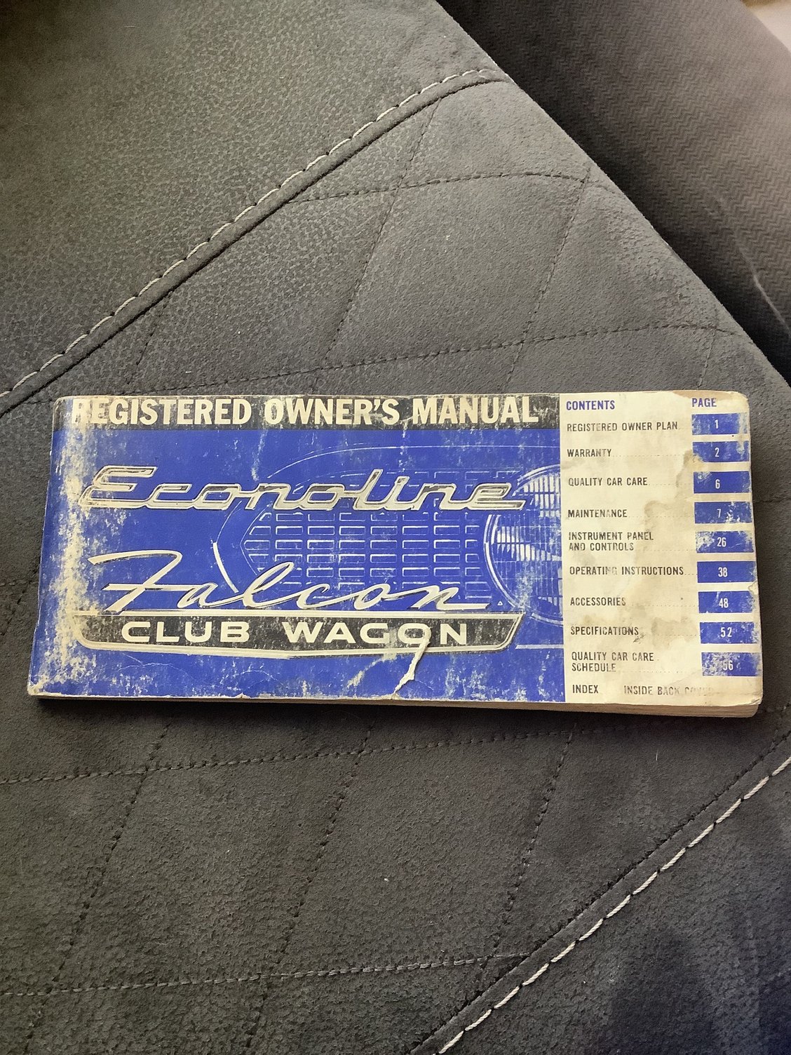

Hey there, we own a 1966 Econoline Falcon Club Wagon. It was my grandfather’s he used it for work in his refrigeration business for years. So the inside is very custom let’s say… yup **** carpet and all. It hasn’t been running for years and would definitely need some TLC inside and out. We have a free and clear title and the original owner’s manual. It seems rare, has the bubbled out windows and 8 doors. Curious where to start on selling this gem…

Put some pix in here, and a picture of the data plate, and we can tell you what you actually have, judging from your brief description it's not a Falcon Club Wagon. The Falcon version was all windows, sounds like you have a customized panel van. Also pix will give a good idea of value. Take pix of any bad spots, dents, rust. Also under the hood so we can see alterations. The owners manual is generic for all Econolines.

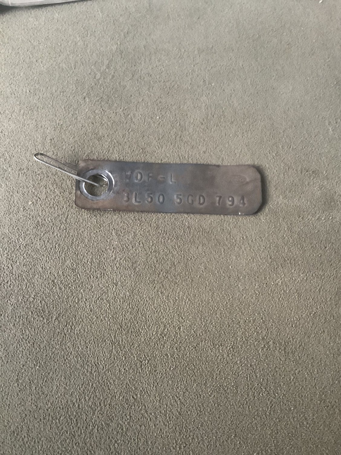

I’m still working on the pics of the van, is this the data plate? Also the vin is E14AH732015… does that tell us anything about what we actually have?

that is a rear axle id tag telling you it has 3.50 limited slip rear differential.

This is the rear axle ID tag: WDF-L = Ford 9" with 8 3/4" ring gear / 3.50-1 / Limited Slip / 2,780 lbs. rear axle capacity.
E14 is an E100 Econoline Van .. There's no such thing as an E14 Econoline Van
Warranty (data) Plate riveted to the left door face either above or below the latch. Post a picture of it.
