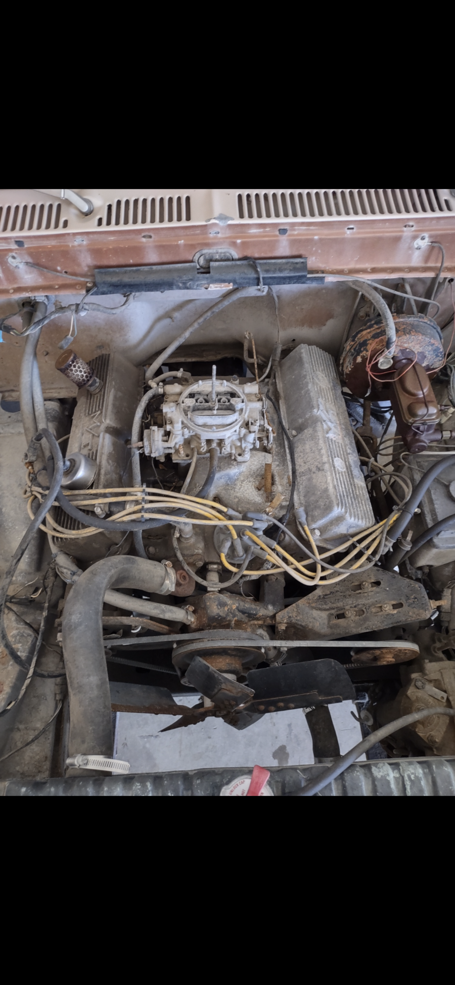

I just need to get it going, motor threw a rod but I bought another 390 from the seller so I’m going to take all the good parts off the old one and put them on the good motor. I bought a complete reseal kit from jegs for 80$ so that should be here shortly, then I’ll get to work.
Here’s the blown motor

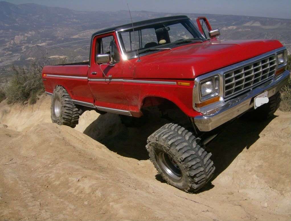

Yes 16.5's are hard to find in the 1st place and $$ when you get to trying to buy some. I have 38.5x14.50x16.5 on my red truck (now) with a 6" Skyjacker (all 4 spring lift). And you DO reuse the OEM rear block.
16.5's on line.
https://www.summitracing.com/search/...eter%3A16-5-in
Military take offs only get you 37x12.50x16.5 at the most. If you are going to use it as a crawler you better definitely ditch that rear leaf pack stack. No flex, means no traction and then no crawl. Deaver can build you a set. https://deaverspring.com/product-cat...-springs/ford/
Back in the day 35x14.50x16.5 TSL SX Super Swampers on the front.
35" Boggers on the back.
Mil take offs bias ply 36x12.50x16.5
35" Boggers all the way around.

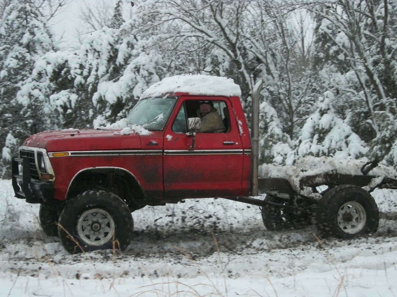

The mil take off 36's kinda fail as a snow tire. Unless you are on the skinny pedal.
And now days after redoing the truck it has 38.5x14.50x16.5. I think I am going to bump down to mils takeoffs 37's on black spokes to get better fender to tire clearance in a turn.

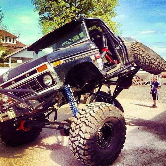

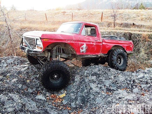

They can be built to crawl with the best of them. This is a fellow FTE member's rig getting after it.

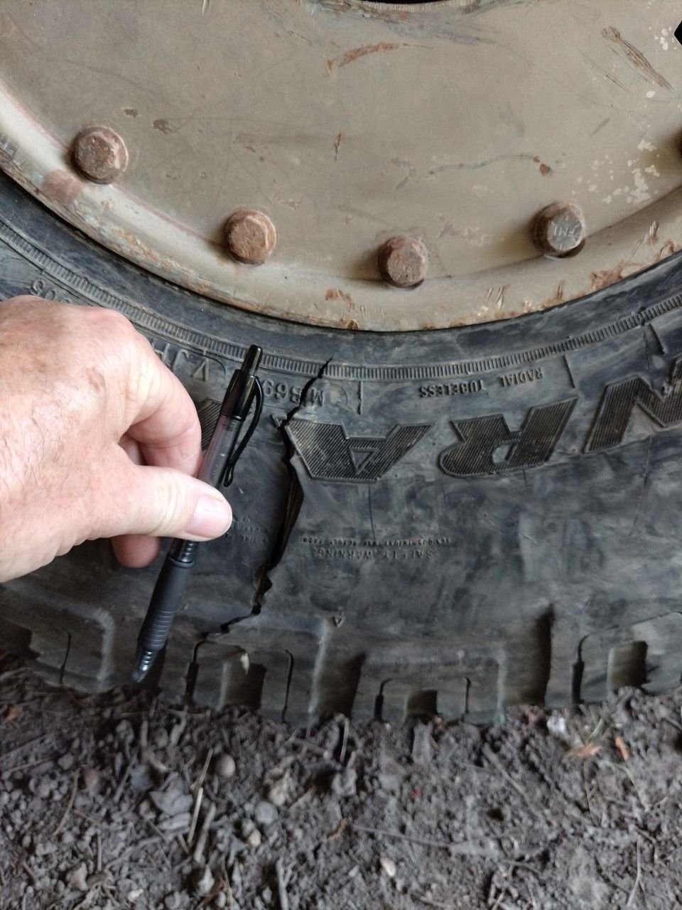

That’s a good looking rig. I’ll figure out my tire situation at some point. The ones on it aren’t too bad other than age they just saw mud so no rocks to beat up the tread or sidewall. The driver side front has a gash in it though which is disappointing but oh well. Yes I definitely want to get rid of the dump truck leaf pack. The bed is off a new truck not sure what happened to the original one so I guess might as well rip the rest of the chrome off

Thanks, it took me quite a while to get it done, but it finally is. Take that tire to a tire repair shop (maybe a local big rig shop) that can do vulcanization. And then run a tube in it, that is what I did on this tire. Yes it is a off road rig only, plus have bead locks and run only 10 to15 PSI anyway. Best 70 bucks I ever spent. I am sure Utah has folks that vulcanize tires, since it is a off roading meca.

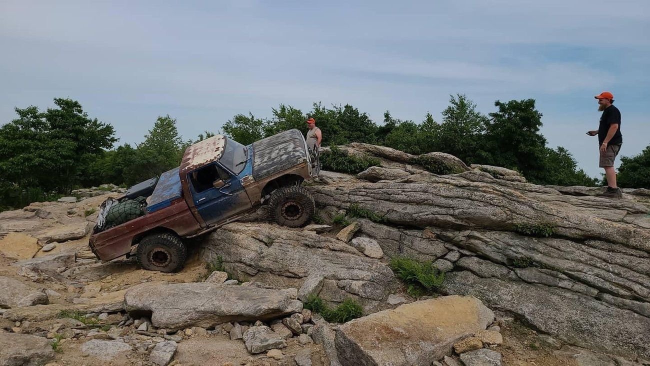

I hear ya on projects, I have three 4wd F250's (77, 78, 79) and 2 early Bronco's (71 and 73). And I constantly have the son in laws 76 Bronco crawler at my place to work on. If you want it to flex and crawl like a mountain goat on crack. Do a 3 or 4 link the front and back, long reach shocks and a little smaller tires so you can flex and stuff them.

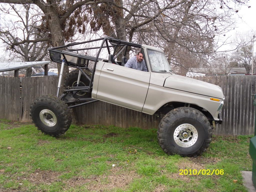

It is fun to flex...
Old Apr 13, 2023 | 11:36 PM
AustinL17's Avatar
AustinL17
Joined: Feb 2022
Posts: 82
I bet that is fun and those are really cool pictures. I’m not going to be doing coil over though and that makes flexing a little harder
