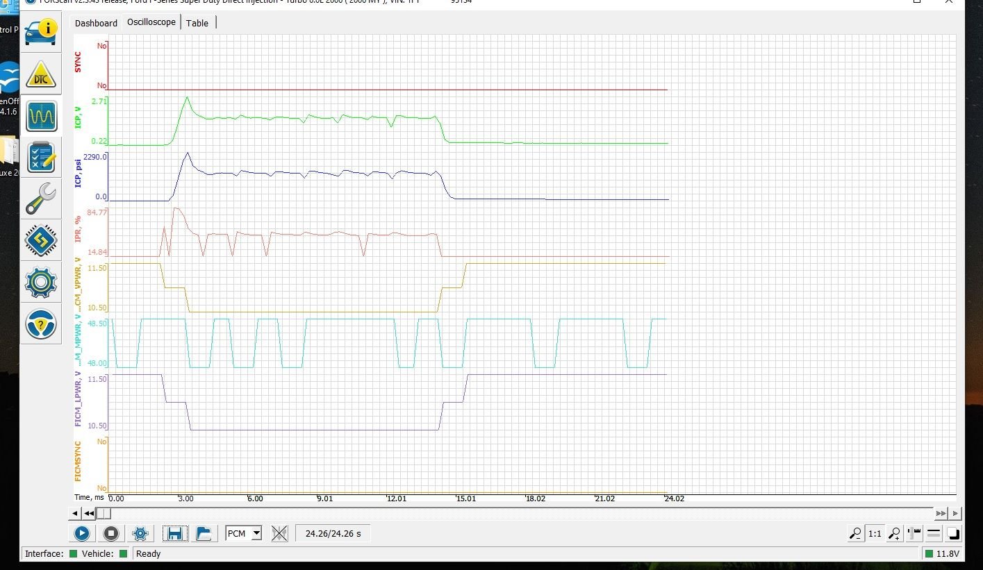

Ok, ran a couple of Forscan screens. For the most part everything looks normal. BUT, I have NO crank or cam position sensor sync OR FICM sync. Voltages look good. Oil and fuel pressure are normal. ICP and IPR appear to be normal. Still NO RPM reading. Still wont start. Also, I did a crank with fuel timing and noticed a gap between sensor readings. Is that normal? I have never looked at that before.
Is there a way to select for a reading on just the crank and cam sensors in Forscan? I don't seem to see it. Thanks, B.

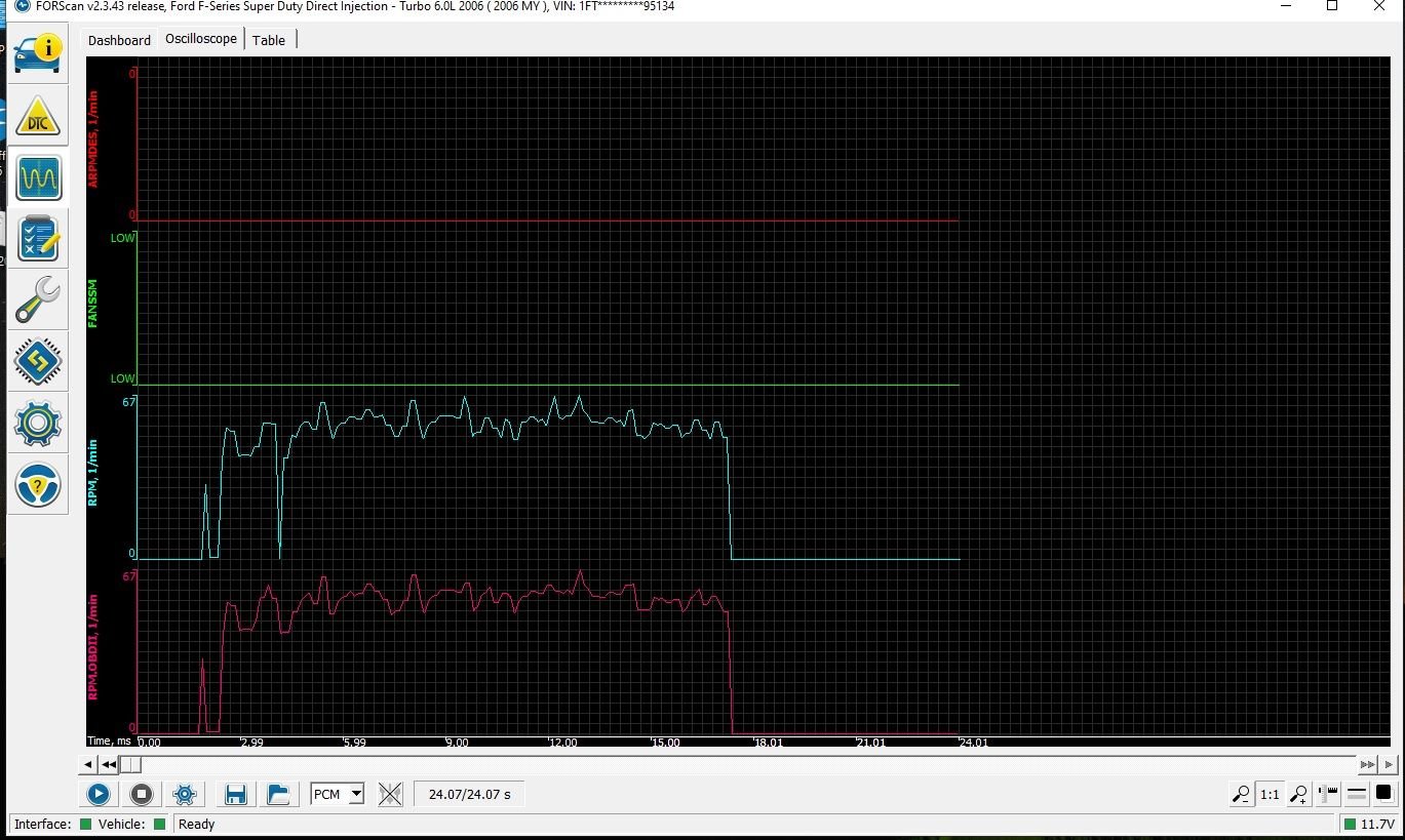

That's what I thought Mark, but I don't see it listed. All I see is the sync option, which only gives me a yes or no answer. Will need to dig further. I just ran a scan of the RPMs during cranking. Screen attached. RPMs are erratic and very low according to the diagnostic data. BUT, the engine is cranking around 170 RPMs per my ear/sight/sound. B.
