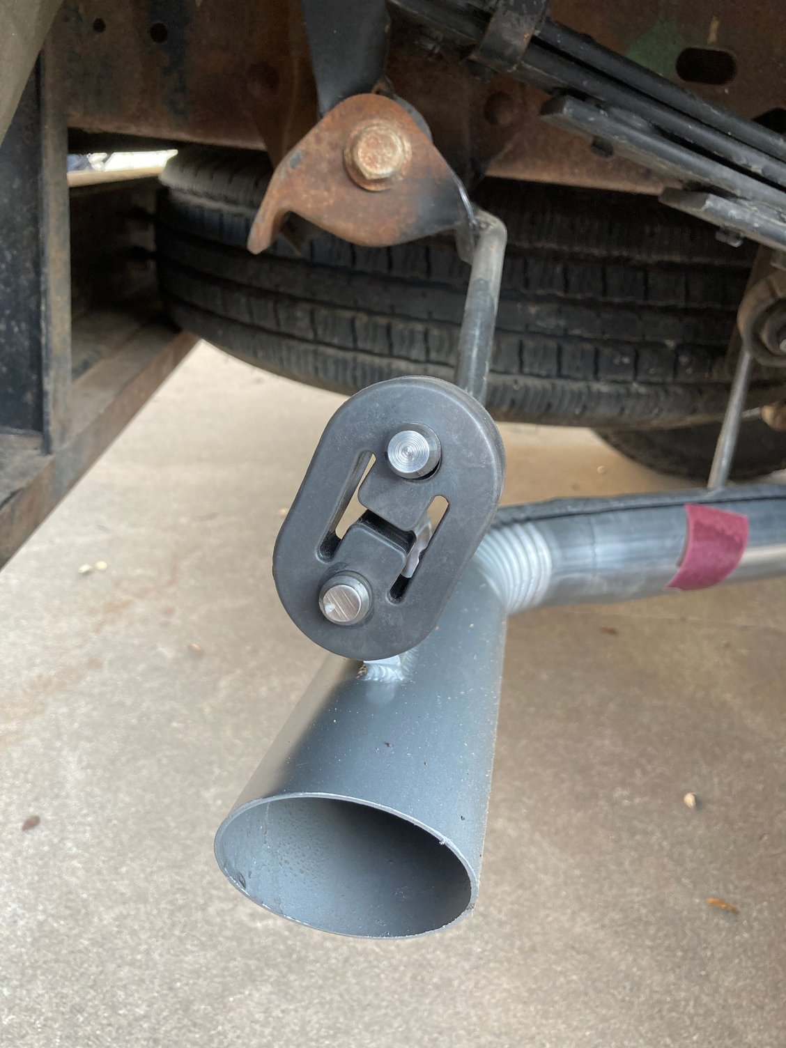

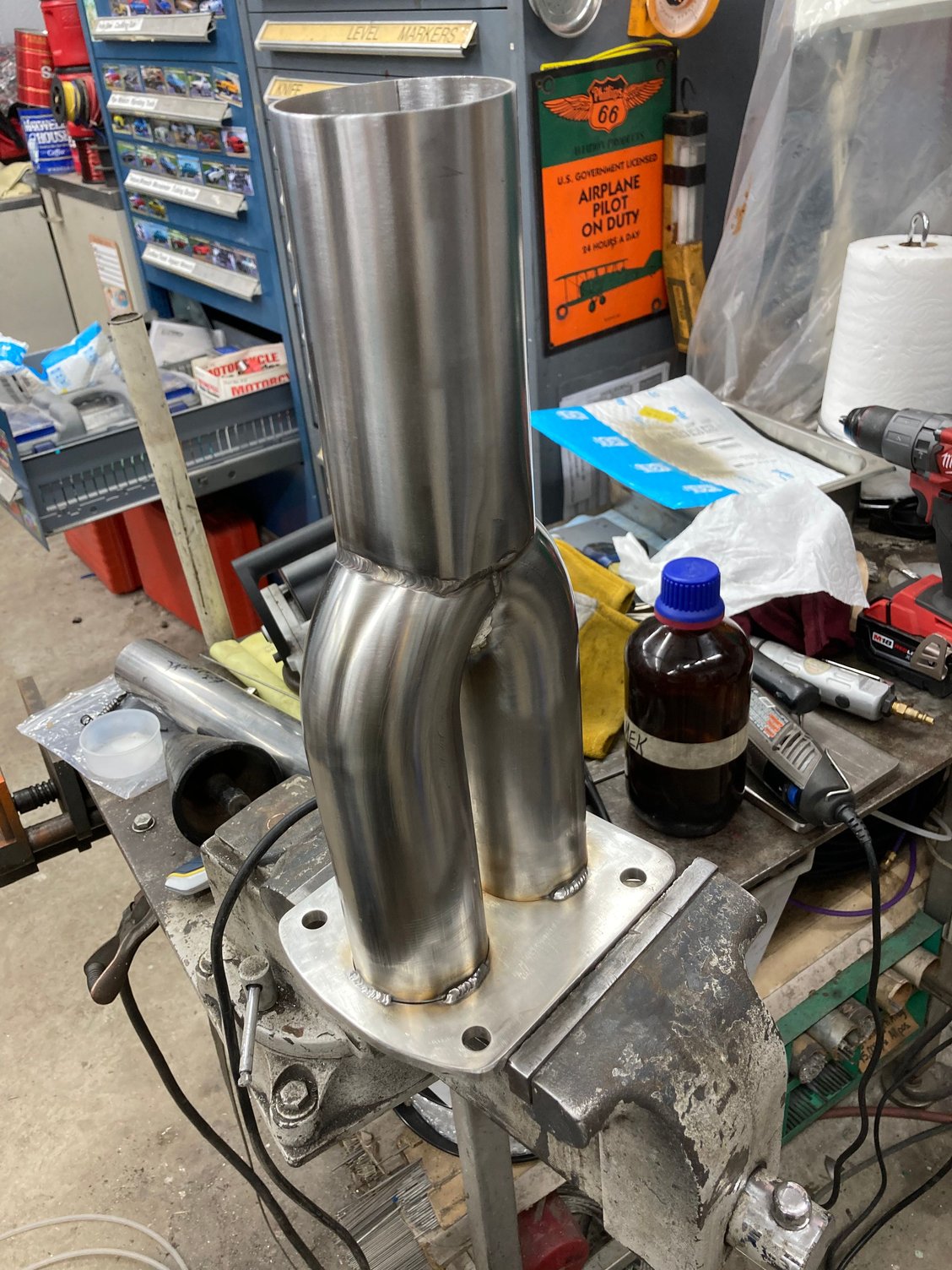

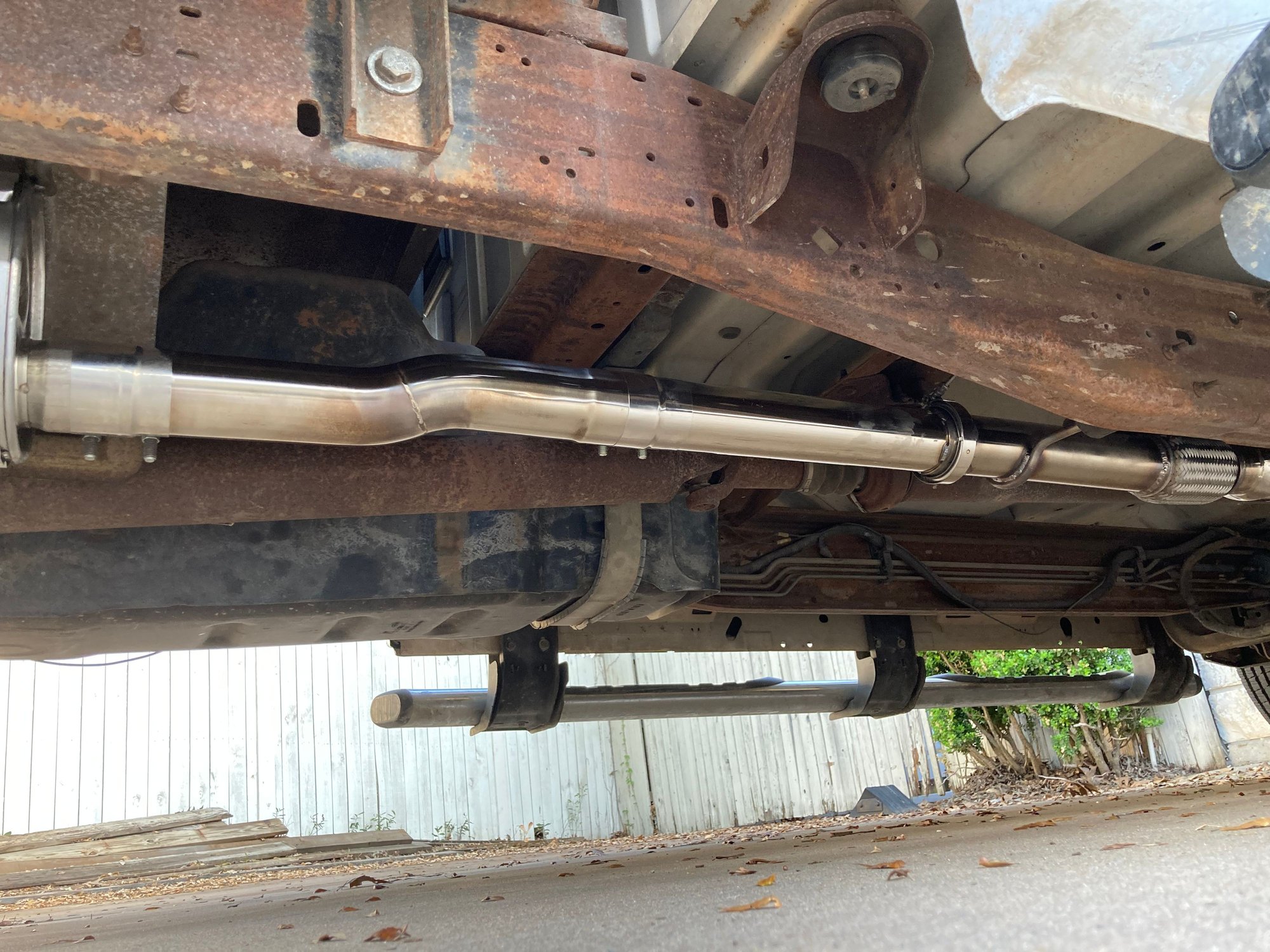

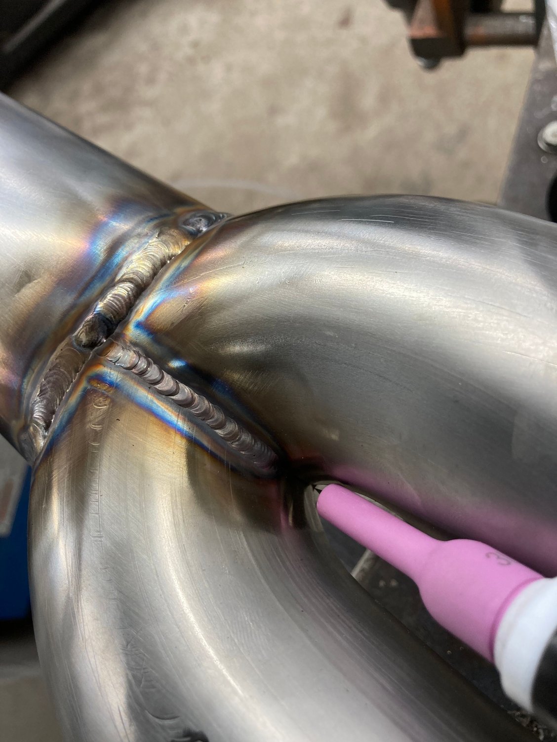

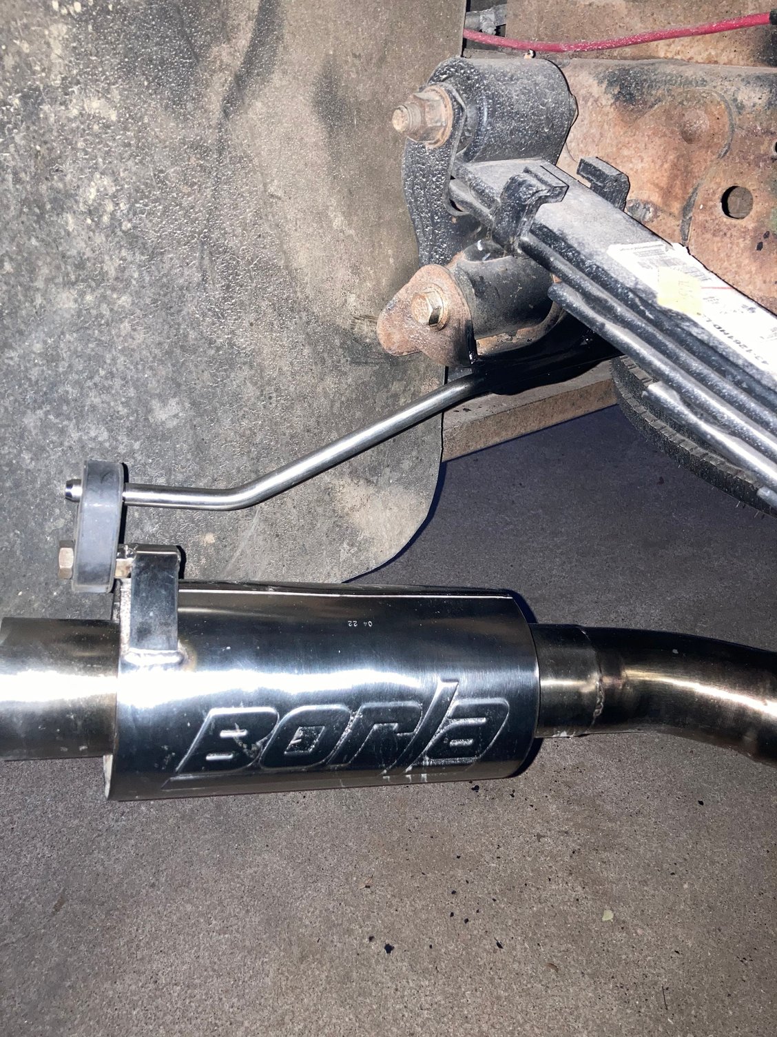

I tried the 50 series big block muffler on my 2001 F350 V 10. After about 200 miles, the drone was too much for me to deal with and I installed a Wagner stainless steel OEM style muffler. Prior to removing the 50 series, big block, muffler, I installed a Borla resonator on the tail pipe. This was not enough to make it drivable for my liking. The rest of the system is a custom made two into one stainless steel header and Ford style collector.
The Borla resonator is pretty, but it wasn’t enough to remove the annoying resonance
After installing the walker, OEM, stainless muffler, I added a hanger to further support the tail pipe
Custom made stainless steel Y pipe
Stainless steel intermediate pipe with flex coupling and disconnect flange
