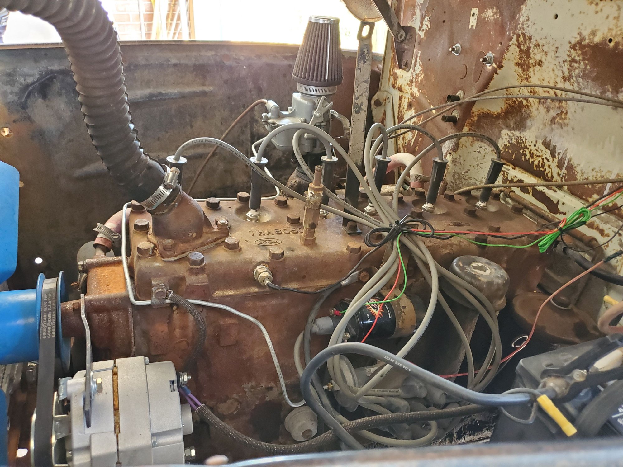

Hello folks.
I have a 51 F2 with a 226 h flathead. She runs and drives but I just can not get it to run well. Idle is terrible and she falls on her face when you first give her gas. Runs smoother at higher RPMs (1000+). Carb was just rebuilt. Plugs, cap and rotor just replaced. Running a Pertronix electronic ignition module. Replaced the vacuum line from the carb to the distributor. The rough idle and extremely poor throttle response make the crash box transmission near impossible to use. And ideas on where I go from here would be greatly appreciated.

For ignition: What module did you put in there? What electrical system are you running? From the pic, I'm going to assume it's a 12V positive ground conversion. Have you checked the voltage going to the pertronix/coil? Is it getting full voltage while it's running? They can get wonky if you are getting voltage variations in what is being supplied to it. As asked above, that coil is for THAT module/ignition system? Is it hard to start along with poor idle? Maybe the electrical system is weak and the voltage to the ignition system is low until the alternator starts spinning faster (above 1K RPM)?

It is a 12v negative ground. I will check the voltage at the coil first thing. Wow, I should have checked that first. The coil was a part of a package deal for the pertronix.

Here is your problem, take off the air cleaner. it is way too small and i know fron experience that small air filters choke out those old carbs to the point that they barely run.
you need an adapter for a bigger filter (Round) and about 10-14 inches wide for it to run smooth.
