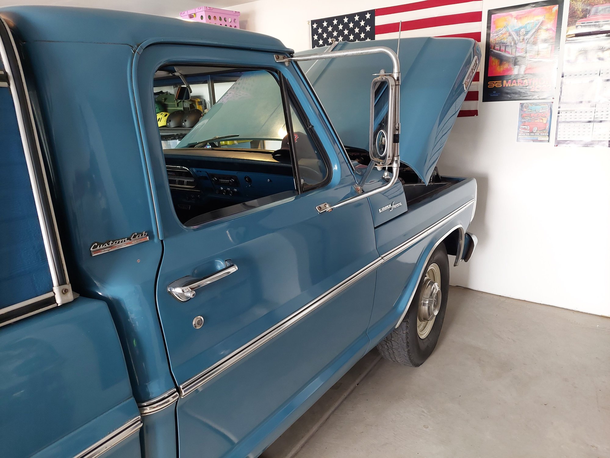

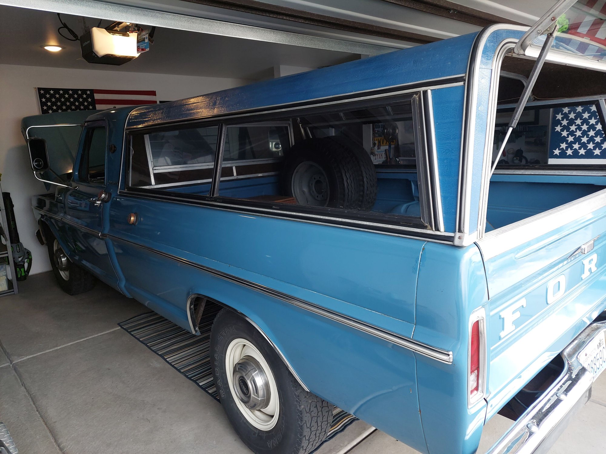

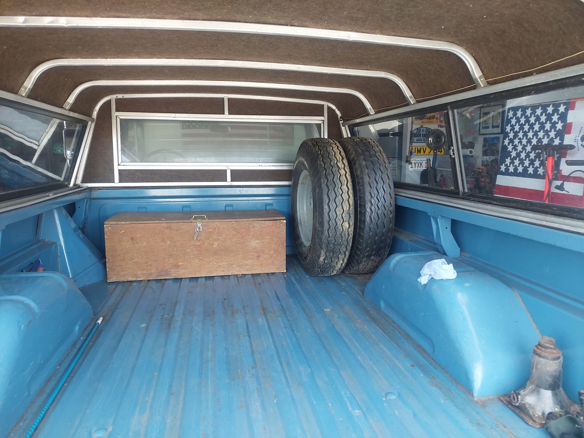

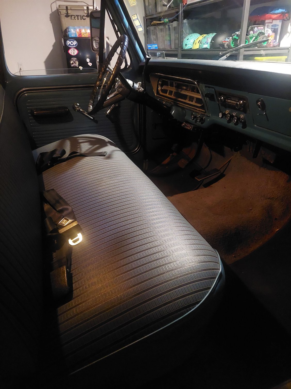

Man that's a really Bitchin looking truck. And for me it's the right year and I even like the color. We would like to see a lot more pictures of it.
Kinda weird for as much time as I spend with it...I don't have as many pictures as you would think...lol
Thank you for the kind words too.
