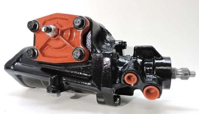

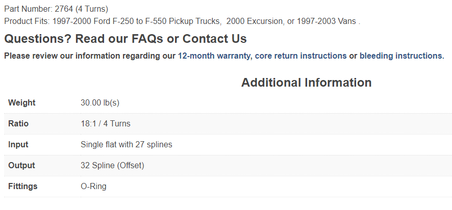

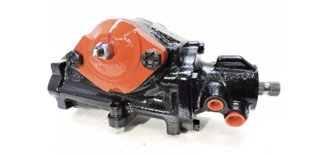

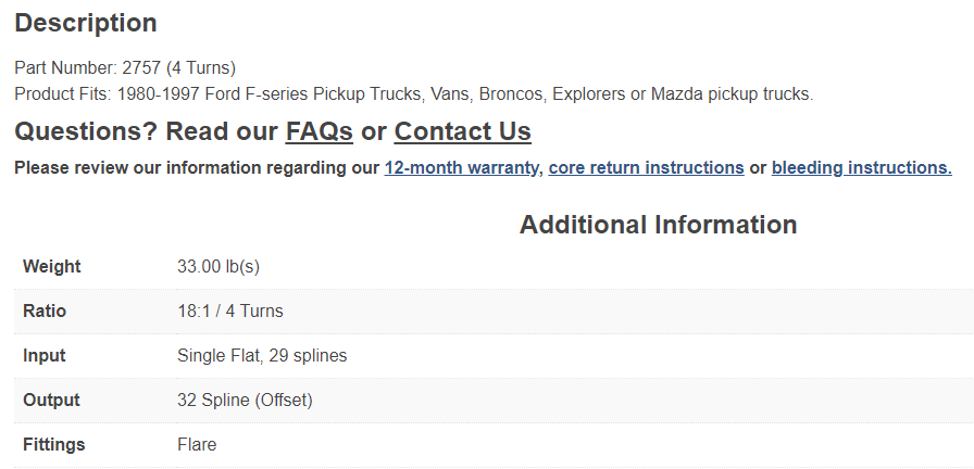

make sure it has he right tooth count when you buy it or its going to slip
two bolt head has 29
4 bolt head has 27

you wouldnt happen to have a pic of the 2 bolt or 4 bolt i believe mine is a 2 bolt by feeling around mine was built june of 97 obs want to make sure i by rigjt one thanks

top red thing has two bolts with adjuster in middle
Old Apr 6, 2023 | 02:27 PM
i thought they were talking about the bolts where the splined shaft was the red cap is where the adjustment nut is isnt it? Is that what they mean i am looking a borgeson 000981 for the shaft and they say it will only work with the 2 bolt ones thanks for the help

four bolt one
