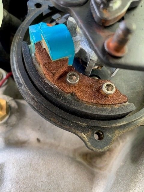

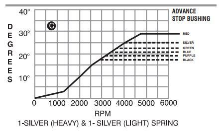

The timing light I ordered got lost, so I placed another order. It's a shame the local auto parts stores don't have timing lights in their loaner program. I confirmed TDC today and took a look at the guts of the distributor. I have the two stock, heavy silver springs installed. I can't tell which color bushing I have (see pic below). The color looks more rusty than red. Assuming it's the stock blue one under that rust, that has my mech advance at 21-deg and all in at 4,000 RPM. I ordered a spring/bushing kit and will likely target all in around 3,300-3,500 RPM. After testing my current setup, I'm thinking I'll start with one heavy silver, one light silver and a blue bushing (~21-deg advance at 3,400 RPM).
J.
No idea what color bushing this is/was. Looks dusted with rust.
May start with this arrangement and a blue bushing and see how it performs.

I adjusted the timing this weekend. According to the PO's documentation, base should have been at 8-deg, but it measured at only 5.9-deg. I increased base to 10-deg and changed up the springs and bushing. I'm getting about 32-deg total advance now. The truck seems happier, although I'm still getting off idle stumble.
Question: The mag pickup is rusty. It seems to be working, but should I replace it? The reluctor looks ok, although a little oxidized.
Thanks,
J.

Rust on the pickup coil won't hurt anything. Most of the time on an MSD I end up using one light sliver and one blue or two blue springs with the large bushing(shortest curve) and that seems to work well if the engine has some camshaft.
Hey Dave,
With 2 blue springs and a black bushing (the largest, right?), that has you all in by 2500 RPM, but only about 17-deg of mechanical advice, right? What is your base timing? I have no experience with engine timing, so I took a baby step going from 2 heavy silver springs to one heavy and one light silver spring...but I stuck with the blue bushing. Maybe that is still too conservative. I don't think I have an upgraded camshaft (not the original owner). Thanks!
