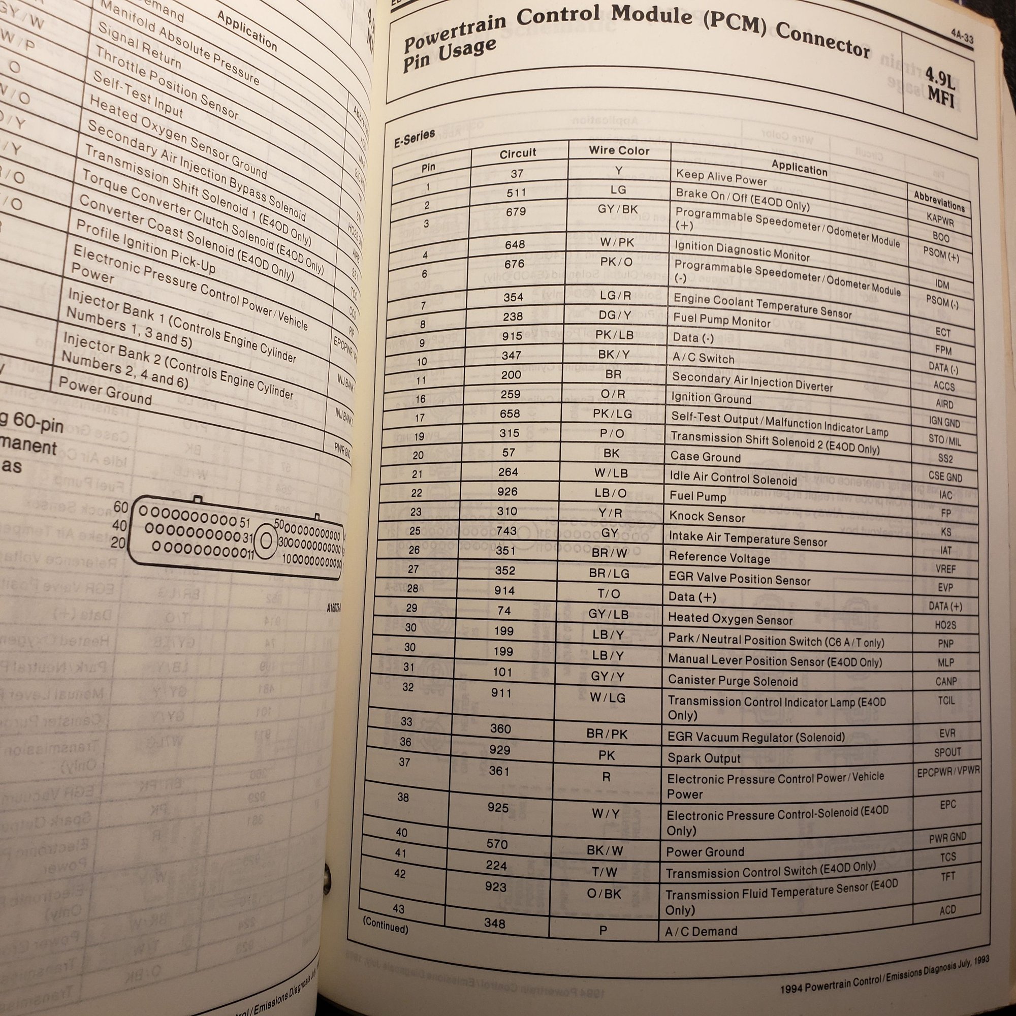

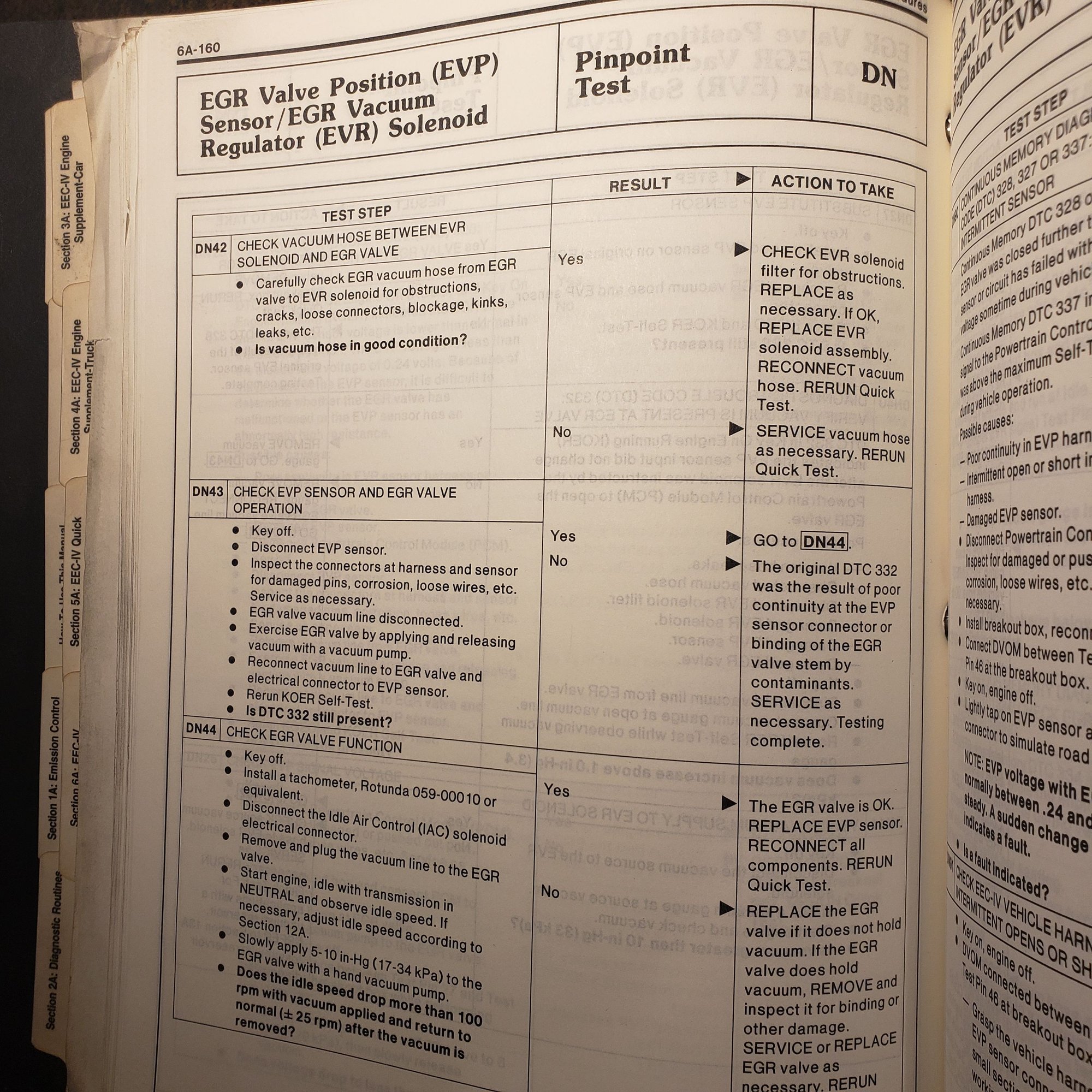

I read pid info using my NGS
Your 94 is smart enough that I can run a bunch of them
You might need to borrow a scanner or see what one of the OBD1 ones will do (most likely nothing) as my Super Star II does not read pids (the NGS predessor)
So, We (us Ford techs) have been back probing connectors for years to eliminate the breakout box
The EGR pinpoint test diagnosis for that code 332 for instance has you measure the EVP voltage after installing the breakout box IIRR
With NGS you just read that pid
You can backprobe your connector if you lengthen and skinny up your test leads for your DVOM
I soldered, brazed actually, nails to nuts that screw on my leads (I can ruin a connector in a few minutes now), just kidding, be careful

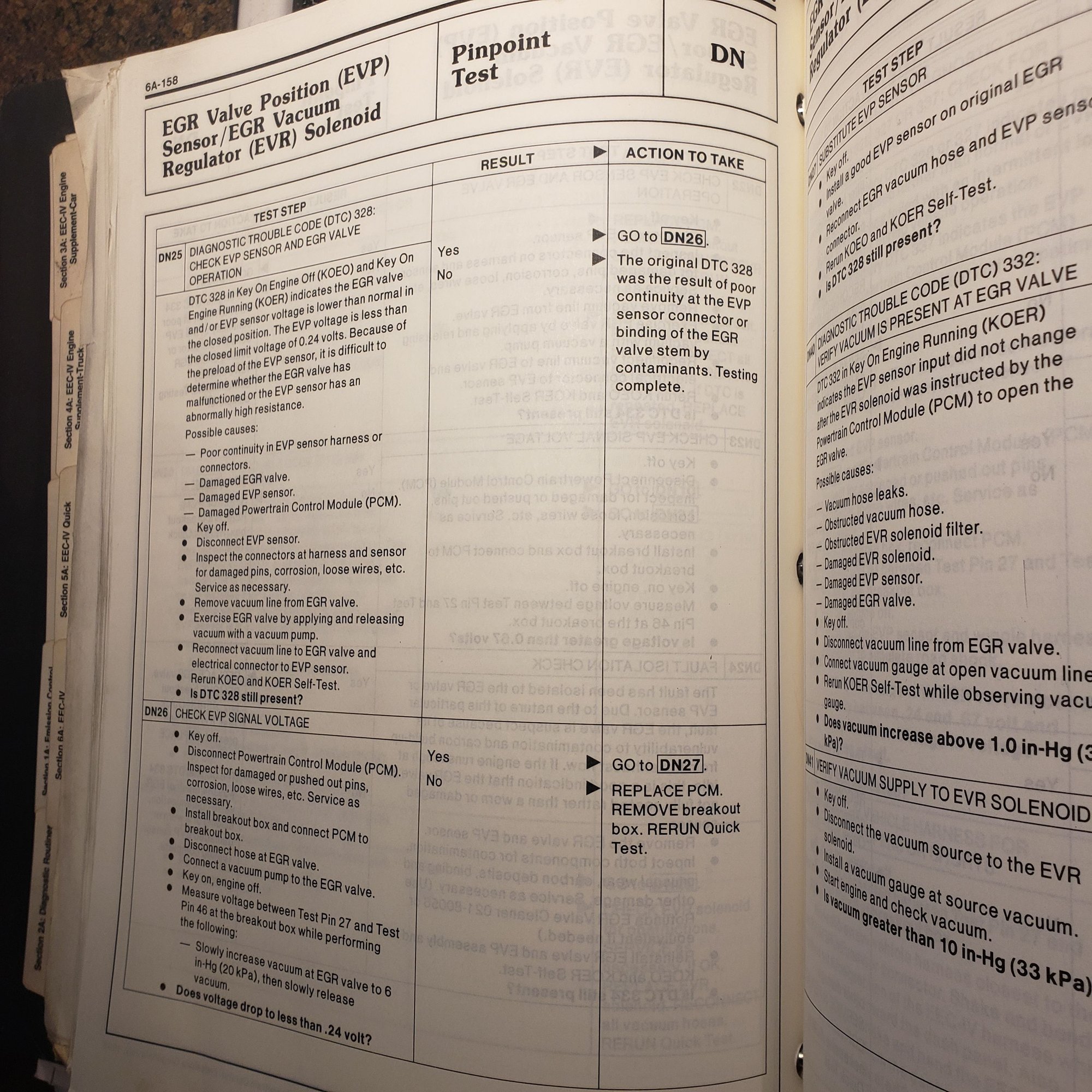

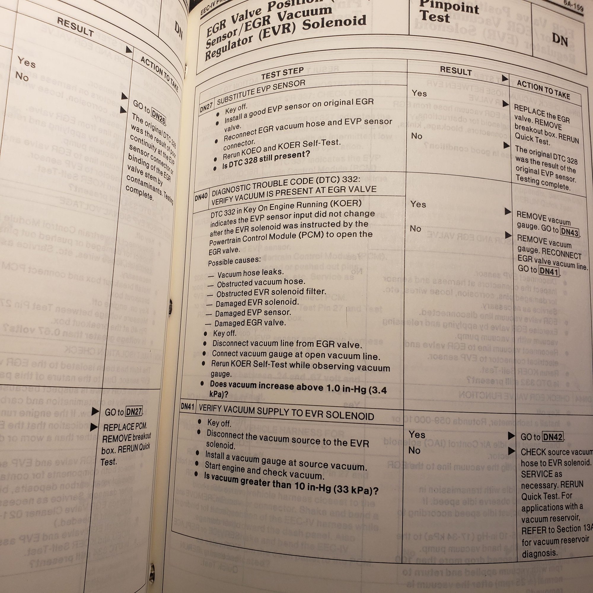

I think I have those pinpoint tests and you need the voltage number, I'll post them, but from photo of page, that is the best I can do with my PCED
Looks like the spec is .24volts with the valve closed
Also no breakout box for that code 332

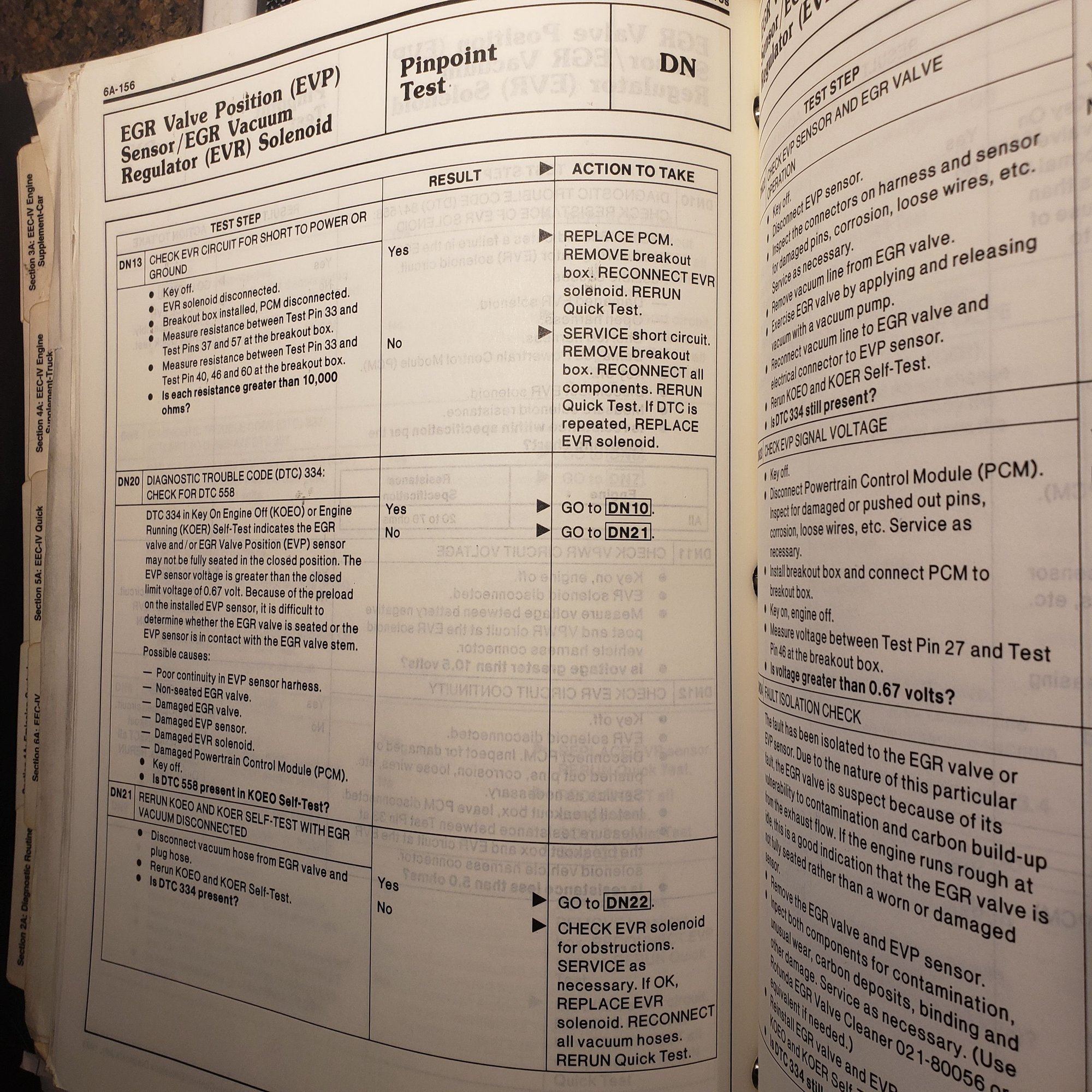

So, if you make it to DN44 and the valve is closed and sealed, you replace the EVP

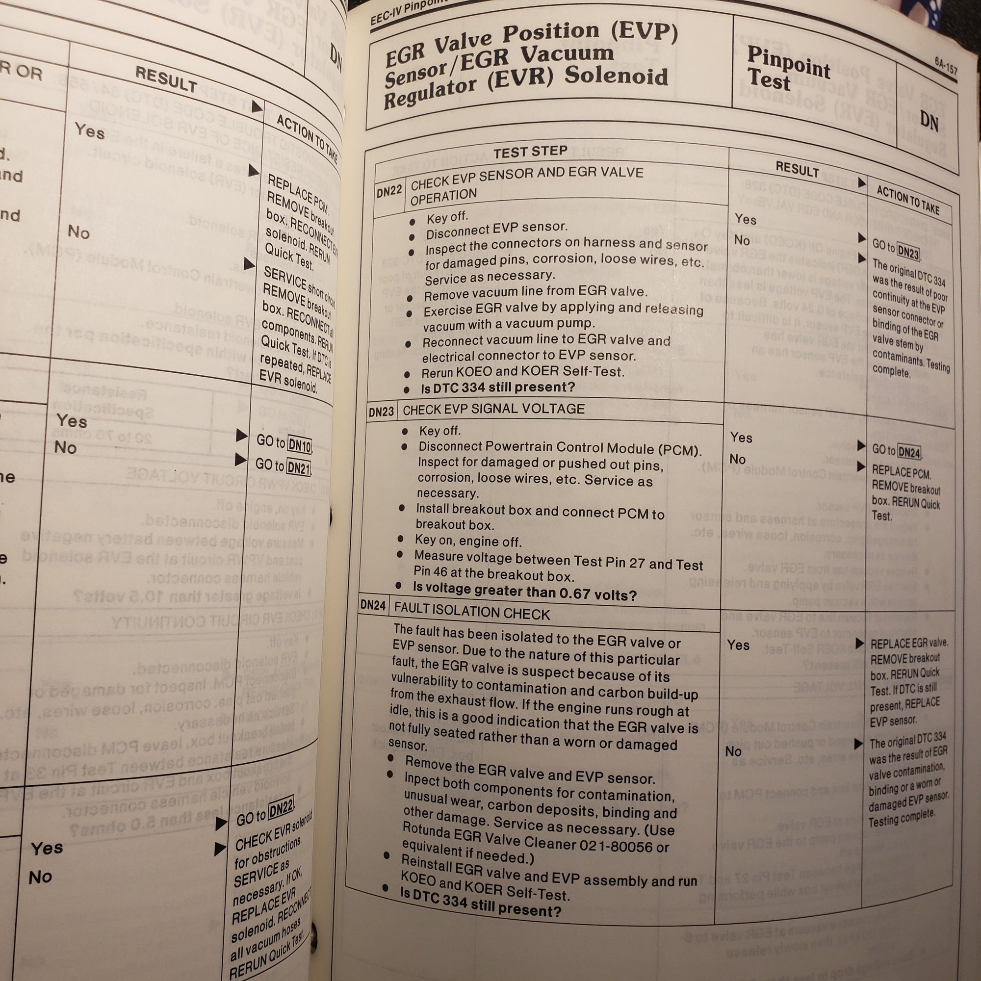

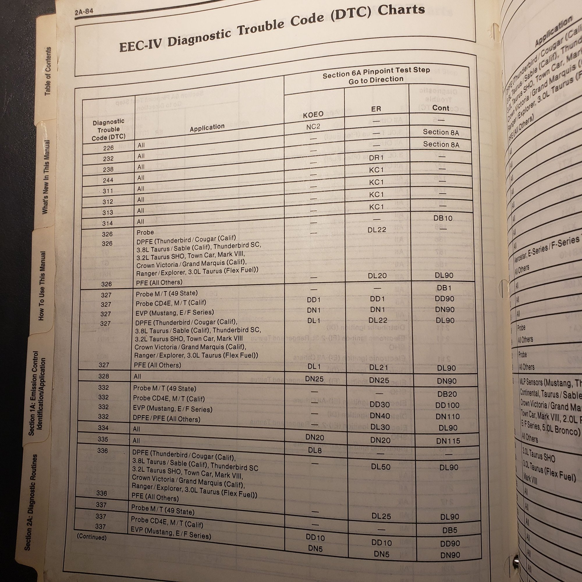

Just realized you are chasing 334 (not 332) and need to start at DN 20
Pay particular attention to what 20 and 21 are saying to you
So you do need the breakout box, or to backprobe the connector while hooked up
