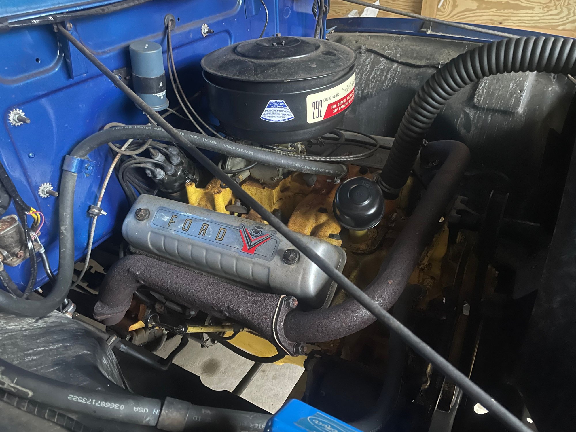

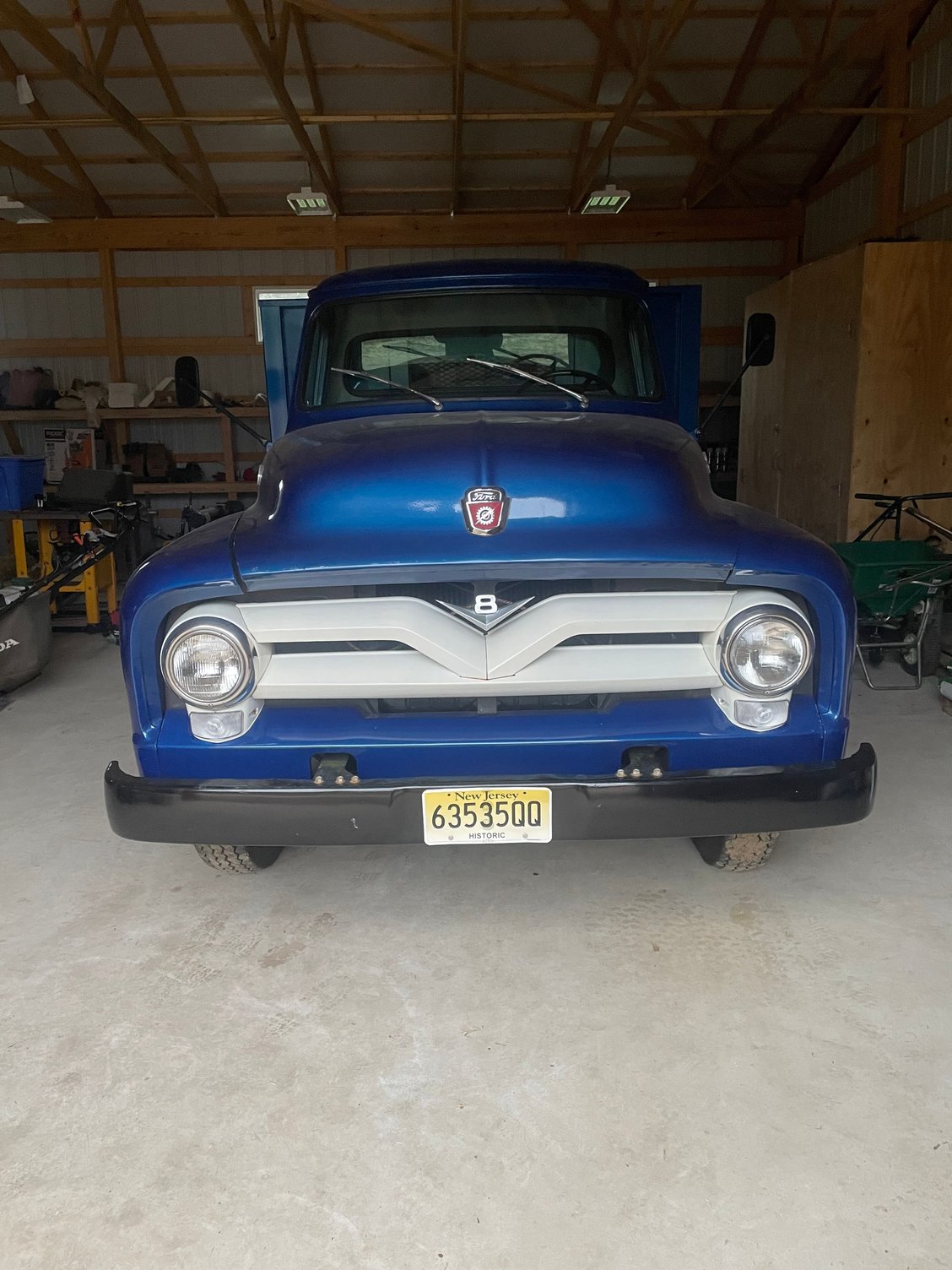

Hi everyone. My boss just bought an F600 to use here on the farm where I work. We’re a large landscape company as well. We’d like to convert the truck to power steering and 12V. Any advice is greatly appreciated. PS, I’m relatively mechanical so I’m hoping this is something we can do in house. Thanks in advance.

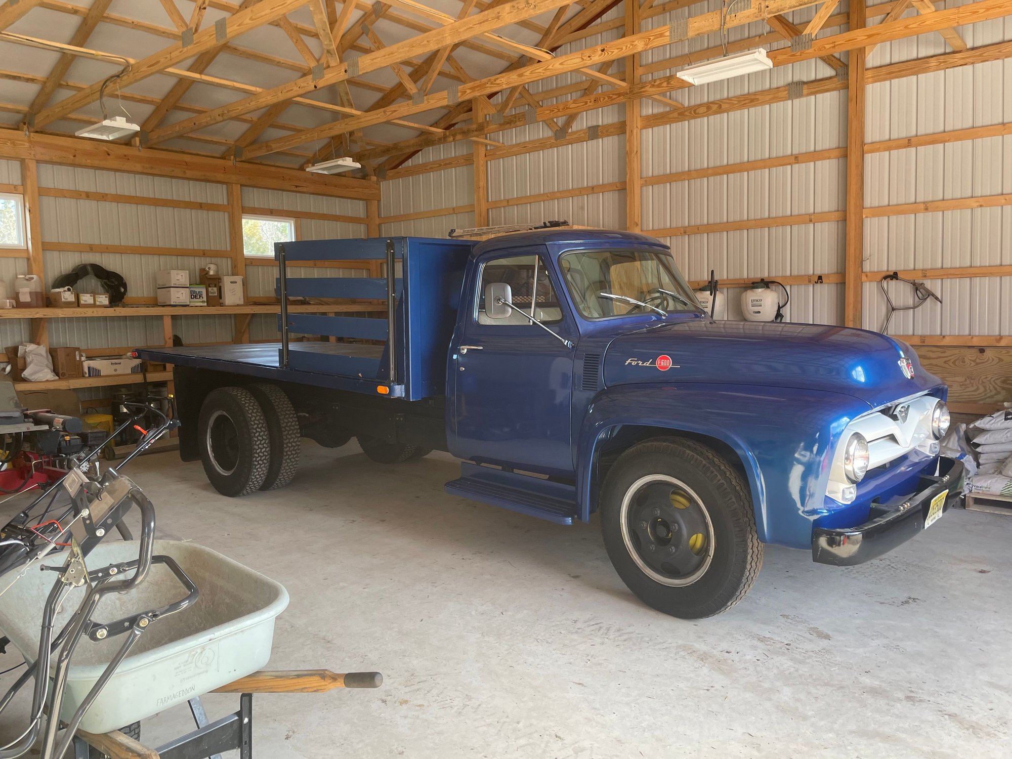

Here’s a picture. The truck has a 292, said to be original.

WOW! That is a beautiful truck!
On my home pc I have some links to converting to 12V. I'm sure our experts here have that as well.
Welcome to FTE! Don't hesitate to ask lots of questions. But you have to post more pictures.

Hey Swampy, welcome to FTE the best Ford truck forum on the World wide Web!
That's a great looking truck. I think I've seen it on eBay. And I love that color blue.
Save yourself the trouble of converting to 12 volt. A good 6 volt system works fine. Both my trucks are 6 volt and I have no issues. But you need new corrosion free thick cables. They should be at 1 gauge or better 00 gauge. You need clean connections at both ends of all your cables. And of course a good 6 volt battery is needed.

Nice looking truck! I've found no need for power steering or 12V in my big trucks. The original systems were engineered well and work well when maintained well. But if you insists....

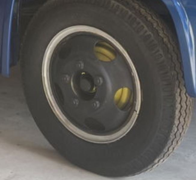

Another thing to check out, are your wheels what we call Widow Makers? If so, they are dangerous. We have some resident experts here that can tell you by looking at the picture. I'm sure they will check in soon.

The rims in the picture do not readily appear to be the dreaded RH-5° widow makers. But yes, something to look out for, especially on a commercial truck.

Wow that's a nice looking truck..... show room condition! How many miles? Post some more pics.
The front ones, at least, are split-ring "safety" wheels.

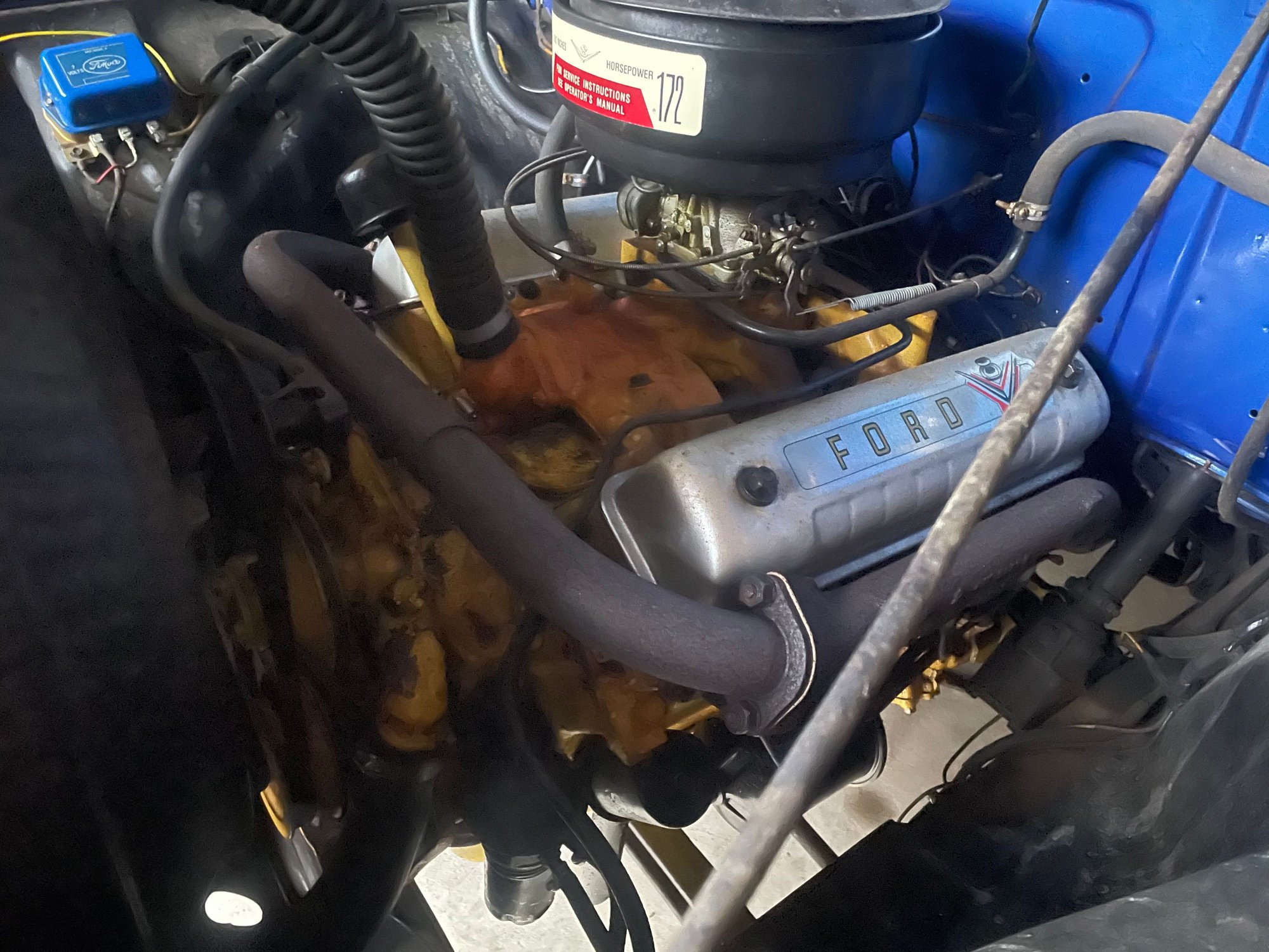

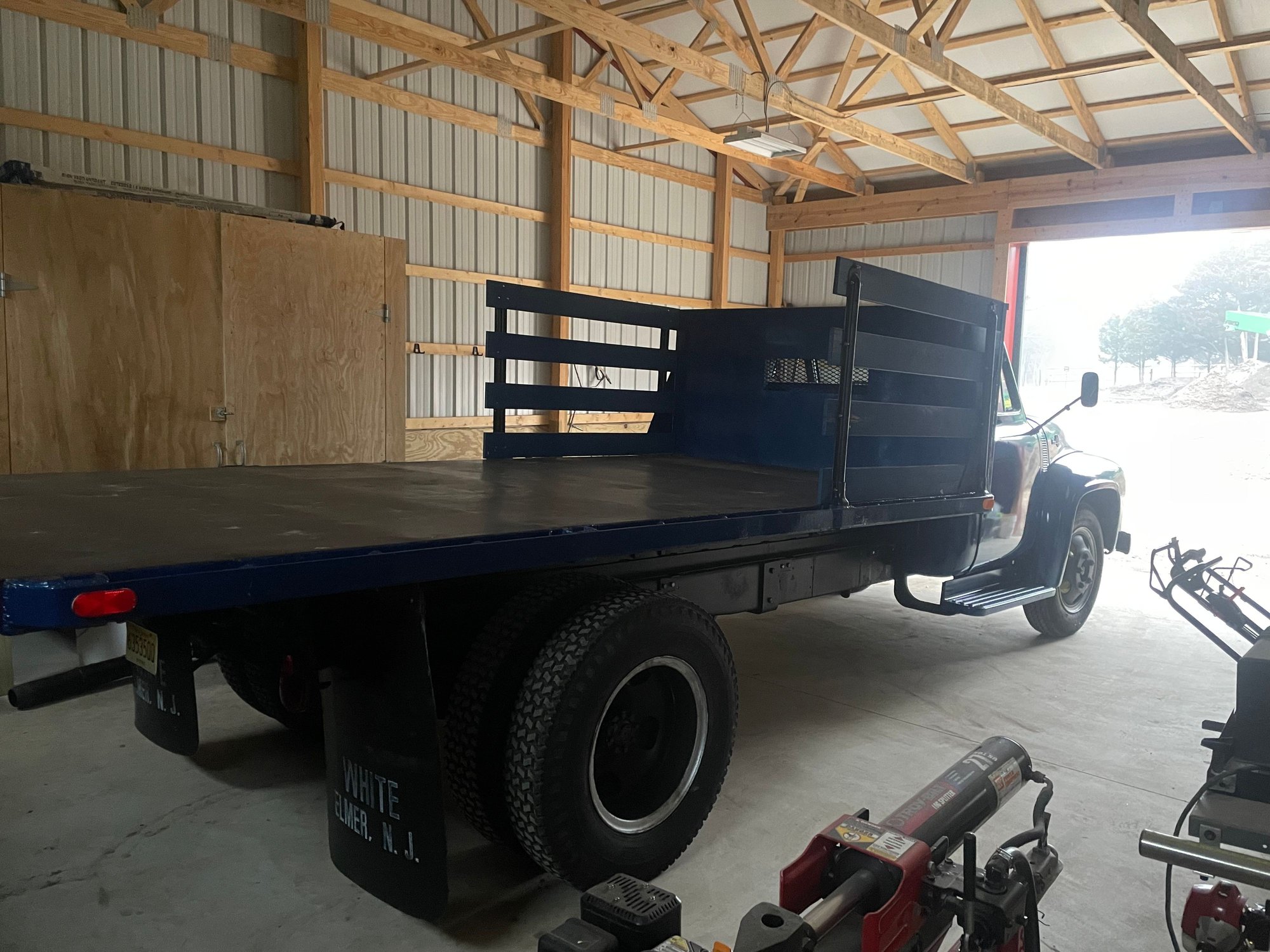

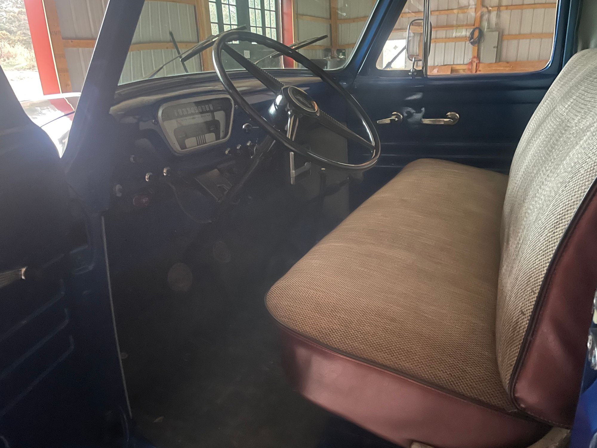

Great advice guys, thank you. Looks like a lot to switch to 12V. I will go with the larger cables. We’re in south Jersey and the truck will be used for light duty work but also possibly an advertisement and for people to take photos with. We do weddings here.
