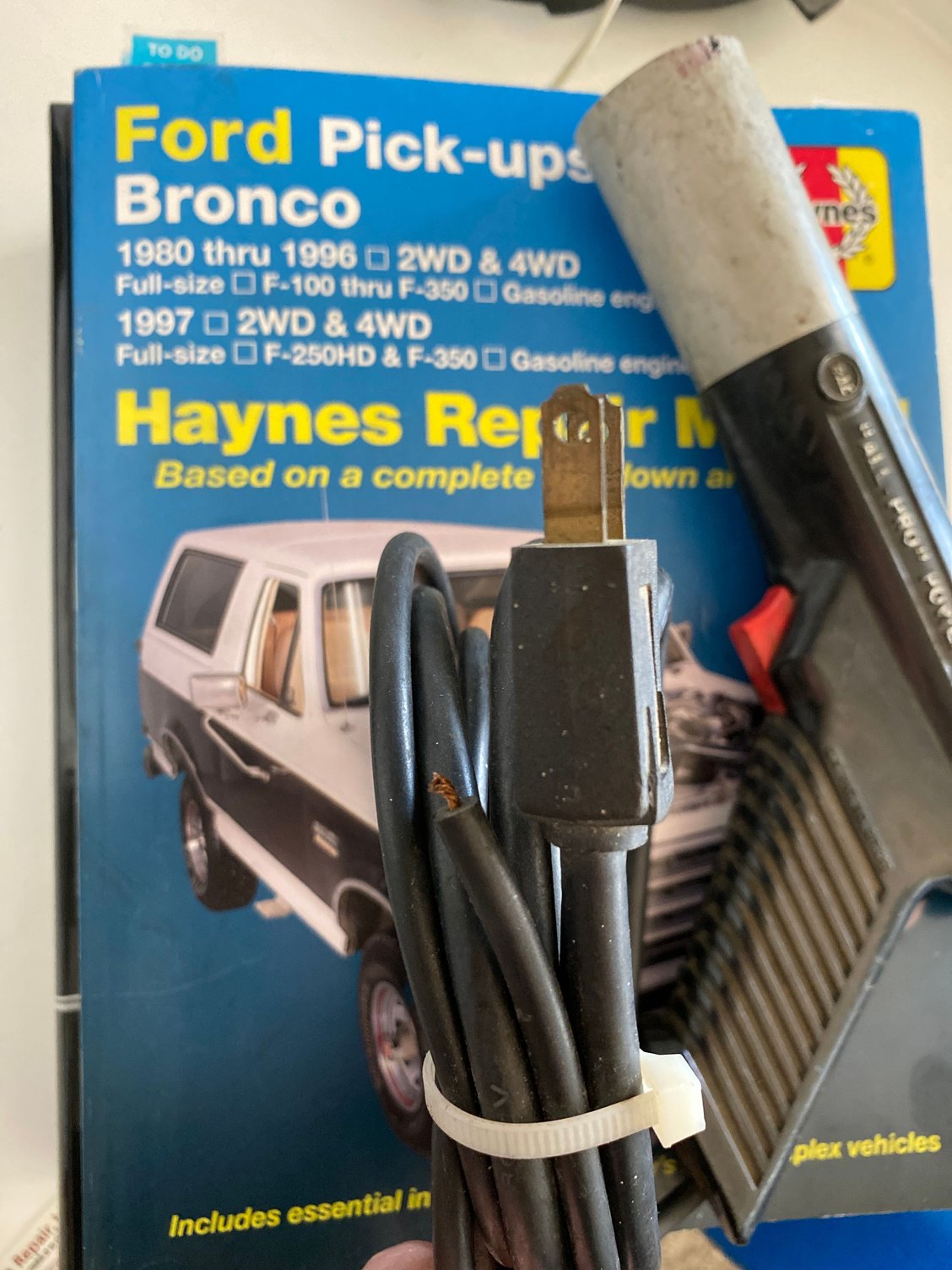

Edit: reading wrong section of manual sorry.
Someone I know mailed me a timing light to use. It has no screen. I’ll upload pic tomorrow. How do I use the ones without the screen? I bet this one’s from the 80s. But I’ll Google some videos I never saw any that looked like the one I’m borrowing. And cylinder #1 is the front passenger?

I am looking at the picture and guessing that is a 120v powered timing light. Yes a paper clip wrapped around #1 plug wire with 1 end shoved into the pick up lead of the timing light may work.

My 1980 vintage timing light uses clip on connectors to the battery and an inline connector that goes between the spark plug wire and the plug. It's ancient but still works.

I have not seen a 120v timing light since I set timing on Noah's Arc. All mine have been 12v powered with induction pickup clamp for the plug wire.

Try not to get the crap shocked out of you using the one you borrowed.
It might work
Tape, or use a clothesline clamp on the wire that is supposed to have a clip
The distributor turns counterclockwise, so to advance it, you turn the distributor clockwise
Line up your pointer to the 10BTDC mark with the spout out
